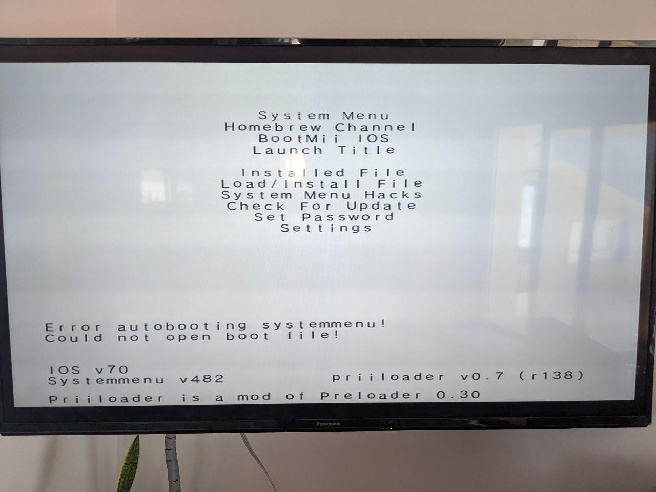

I received from a friend a Nintendo Wii bricked after a failed attempt on cleaning up the console from any modification and then update it. When i launch it all i see is this. Is there any hope? P.s. i'll attach a photo here of the screen i receive on tv.

I checked and there's no sd slot in the wii and he told me he lost it several months ago
Before
My bad, i wanted to say i checked the sd slot and there's no sd card in it

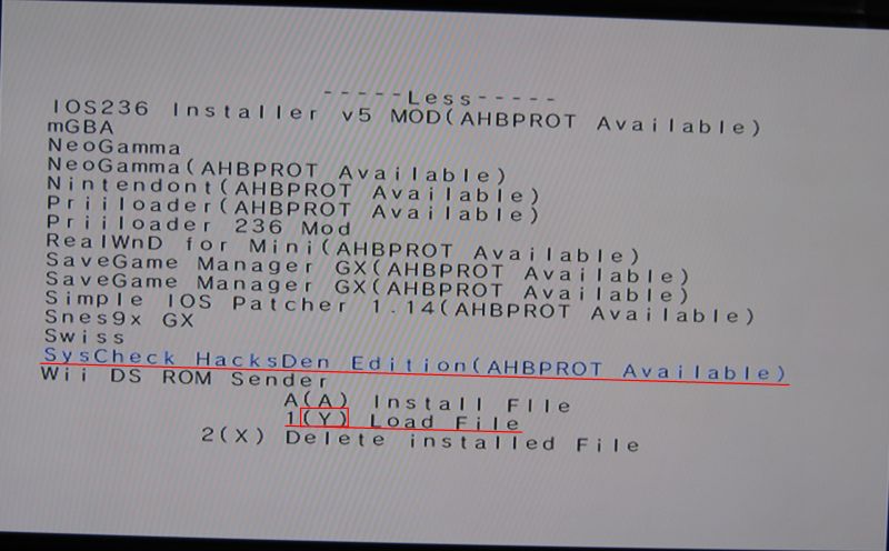

If the Homebrew Channel is unavailable Priiloader can start also start apps from SD: (Sorry, my camera is in a bad mood today)
1. Load/Install File
2. Select SysCheck HacksDen Edition
from the list and press (Y) on GC controller

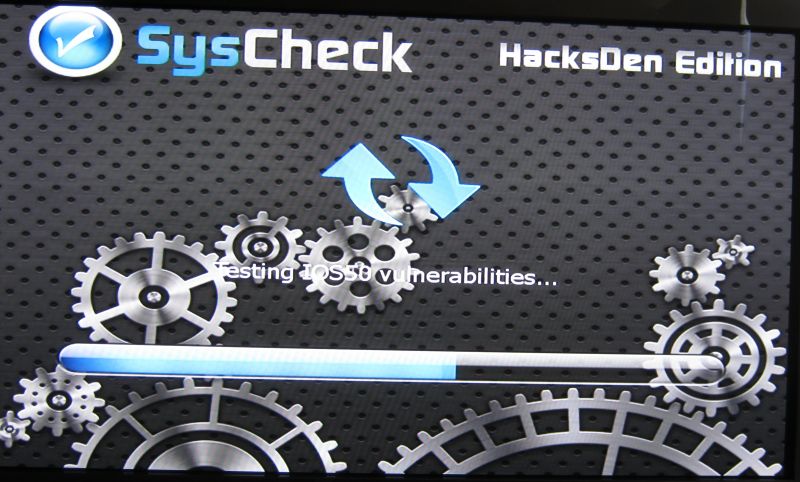

3. Syscheck should load; start the process and it should save the report to SD.
I can't be of further assistance since Wii is not my main topic. Somebody else should be able to interpret SysCheck and suggest the next step(s).

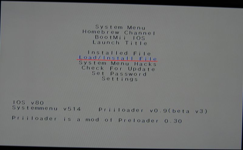

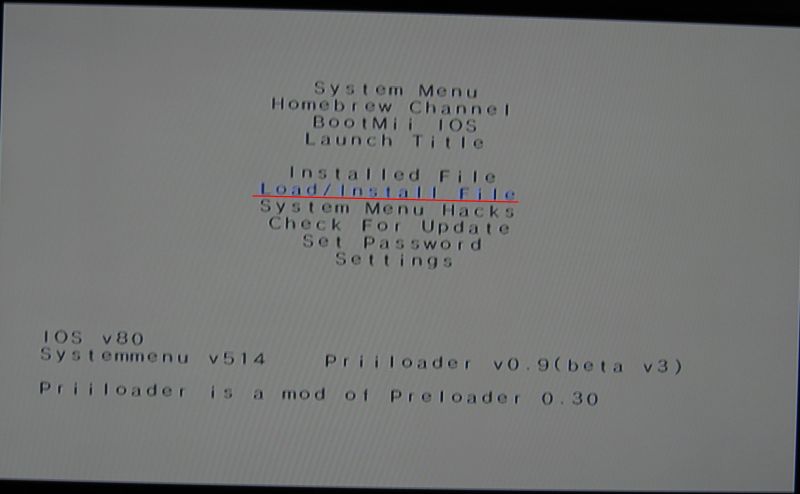

Since yesterday when i was looking for that option i got this screen when i tried to press "load installed files"
oh um.. about that i said earlier that my fried gave me the wii without the sd card, so basically i don't have any of those apps. Is it possible to copy those apps from somewhere?

You can use any FAT32 formatted SD. If the original is gone – use another one. All apps you need can be easily found. For the beginning SysCheck is the only thing you will need on the new SD. You won't need all the apps I have on my test (and ModMii) SD.
I should have removed them altogether before taking the photo.
