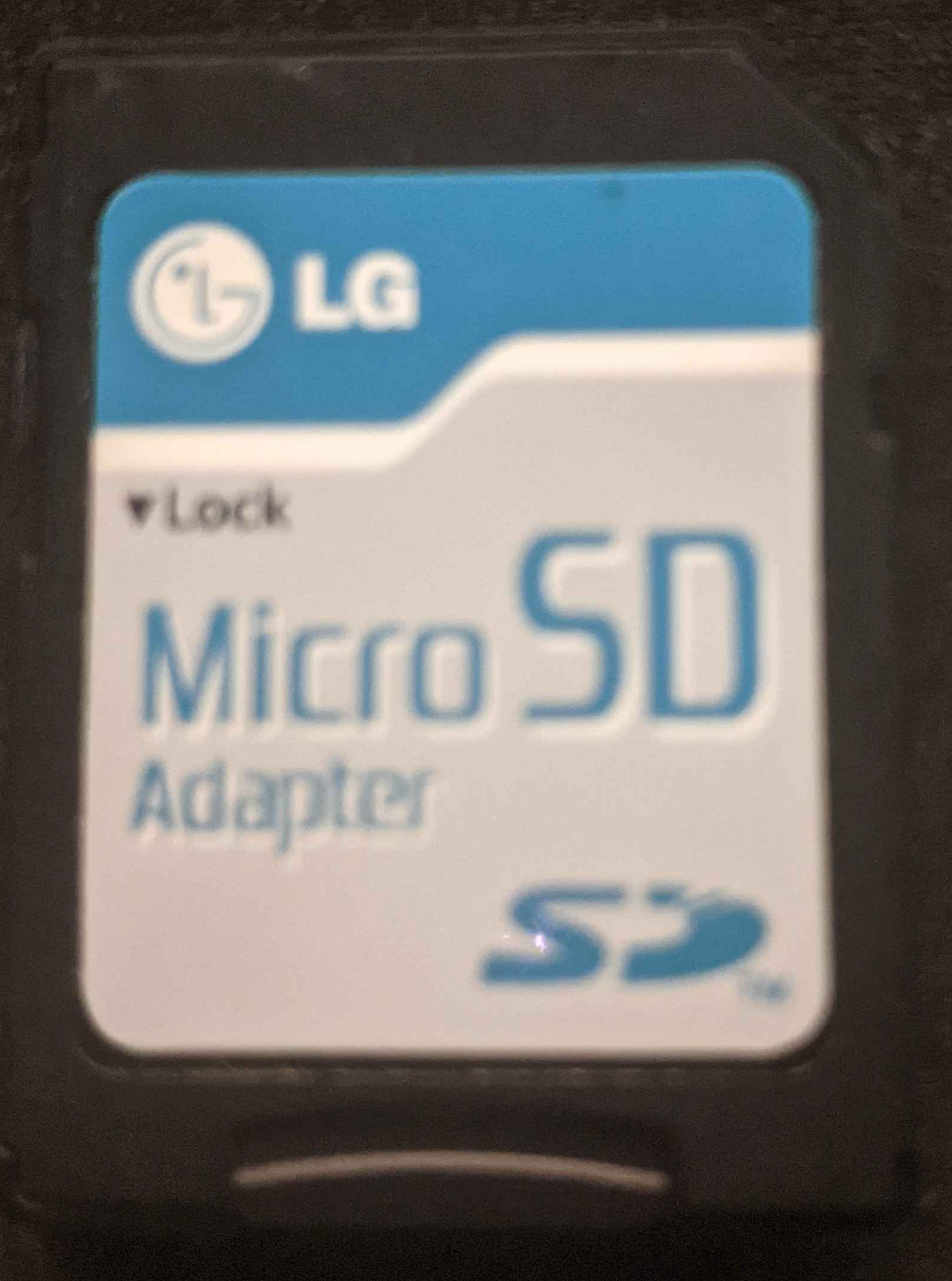

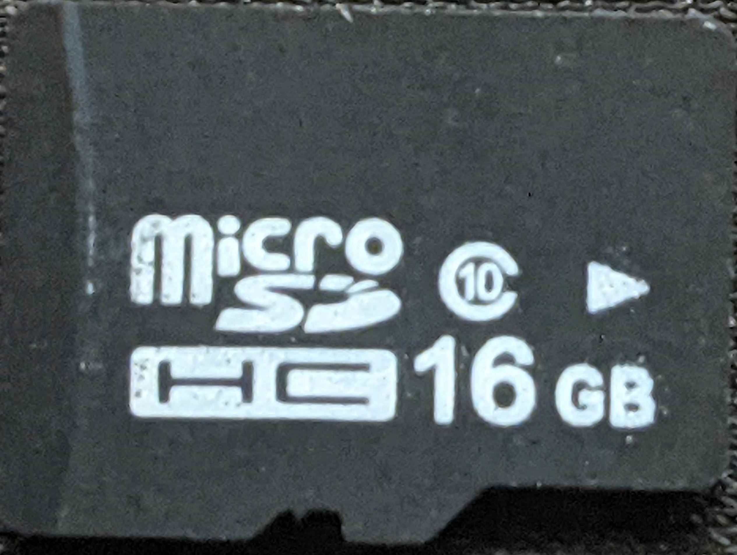

Sounds more like there's an issue with the SD card. Try reformatting the SD card here: https://dsi.cfw.guide/sd-card-setup.html
If the issue persists, please post a picture of the SD card you're using.

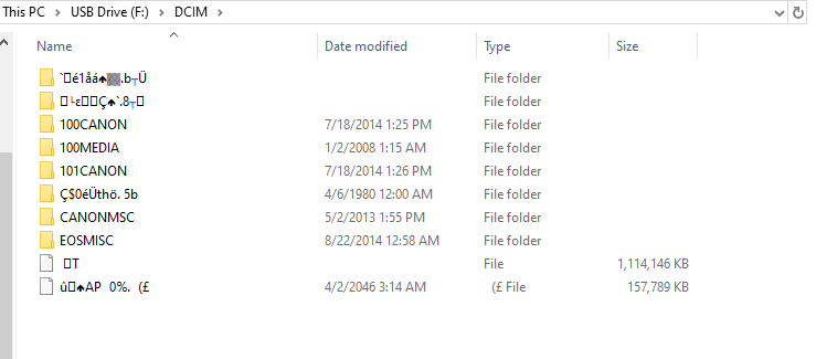

So! I was looking through files when I was copying them over because it wouldn't do them all at once, and found this in the DCIM folder? Do you have any idea what was supposed to be here
Your SD card might be dying. Please get a new SD card.
That's not great! I have no experience installing any of this myself :( . If I'm still trying to make a backup of everything but the DCIM folder, what was it associated with? Is there a way to get a backup for it?
I don't understand your question, but it's likely anything that's on the SD card cannot be recovered.

Yes, RocketRobz is right about your SD card. It is very much a fake 16GB card so you'll need to buy a replacement from a reputable brand. I typically go with either Kingston or SanDisk as they don't let me down and that I've always got the correct capacity.

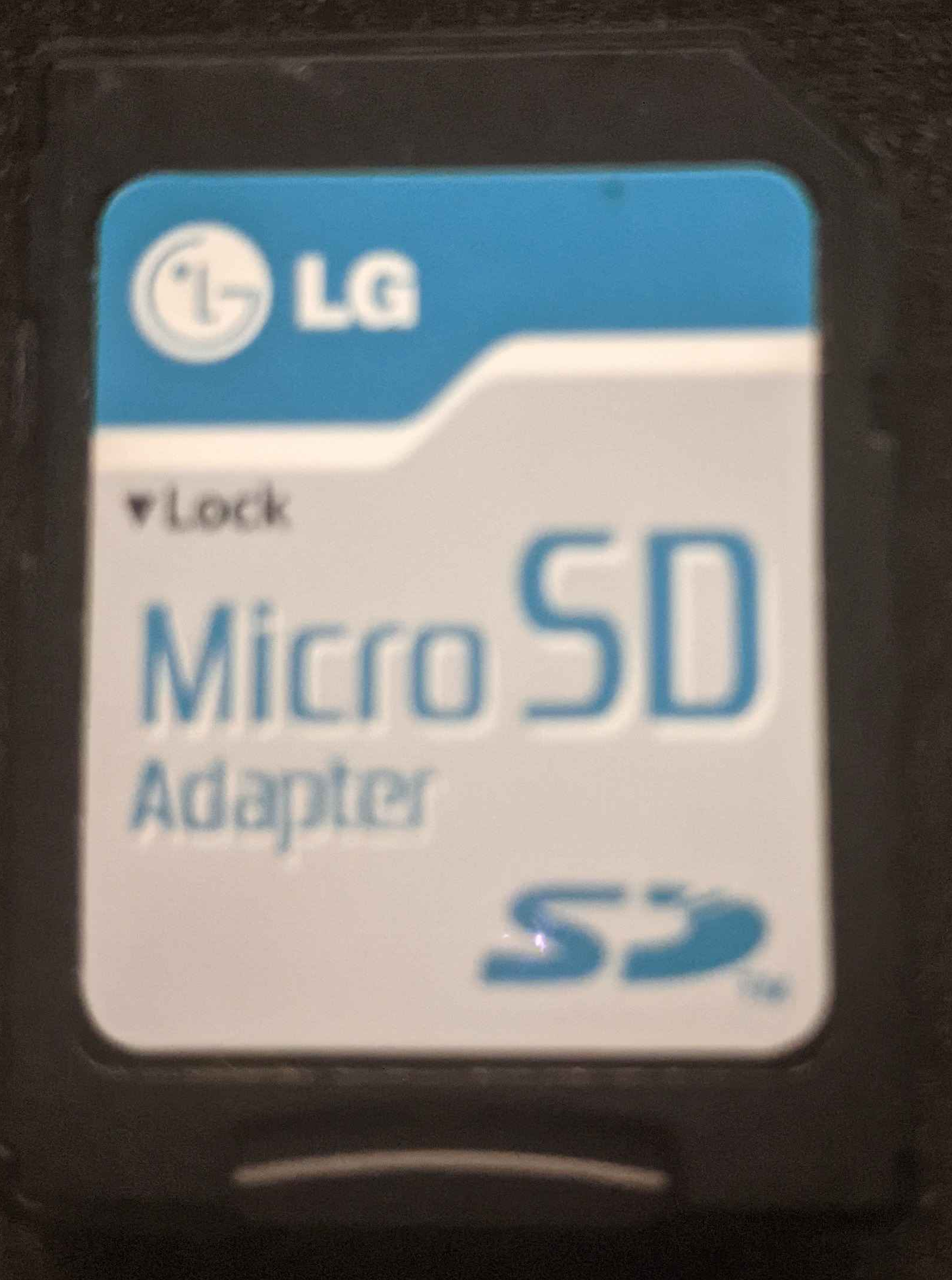

It looks like a 16gb LG card from 2010. Definitely odd if someone needed to spoof that!
yeah... never use these unbranded microsd cards :P they come from online sellers that either get them from low quality assurance factories, or cards that didn't pass quality assurance that get sold without a branding for a quick buck. they never last long
a lot of the time they come with cheap flashcarts you buy online. not that that's the only possible source though
