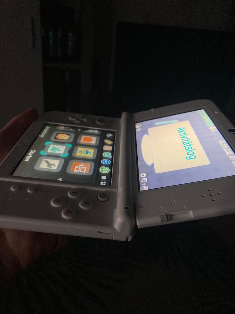

Hey, first of all I hope that this is the right place to post my question. I haven´t found an answer to it somewhere else.
I recently bought a used New 3DS XL and now I heard about that thing with the different screens (IPS and/or TN). So I did saome research because I was curious which screens my 3DS has. I know now that most New 3DS XLs come with TN/TN screen, some with IPS/TN and rarely some versions have IPS/IPS.
Sadly I don´t have a second New 3DS XL to compare the screens and the viewing from the side didn´t give me a clear answer. But I am leaning more towards having a TN screen at the top. Then I found a thread, where someone said that you could find out whether a screen is IPS or not with that test on lagom (sadly I can`t post the link). Apparently you can see the squares 4 and beyond with the TN screen and 7 and beyond with the IPS panel.
The top screen showed no surprises as I could see all the squares from 4 and beyond. So I figured that I have the most common variant (TN top/ TN bottom). But then I viewed the picture on the bottom screen and there I could see the squares 8 and beyond. (I hope the pictures and clear enough, its hard to take them in a pitch black room) I was searching for quiet a while now but I haven´t found any posts to that. Is it possible that my 3DS has a TN top panel but IPS bottom? The serial number of my 3DS is QEF105 if that helps.
Thank you alot in advance :)

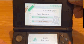

It would not make sense a TN upper and better IPS lower one. Else it was a IPS/IPS and the top one is replaced.
Yes use 3dsident it will show allavailable information, also if TN or IPS.
For example a IPS vs TN screen
IPS stays sharp with all colors
TN looses sharpnes, contrast and its colors. U see this in the TNgif.

@Sypherone Yes, that is why I was confused aswell. I bought it of some women who barely used the console. So I don`t think that the screen got replaced (although I don´t know that for sure)
But even if you look from the side, the lower screen seems to have better viewing angles than the top one (compared to the picture u linked, where the top screen is definitely better). The colors are much more vibrant one the lower screen, you can stll see the black background where the upper screen already turns grey
I don´t have any experience with 3dsident but you have to install some form of CFW on the system to use it right? I´d rather keep my system stock

Thats strange its really looks that u have upper TN and lower IPS screen. I have no conclusion then its replaced.

Screen types came in all kinds of variations in N3DSXL's. That means it can be a IPS top TN bottom, IPS/IPS, TN/IPS or TN/TN.
Yours from the pic above appears to be TN top & IPS bottom.
