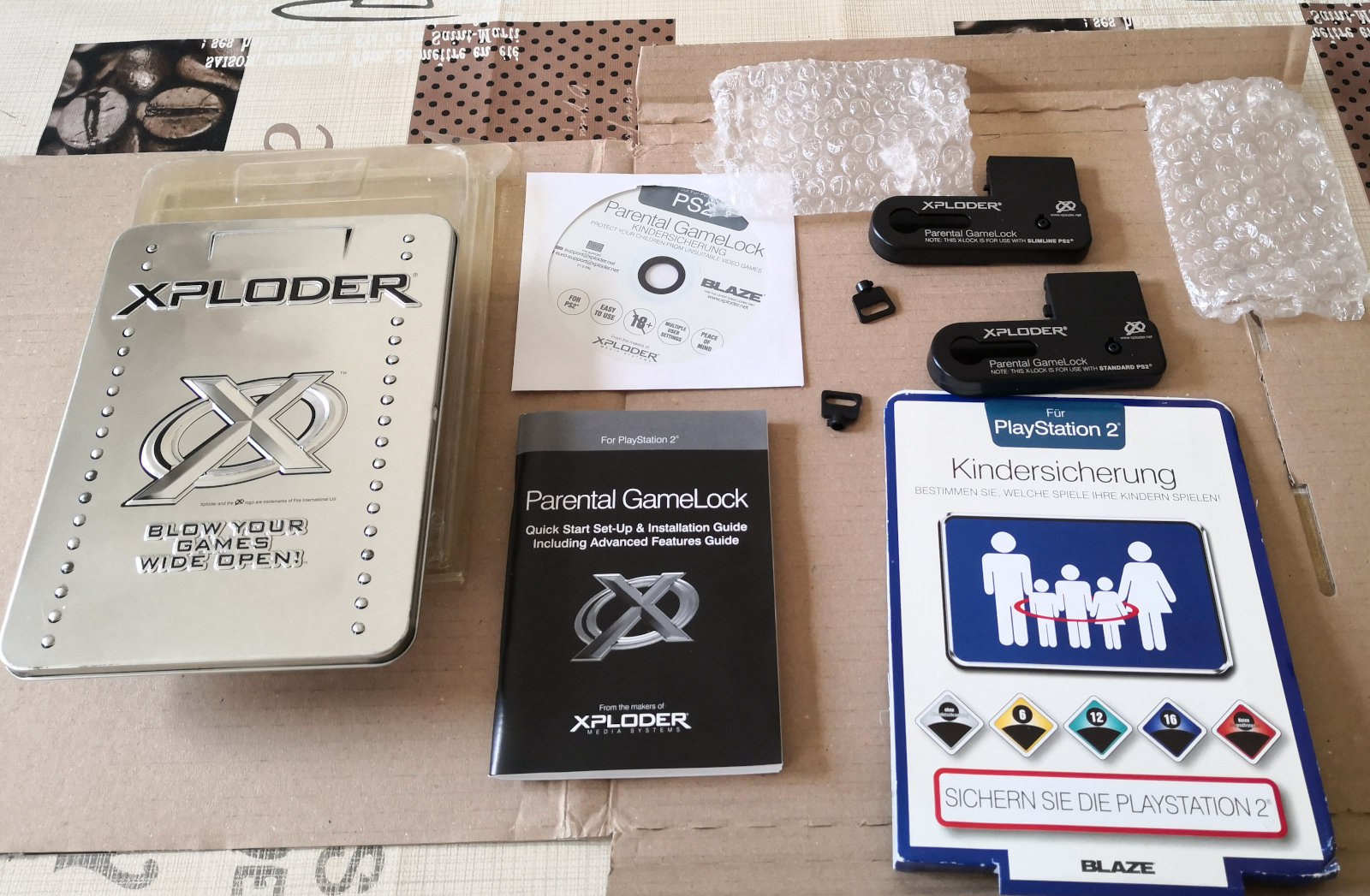

They produced all sorts of funny things for disc based consoles – like a media player for the PS2.
ps2_parentalcontrol-jpg.394875
But in the end that is nothing we can do at home or ask any CD/DVD replicator to do for us.
