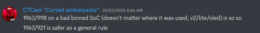

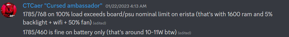

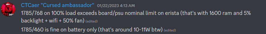

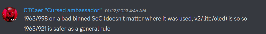

And board limit is 18W on v1. This is from the guy who makes hekate and did hardware research.
This is for v2
There might be a difference between them but for the sake of this discussion the difference is irrelevant. They pretty much mean the same thing.
Thats what i mean, so its the same thing, alright! Hey, thanks!
This is for v2
Thanks a lot!!
