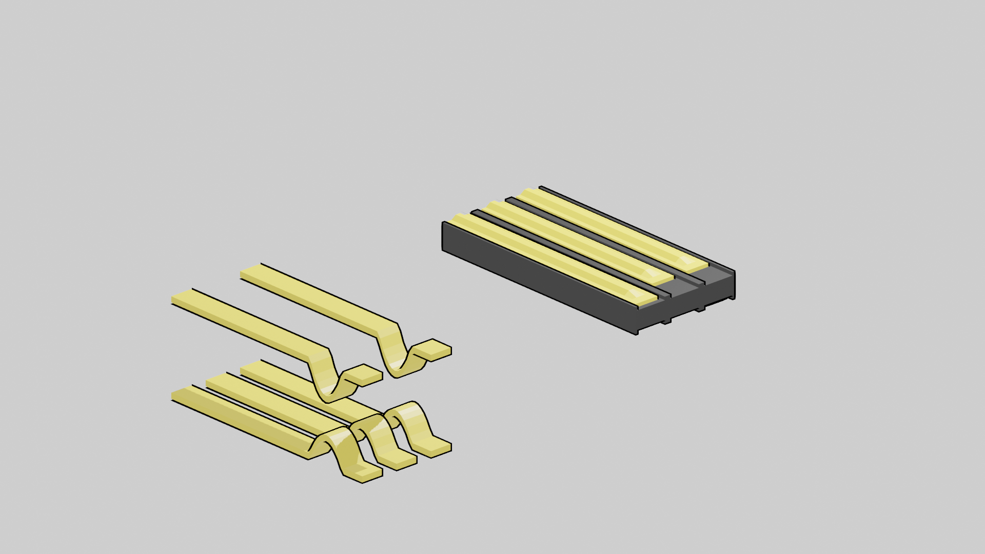

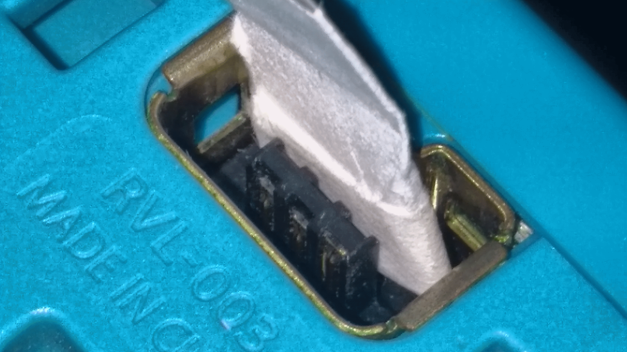

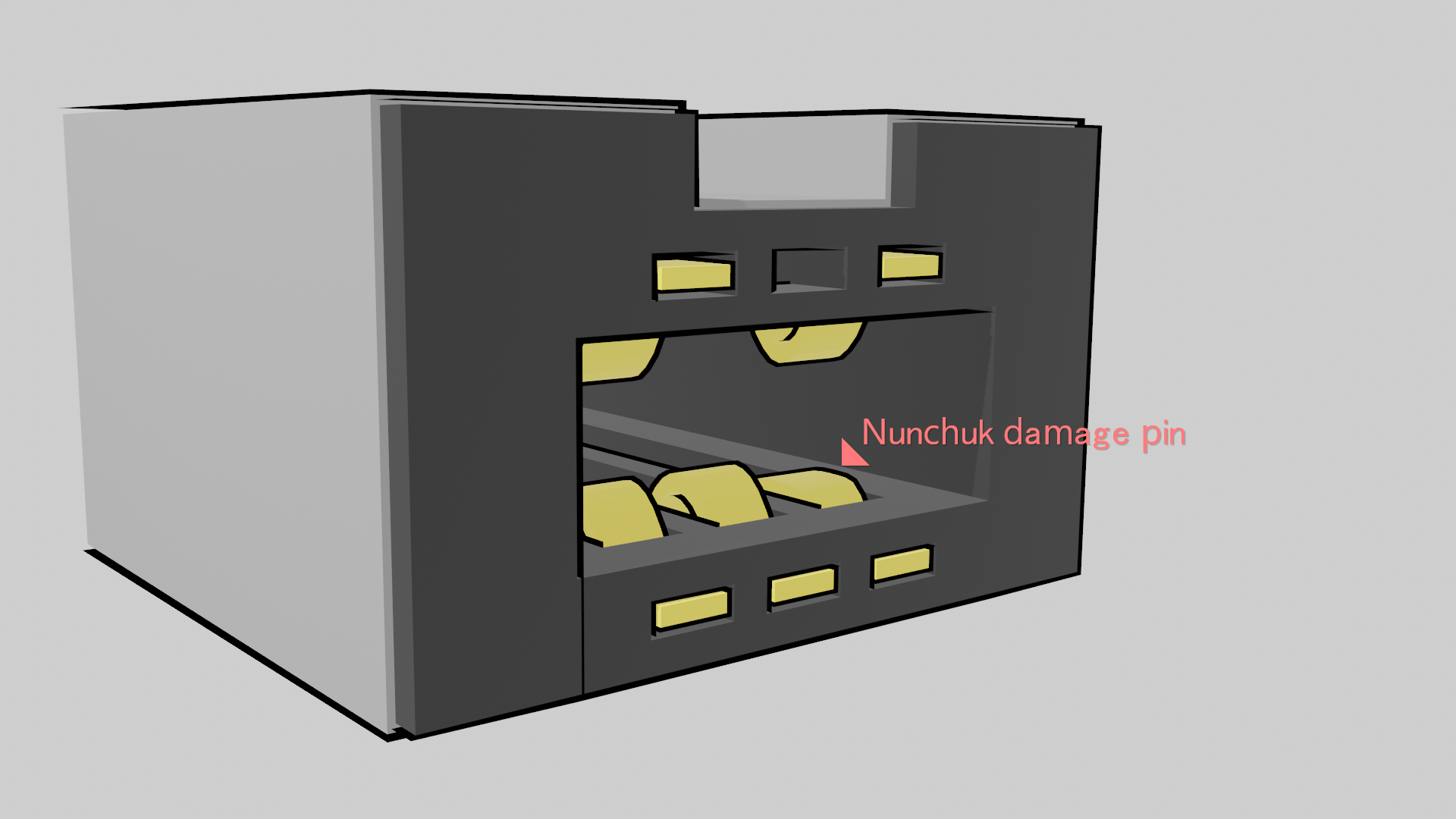

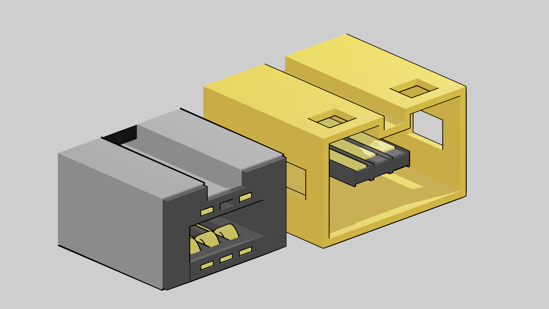

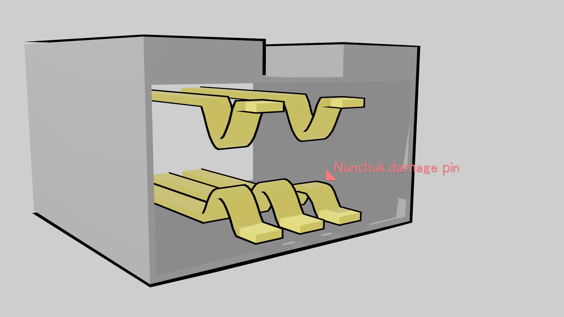

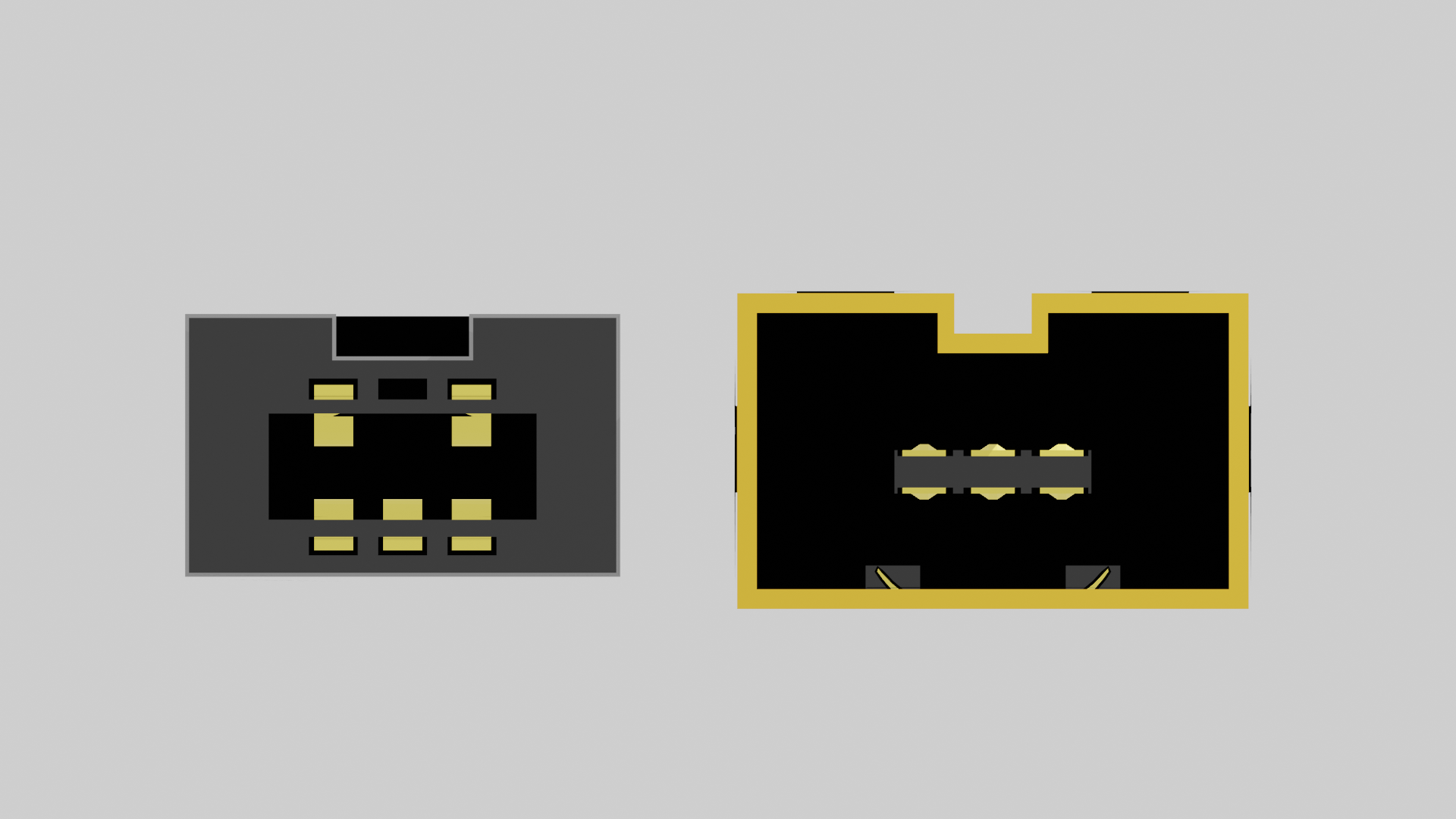

Check the female/male ports.
I previously have a connection problems with my Classic and Nunchuk controllers, I clean the ports with a semi-hard piece of paper with a bit of isopropyl alcohol and a lot of care, later the Classic controller began to work properly. For the Nunchuk, I notice that one of the copper pin were down, so I used a pin with a bent head to hock it and pulled up gentle. I will leave this images as reference>>
A lot of care with the female port, the plastic part in the middle can break or bent easy with a little presure, so don't insert a thick object to clean it, do it with something that can enter and pull out easy.
