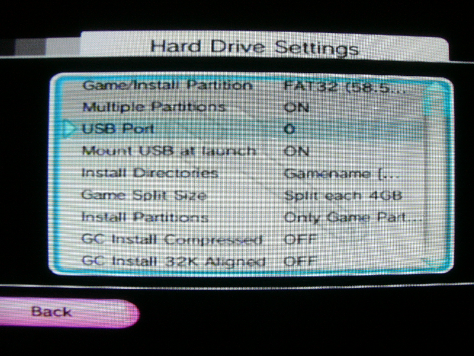

Please be so kind and check the following:
- USBLoader GX Version (it should be v3.0 r1272)
- WiiFlow (it should be v5.2.0)
- What Kind/Type is your USB Device please ? I see in your Post you use an HDD.
Recommended is the HDD formatted with FAT32.
USB Sticks/Flash Drives/Pen Drives are known as not 100 percent reliable and maybe not working correctly.

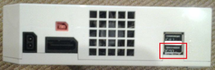

- Your USB Device is plugged in the correct Port 0:
- Your Games are transferred with the WiiBackupManager from the PC to your USB Device.
Please be so kind and check all of this Points.:)

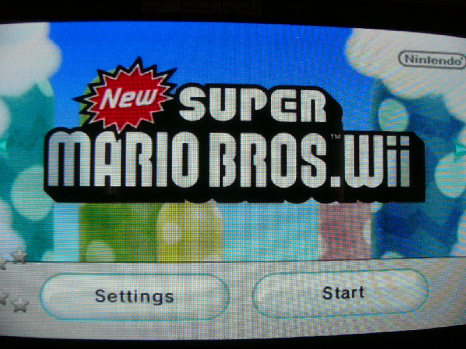

I’ve only tried Super Mario Bros to be honest. Would you recommend me to switch to FAT32? Could that maybe change something?

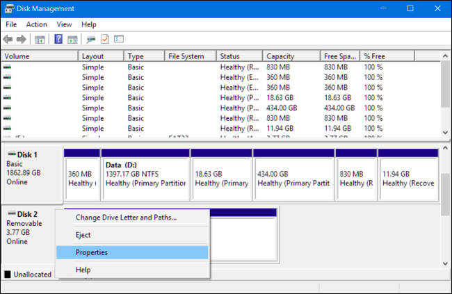

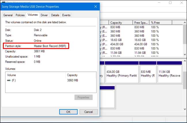

Okay so I've just tried again. I've partitioned one part of my drive to FAT32 and the other to NTFS but regardless it comes up and it doesn't work. Is there anything else I could do? For the moment I'm going to try another game and figure out if it's an issue with the file.
Reactions: Alexander1970

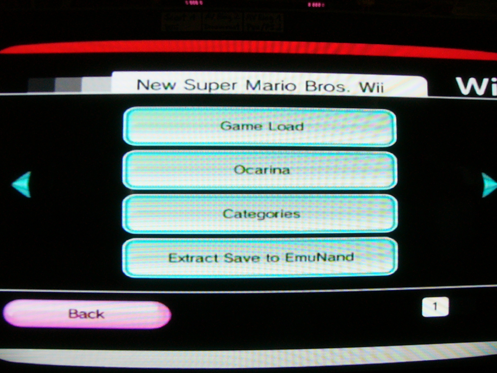

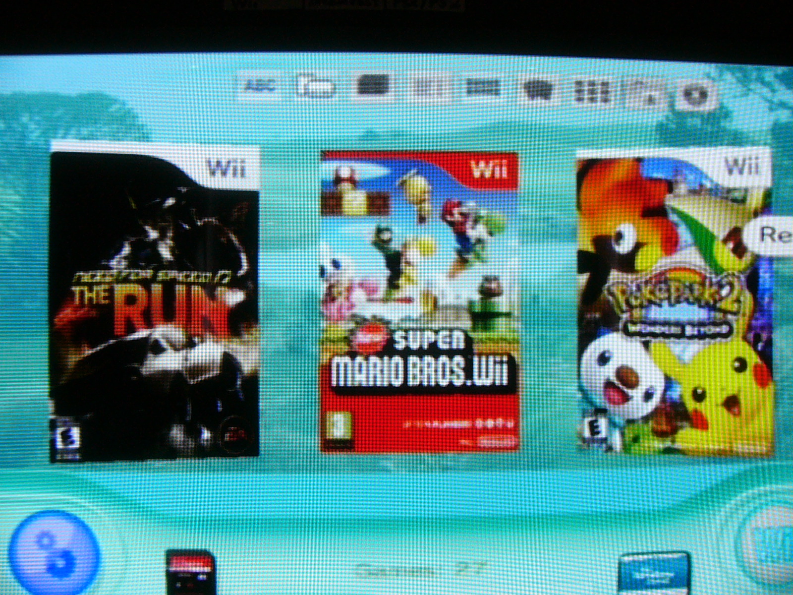

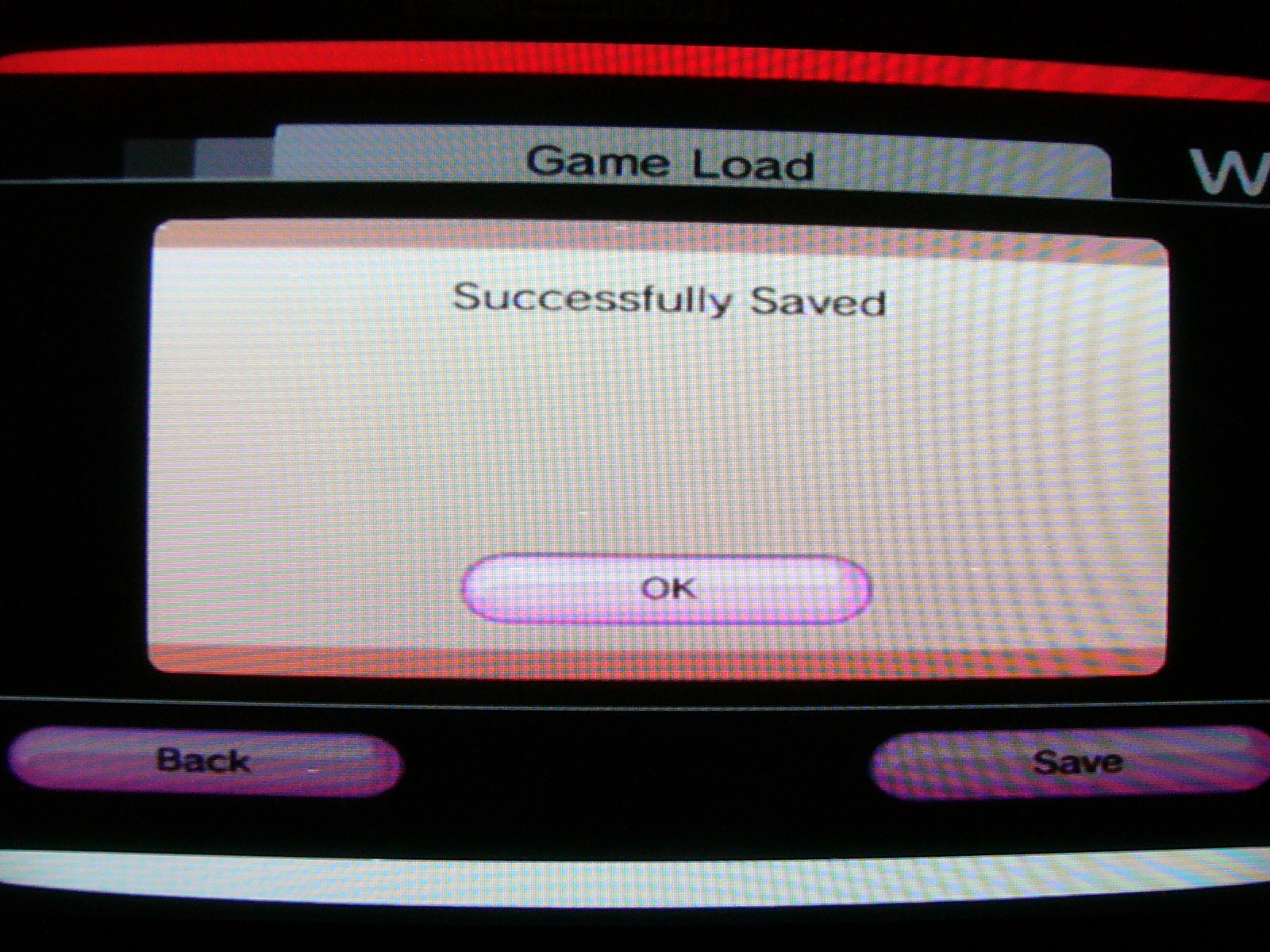

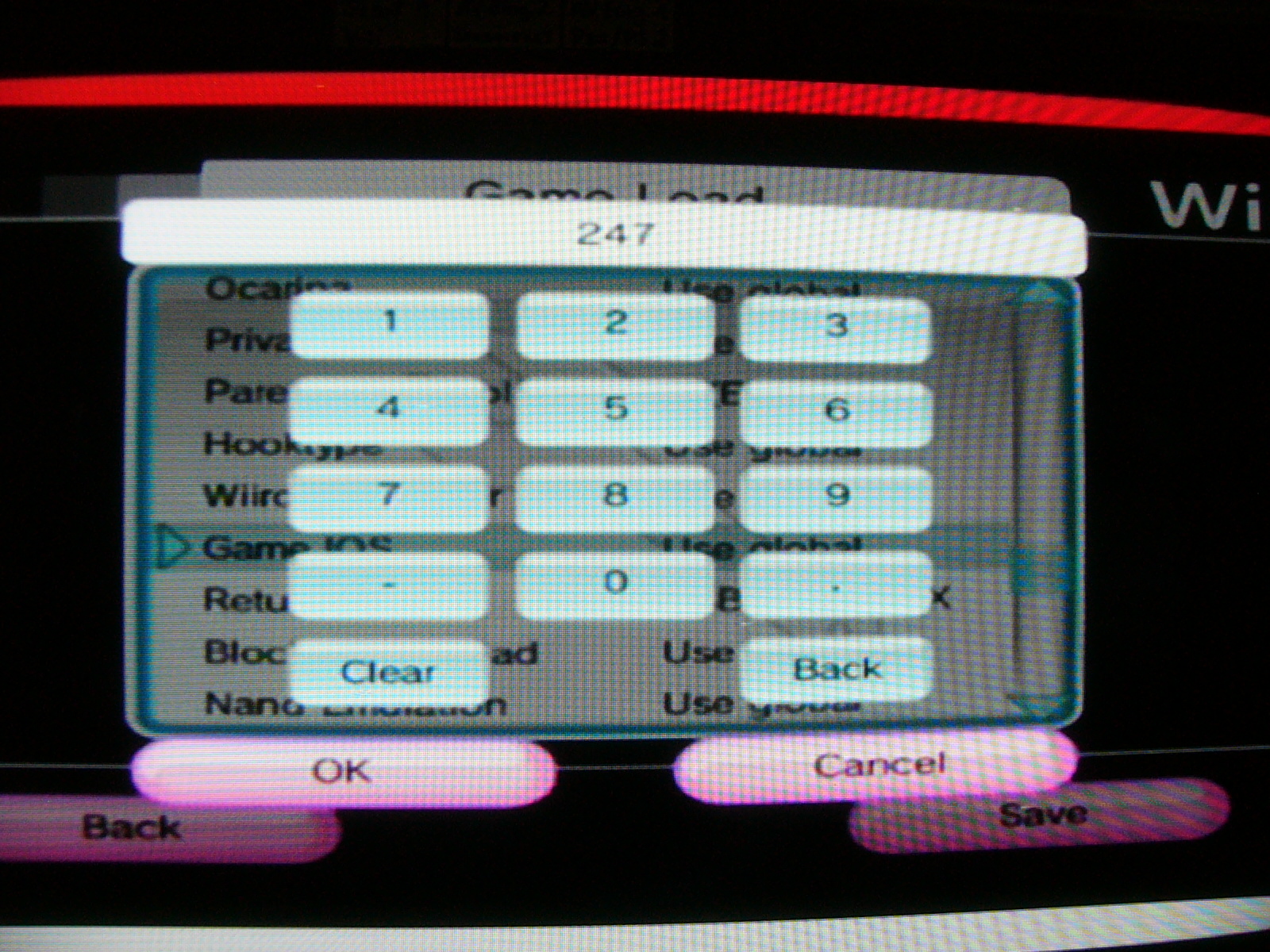

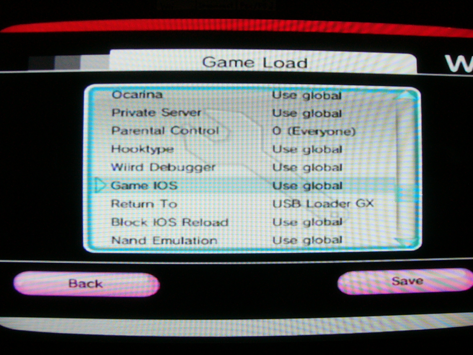

I have tried PAL and NTSC Version on NTFS HDD and FAT32 USB Stick,both work on Global Settings in USBLoader GX.
In WiiFlow v.5.2.0 on Standard Settings.
In Configurable USB Loader v70 r78.11 (it uses IOS 247 on the startup)
And yes please,try other too Games.
Thank you.:)

One thing please to check before you proceed: please be sure your HDD is recognized as MBR and not as GPT Drive in Windows.
img_56e628d28bd5b.png.pagespeed.ce.QTfQCBsn-5.png img_56e6297886fee.png.pagespeed.ce.OAzLplkJBg.png
For the Hard Drive Settings:
The Setting "Sync FAT32 FS Info" can be confirmed with YES.
Thank you.:)
View attachment 181341 View attachment 181342

Can you please try to change the Game IOS for New Super Mario Bros. to 247 and start the Game ?
Thank you.:)

On USBLoader Gx Menu please choose the Game:
-choose SETTINGS
-then choose the Option "Game Load"
-scroll down to "Game IOS"
-change it to 247
-choose Save !!
-finaly please choose Back and Done.:yaywii:
Thank you.:)

so,,,,,,,, I tried to do it? and I got put in a "channel" menu and I have no clue how to get out of it. It accidentally booted up when I tried to open usb loader gx without the hdd plugged in. How do I fix this? or should I try wiiflow
