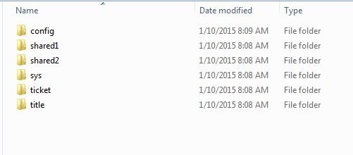

Check this out. This is EVERYTHING I have on the drive right now. And you can see the used space as well.
There's something obviously wrong in there...
*EDIT* Something I just noticed as well. The name of the drive USED to be WII. And now, as you can see it's "Local Disk".
It would APPEAR to have been formatted but how come the files are still occupying the space?

if you put the hdd on wii and use wiixplorer, it's the same result?

I don't know how it could have been formated.
The only format function inside the loader is a WBFS partition formater, not a FAT32 formater.
It would mean that it actually formated it silently without crashing, and selecting correct settings (FAT32, cluster size, etc.) due to a memory bug issue?
I find it very unlikely, but I really don't understand what happened, sorry.
There's also no partition table editor (except WBFS formater), so the loader couldn't change the partition size, location, name, etc. without formating it fully to wbfs.

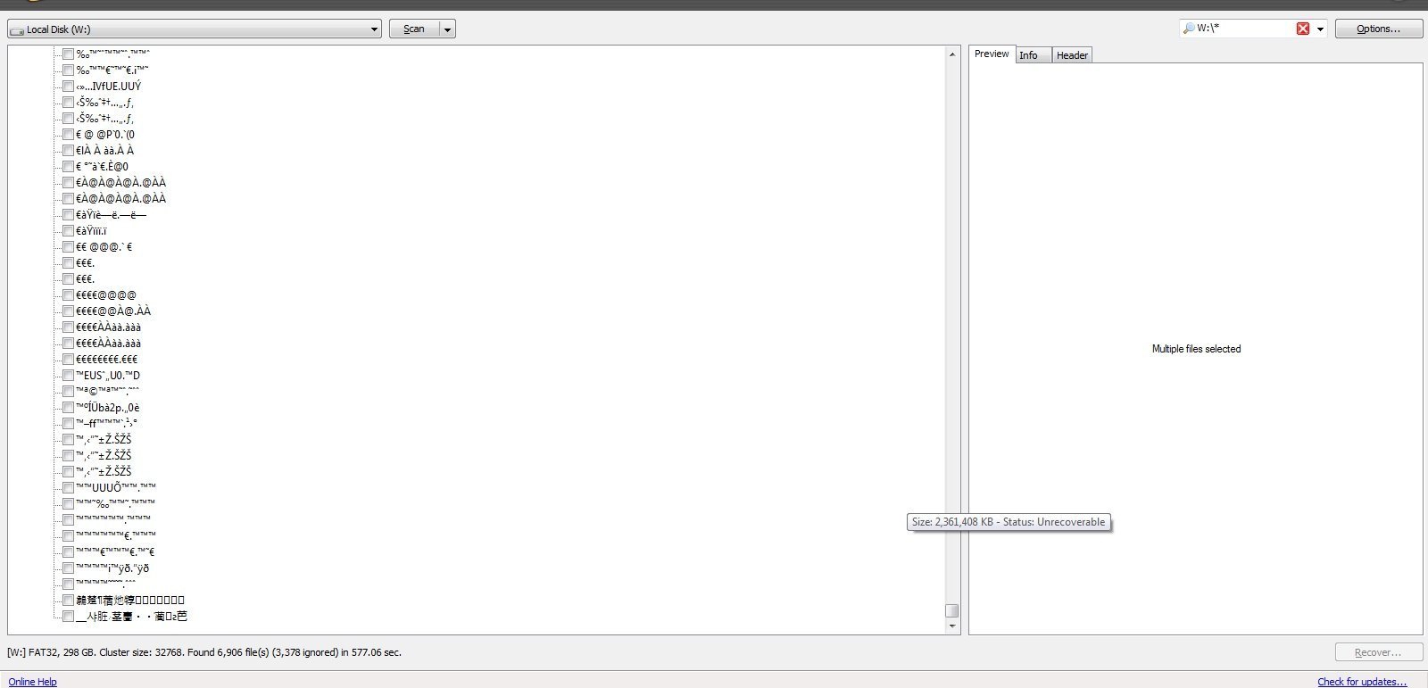

Well, I haven't tried wiixplorer yet. But recuva (recovering software) shows me this after running a deep scan: (attached image)
Which would indicate corruption.
Thing is, how did it happen? There was no error or nothing. Everything just "disappeared" after trying to install the wad...

Sorry, I think there's no way to recover these files.
Usually, you see these filenames on your drive. it's the first time I don't see at least one corrupted name.
I don't know what corrupted the drive, it could be an issue with the FatLib (if there's a memory issue with my compiled version), or just your HDD which didn't write the content correctly or completed it correctly before you shutdown/power off.
But seeing the recent reports about weird memory/settings issues, there's a chance it's a fatlib issue and I'm really sorry :(
I just don't know how to fix it or prevent it as I don't have the issue myself.

There's probably a way to recover your files, the data is not corrupted, only the partition table.
But I don't know any program to copy files one by one (it won't have correct names so it's hard to find which file is what)
For games it will be easy (hexedit and you will see the GameID in the 4 first bytes), or place files in folder and use WBackupManager to analyze the file.
For roms, using ROM renamers etc. (that will be hard and long to do)
