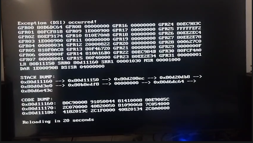

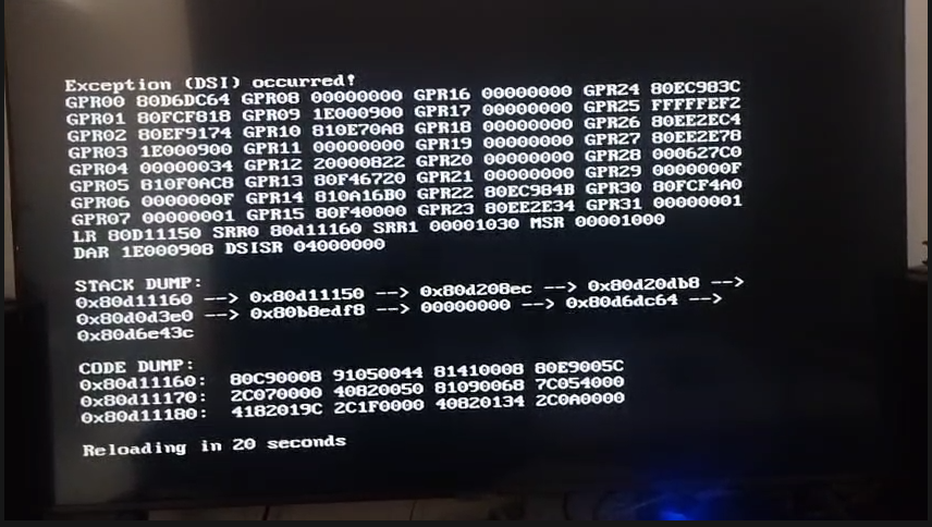

I'm almost positive that it only crashes if I use the banners menu.
The problem there is that I didn't change any banner code in any meaningful ways. And it'd be a widespread issue if it was buggy.
While using the new test build please try to get a picture of the crash.

I tried the regular r1283 again and can confirm that it only crashes if I change to the banner menu. I'll get a pic of the crash.

I was able to get into USB Loader GX without plugging in the HDD. Then, I initialized the HDD through the settings in version 1281 and it worked. But I had to redo the process every time I wanted to launch the loader. However, after updating to v1283, that method no longer works... Do you have any idea on this?
Its caused by the enclosure WD blue drives have always worked for me.
By the way, which enclosure are you using? I've ordered an Orico 2139U3, but I'm still skeptical about the auto-sleep feature.
That's going to be a problem, since the crash happens in libogc, with nothing tracing back to the loader.
Do you have any custom Wii games on your drive? If you do then I'd start by removing them to see if it fixes the issue.
If that doesn't work, I'd suggest renaming your current wbfs folder, then creating a new one, moving a few games over at a time and then trying the loader. And if you do it in alphabetical order, it will be easier to roll back changes once the crashes start again.

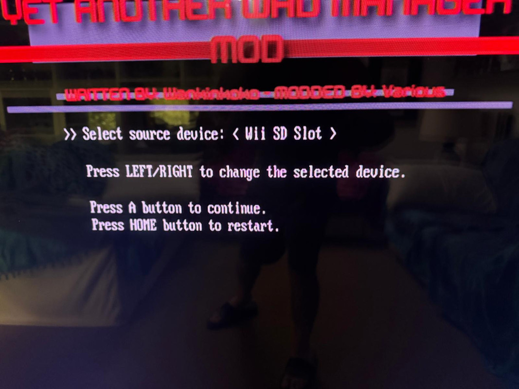

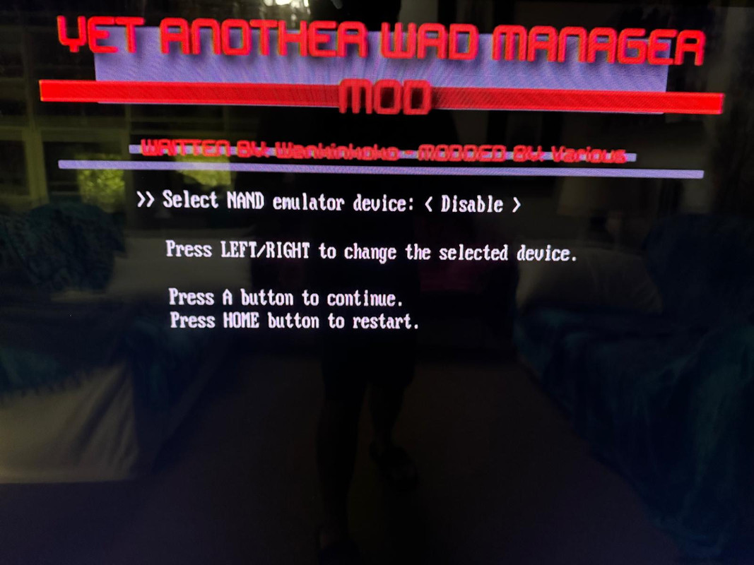

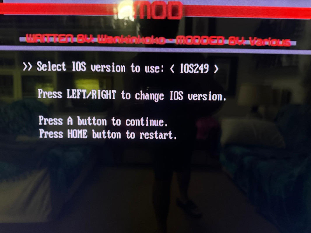

Well, running YAWMM, the first screen i see is this
You'd be better off using YAWM-ME.
But yeah, them settings would work.
It sounds like your USB enclosure has a buggy controller, so when the cIOS attempts to perform a read for the first time it'll return something unexpected.
With the drive disconnected, go into Loader Settings and set Loaders IOS to 250, 251, or 58. Then exit the app, reconnect your USB drive, and try it out.
My suggestion might help, but some games might not boot correctly with automatic cIOS selection enabled due to your buggy controller. And using IOS 58 might cause issues if you let the loader idle and your drive goes to sleep.
Any cheap enclosure with a JMS578 chipset is guaranteed to work with the cIOS, and I believe the Orico 2139U3 you've ordered uses that exact chipset.
EDIT: Orico changes the chipsets used in their enclosures over time. So if you order a 2139U3, it might not come with the JMS578 chipset.
Maybe look on AliExpress or Amazon for something that specifically says it uses the JMS578 chipset, or just take a gamble on something else.
thanks so much for your help! i'll wait for my package to arrive and test it

Go into Loader Settings, select Return To and see if UNEO is listed there.
