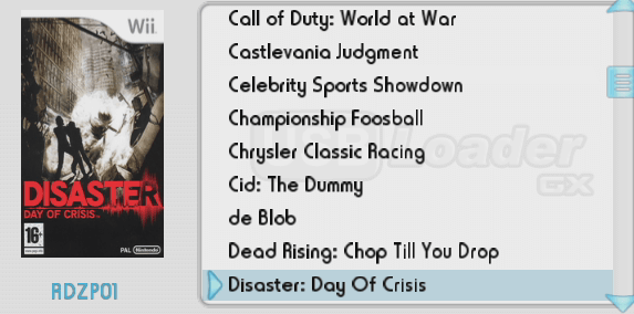

You can also change game name under usbloadergx:
In usbloadergx settings>loader settings> Turn OFF quick boot option.
change game view to list mode, like this (it can be any other than channel sysmenu like):
Click the game once.
There's suposed to appear a disc spinning with the game name above it.
Click the name of the game, then edit.

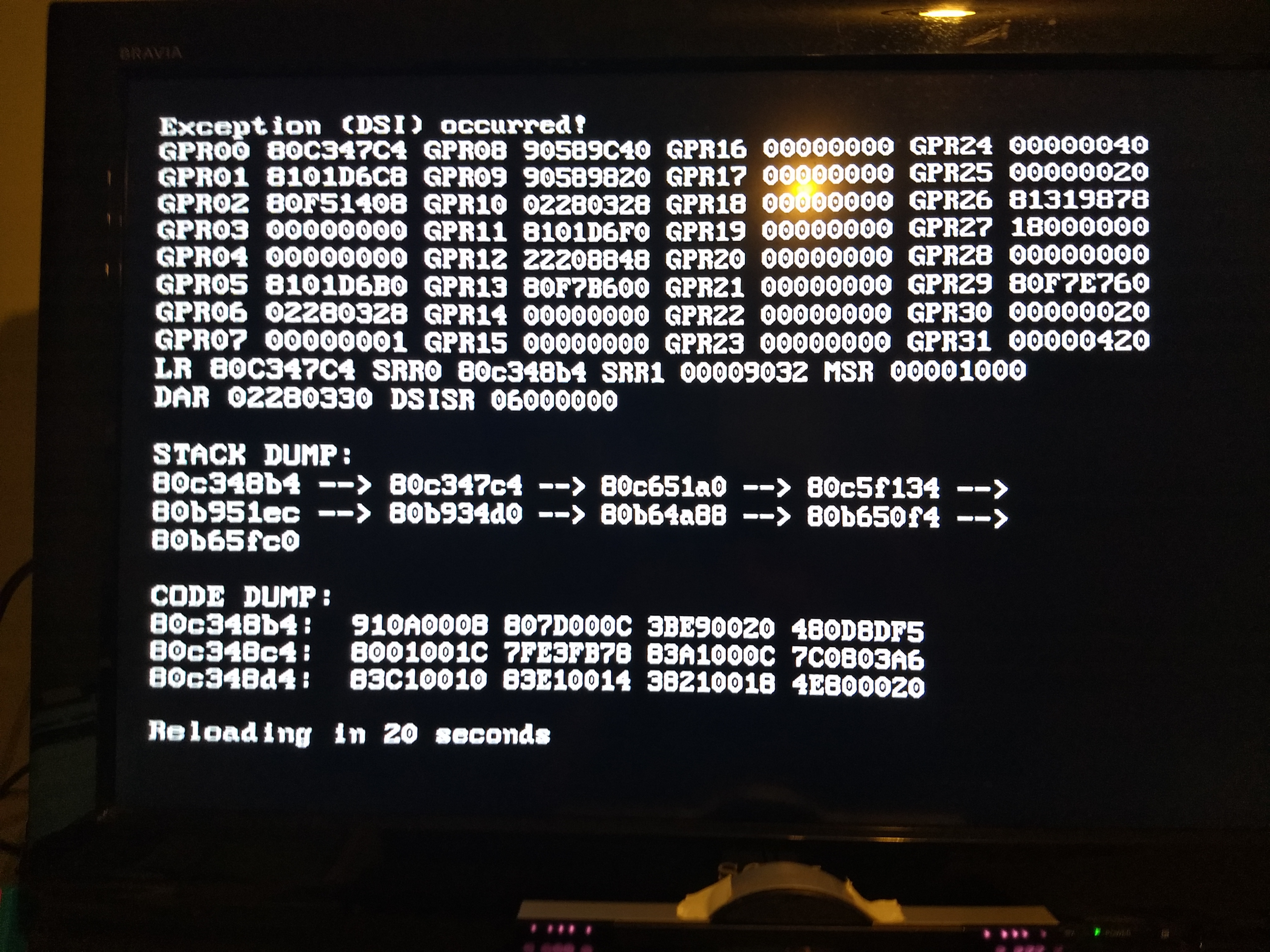

I got a crash report when USBLoaderGX tries to mount my WD Passport drive, could anyone figure out what its saying, and if there's a way I can still use my drive? I updated all my homebrew software/apps on 10/4/2020, and tried using a USB power split cable so it's not drawing all the power from one USB slot.
The drive I am using is: [https://shop.westerndigital.com/pro...wd-my-passport-usb-3-0-hdd#WDBPKJ0050BBK-WESN]. It's NOT listed on the USB Devices Compatibility List [https://wiki.gbatemp.net/wiki/USB_Devices_Compatibility_List]
5 TB WD My Passport HDD
Product # WDBPKJ0050BBK-WESN
Vendor ID 1058
Product ID 2627
Thanks! Let me know if I posted this question in the wrong forum.

Hello,
The wii tolerates up to 2 TB for the partition of your external hard drive.
If you have a 5TB external hard drive, try partitioning it like this:
1st partition 2TB (wii games, Gamecube) << === FAT 32
2nd partition 3 TB (other files) <<< === the format that suits you.
Can you post a syscheck report by following this guide, please ==>https://gbatemp.net/threads/posting-a-system-check.300279/

You could also follow the instructions below in my signature to make the drive one 5TB MBR FAT32 partition.
Not sure if you can get the whole 5TB drive as 32k clusters or if you'll need to go up to 64k clusters. With my larger 8TB & 10TB drives 64k & 256 cluster sizes has not been an issue, the key is to take it from GPT to MBR and then Format to FAT32. I have also bought a similar 5TB WD Passport, but have been too busy to play with it to give you the direct answers on cluster size. I also always use a Y-cable just in case to make sure there is no power issue from failing usb ports.
99% of all Wii and GameCube's fit on a 4TB drive, so I had gotten the 5TB to get 100% of the games onto my Wii in the small package of the Passport (rather than the larger WD MyBooks). Maybe I can get to it this weekend and see how it goes. I don't see there being any problem though and am anticipating the 5TB WD Passport becoming my drive of choice.
Edit: If you go this route, try 32k clusters first. If the entire 5TB is not showing as usable just reformat it again choosing 64k cluster size and should work just fine. I'll confirm this myself and get back to you as well.

Hello Jeannotte and ca032769, I do have it partitioned into a 2TB Fat32 (using wii backup manager tool) at 32k clusters, the rest being NTFS. Also what is a GPT and MBR? Thanks!
Here is my syscheck:

GPT & MBR are partition table types and how data is read from the drive:
https://www.howtogeek.com/193669/whats-the-difference-between-gpt-and-mbr-when-partitioning-a-drive/#:~:text=On an MBR disk, the,if the data is corrupted.
MBR is the old style & GPT is the new style, so most new drives are GPT. The drive needs to be MBR in order to work with all the associated Wii software like the loaders & Nintendont.
If you read through my link about using larger drives you'll see that you also need to make sure no other unallocated space or something listed with an ASTRIX on the drive, especially if it is in the first position. Use a partition manager program to merge anything unused and the ASTERIX into the FAT32 partition. The issue of unallocated space in the first position showing up as an ASTRIX goes easily overlooked, even in a single partitioned drive, and can cause the loader to not recognize the drive.
I don't use more than one partition on my drives, but I also think that if you do the FAT32 partition needs to be the 1st partition on the drive with the NTFS after it. Something about the loaders reading the first partition first. Some will read all of them, but I use all 3 loaders still CGF, GX & Wii Flow. Not all of them will read drives with multiple partitions.
