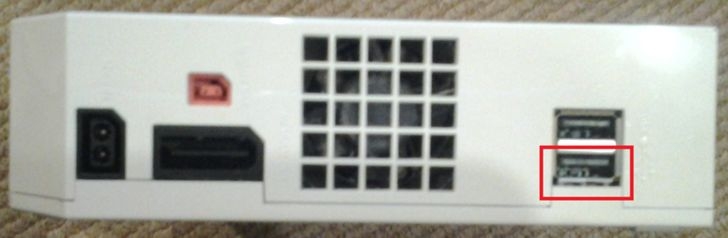

Is your Hard Drive connected to Port 0 please ?
Thank you.:)

Hello,
If you have a simple USB cable connected to wii, it may not work correctly.
your external hard drive is with a Y cable or a power supply electric ??
it helps with a Y-cable or power supply electric for the external hard drive.
