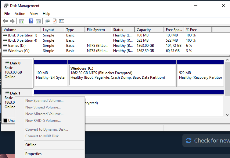

Another thing, the partition table needs to be MBR, not GPT, as Nintendont supports GPT but USB loaders do not.
how do i see what what it is now and how do i change it?
If it says "Convert to MBR" then it is in GPT and needs to be converted.
Normally the max size is 2 TB on MBR so if the drive is larger you can only use 2 TB.
