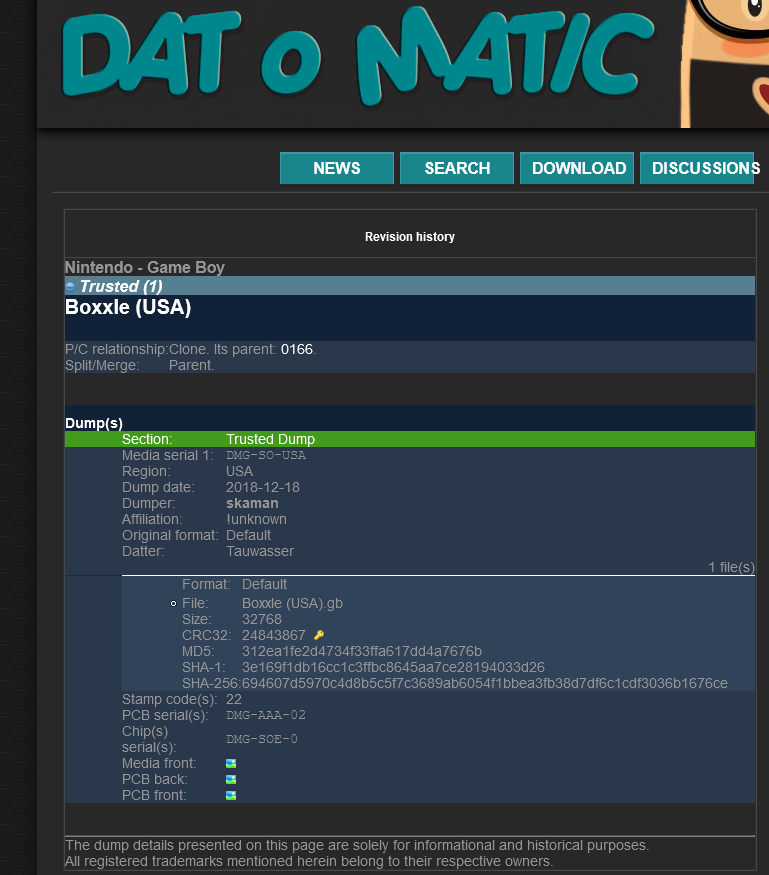

Interesting. What region is this cart and is it possible you can dump the ROM and give us a hash of it? (not the rom itself as that's against the rules here).

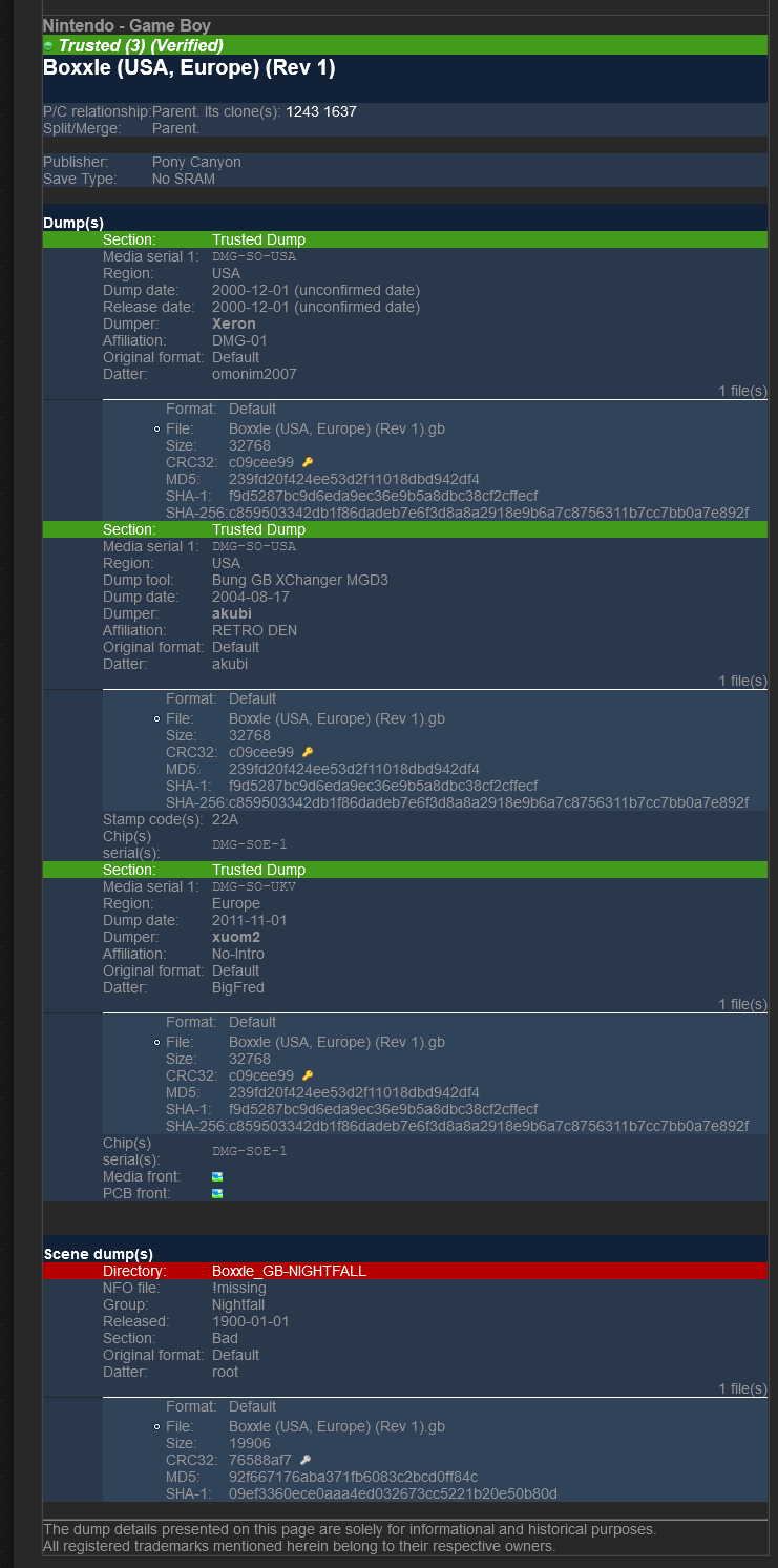

It does appear there is multiple versions of this game floating about:
Edit: I'm going to screencap the no-intro pages to avoid the weird bandwidth lockdown the site is experiencing.
Rev0 I think
<See first attachment>
Rev1
<See second attachment>
Rev0 I think
https://datomatic.no-intro.org/index.php?page=show_record&s=46&n=1637
Rev1 (1 Good and 1 bad dump)
https://datomatic.no-intro.org/index.php?page=show_record&s=46&n=0166
The region is USA, according to the cart. I dumped the rom to see for myself and sure enough, opening the ROM in an emulator and going to level 06-06 shows the missing box, same as when I play it on the cartridge itself! So I think this is a legitimate, actual bug in this version of the game.
I'm not sure how to hash the rom as you suggest - I will get back to you on that.
EDIT: Looks like I can generate hashes of a file using 7zip. Assuming that's what you're after this is what I got:
SHA1: 3E169F1DB16CC1C3FFBC8645AA7CE28194033D26
SHA256: 694607D5970C4D8B5C5F7C3689AB6054F1BBEA3FB38D7DF6C1CDF3036B1676CE
CRC32: 24843867
CRC64: 4256369463FE1B17
BLAKE2sp: 3594629F79ED9CEAF5191343BB5F36D4CB79457994539ED7D037FC0506290BBA
Seems to match the hashes on the first pages you linked too - Rev 0. I'm not 100% sure what that means for me, though.

10 year old mystery solved then :)
What this means is that your cart is the rev0 of this game, which is likely very rare, and exclusively has this bug.
I would guess the progression flaw was caught very early in Boxxle's production, given that only you and that other Atariage guy have mentioned it on the internet (from what I've googled). Also, rev0 was only recently added to nointro's database in 2018, further alluding to its rarity. Hold on to that game, it could be a collector's item someday.

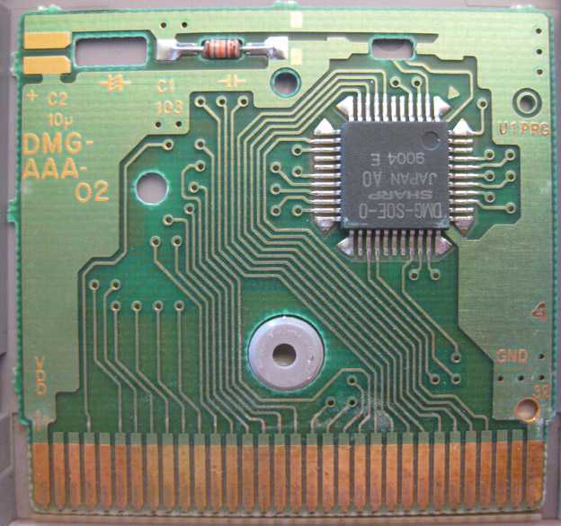

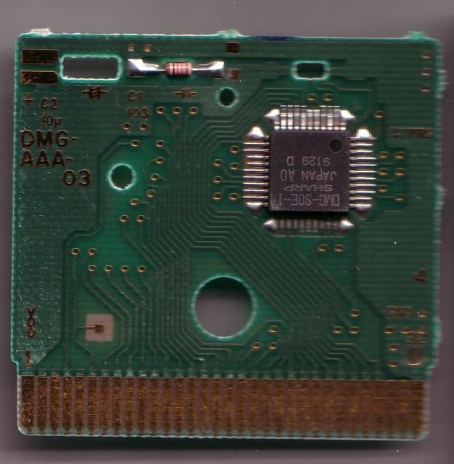

Nice find. I can add this to DAT-o-MATIC and so it can be marked as "verified". Although, if you don't mind, there is some "paperwork" that's sort-of required. If you could humour me, do you mind providing:
* Dump tool (with hardware/firmware/software version)
* Photos of the back of the cart and back and front of the PCB
* Size in bytes of the ROM

Sure thing! I attached a bunch of pictures, hopefully they cover all the bases of what's being asked for.
The size of the ROM is 32.0 KB, and it was dumped using the Submodule GB01 cartridge reader running firmware version 12 and software version 1.3.13.
