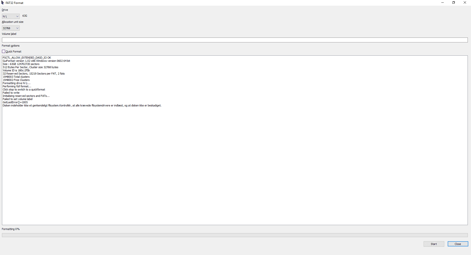

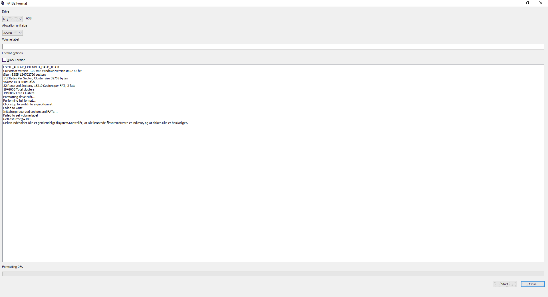

EDIT 2: Damn, okay, 1 last thing (hopefully). The SD Card does show that it is now formatted as fat32. But the total amount of space still reads as 59.4GB. Seeing as I chose an allocation size of 32GB, is that not what Windows is supposed to report?
EDIT 3. This just isn't my day....The Card ejects itself while being tested using H2test for Windows. It's just one roadblock after the other:hateit:

View attachment 135086 View attachment 135087
Glad you were at least able to format it with guiformat. At least that's one step forward.
59.4GB is correct assuming that you have a 64GB SD card. The allocation size unit that you selected is actually 32768 bytes (or 32kb). Allocation size unit (aka cluster size) does not determine how much space you are setting aside to format. That's actually called "partitioning". Allocation Unit size is the minimum amount of space used to store a file. If you're interested in deeper detail on what allocation size, check this article out: https://support.microsoft.com/en-us/help/140365/default-cluster-size-for-ntfs-fat-and-exfat
I found a similar post where they received the same 1005 error using guiformat and they finally determined that they had to replace the card, unfortunately. Here's the link to that: https://www.computerforum.com/threads/microsd-xc-painfully-slow-write-speed.231184/page-3
Maybe you have a defective card or something.
