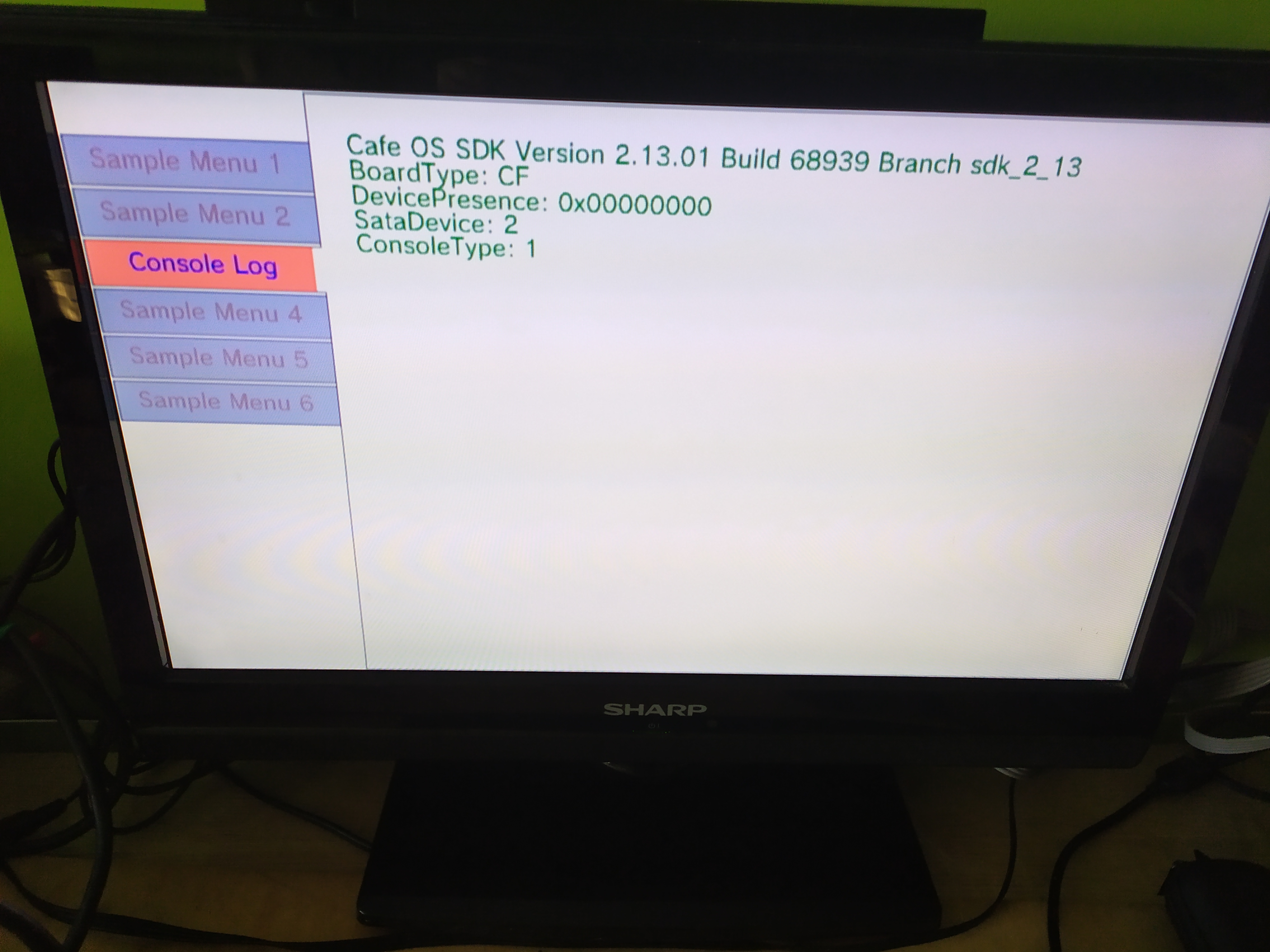

Get the CAT-R updater and dd it to SD card
Power WiiU on with both POWER and EJECT
evoila?
Hm, well, I don't have a computer with a serial port anymore, but I guess I could get one (which would be cheaper than the USB cable - unless you can put two of the FT232 USB to serial converters on each end?)
For now just getting this to work would be more than enough.
Not sure if I can find the required images for this, but I guess I'll try.
Would be excellent, thank you.
It does get into this menu if I hold POWER and EJECT, so I guess it's ready to do the thing.
I did.

Hi. I have disc drive error 160-1400.
I try Set SEEPROM SATA device type —> No device, and then i have:
seeprom: bad AA55 marker! 0000
SEEPROM failed to verity!
(Check your otp.bin?)
Hardware params calc: 973d546b sroted: 973d546b
Primary boot1 params calc: 608cdc79 stored: 20b91000
Secondary boot1 params calc: 77f7c83a stored: 20b91001
Decrypted boot1 versions: v8377 (20b9) and v8377 (20b9)
SEEPROM failed to verify! 0x1000 and 0x1001
boot1 version cannot be written to SEEPROM without a valid otp.bin!
Can you please fix my seeprom.bin and otp.bin?
