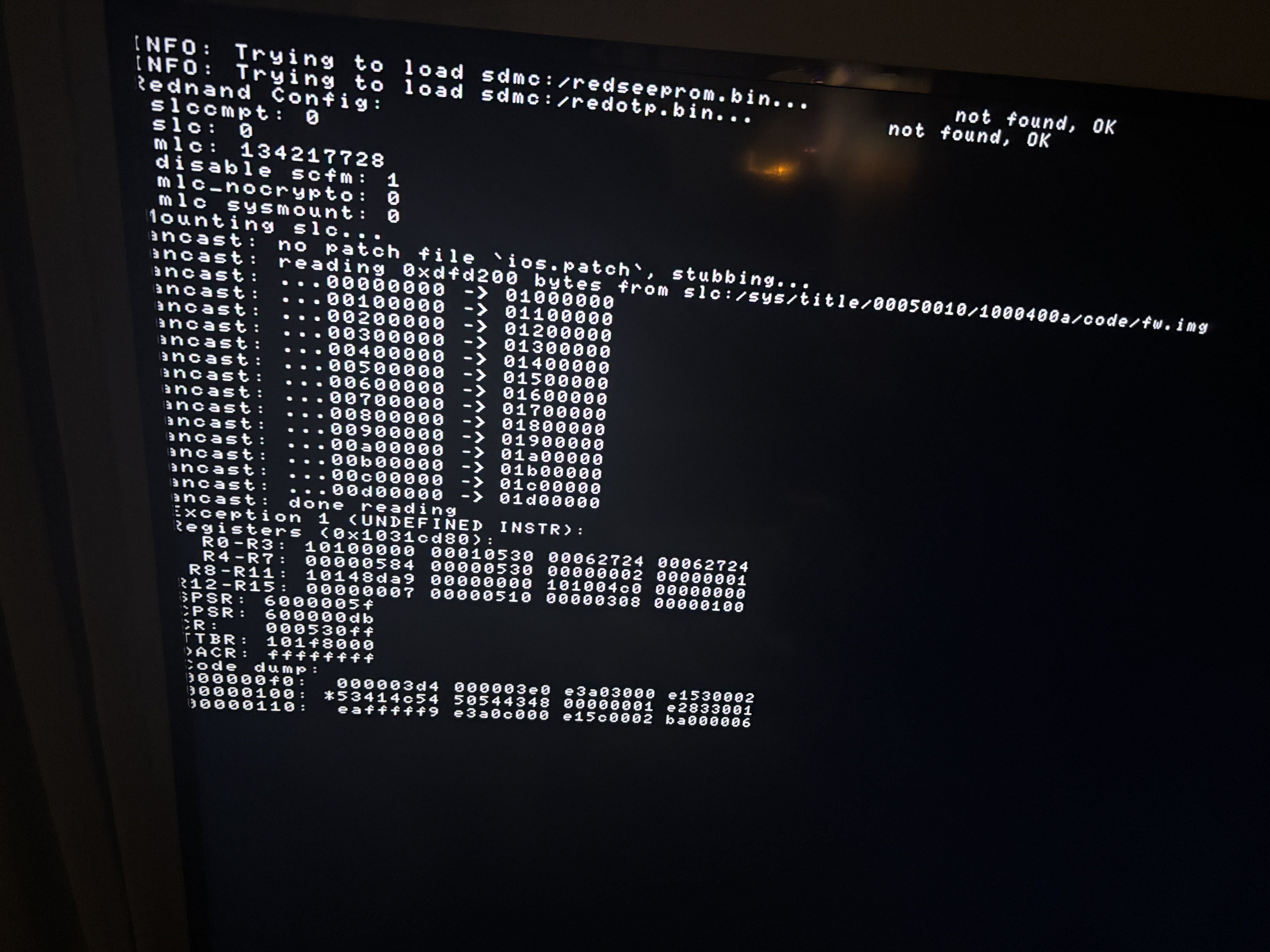

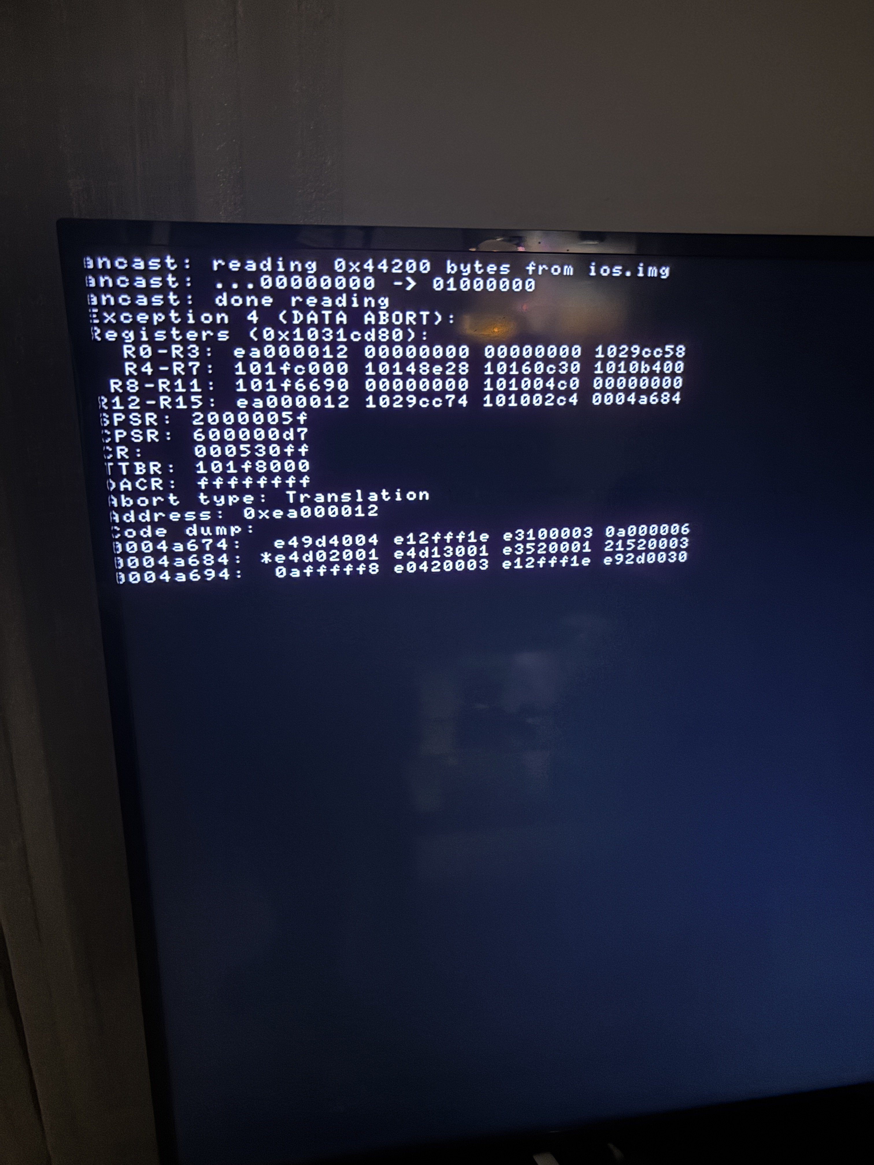

Now I know why it doesn’t work
I have an error when I boot iOS.img from minute
I also have an error to setup rednand
Where did you found this one ?
I just made it, but the older minute versions which always inited the screen should do the same.
It looks like it reads garbage from the SD. But interestingly it seems it wa sable to rea dthe rednand.ini and the header of the ancast images also seems to be correct else it would have complained about that. So maybe it fails only on multi sector reads or something like that. I hope it's not bad dram.
Please don't try to setup rednand until we have ISFShax installed else that might things worse. Also do NOT have the setup plugin in the ios_plugins for now, we don't want to accidentally mess up the system more until we have ISFShax.
Could you try the "Patch ISFShax and boot IOS (slc)". That doesn't load anything from SD and should just boot normal again. If that works then minute has a problem reading the sdcard correctly but f that fails in a similar way too, then something else is wrong.
I made a minute version which forces the fallback mod efor multi block sd access. See if that works better.
EDIT: just updated the zip to also reinit the display

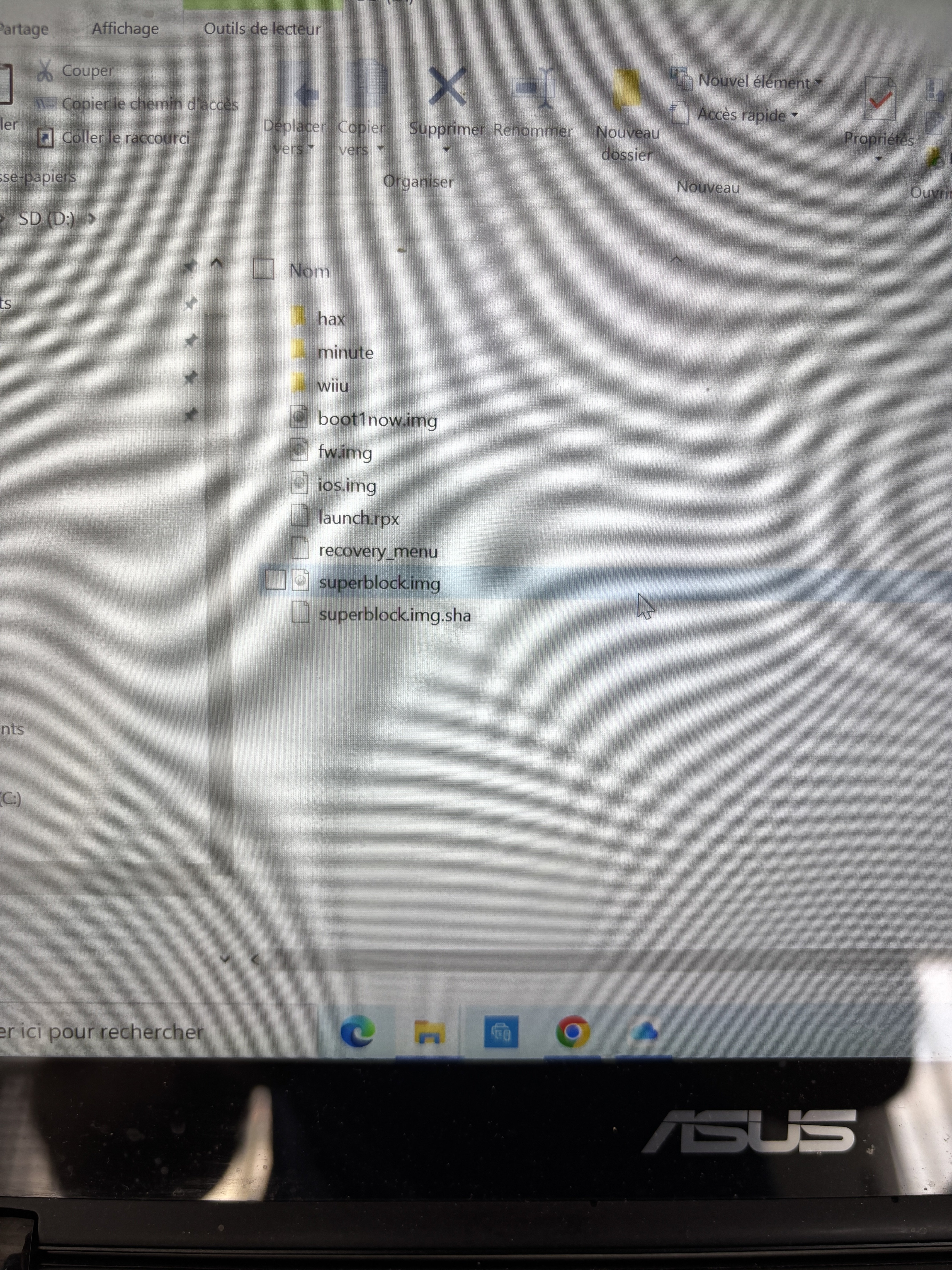

Sorry
Yeah it works with normal minute
I had wrong fw.img file on my SD card since I have installed aroma too on my redNAND
After cleaning files and put normal minute on SD card, it just auto boot to it normally :)
