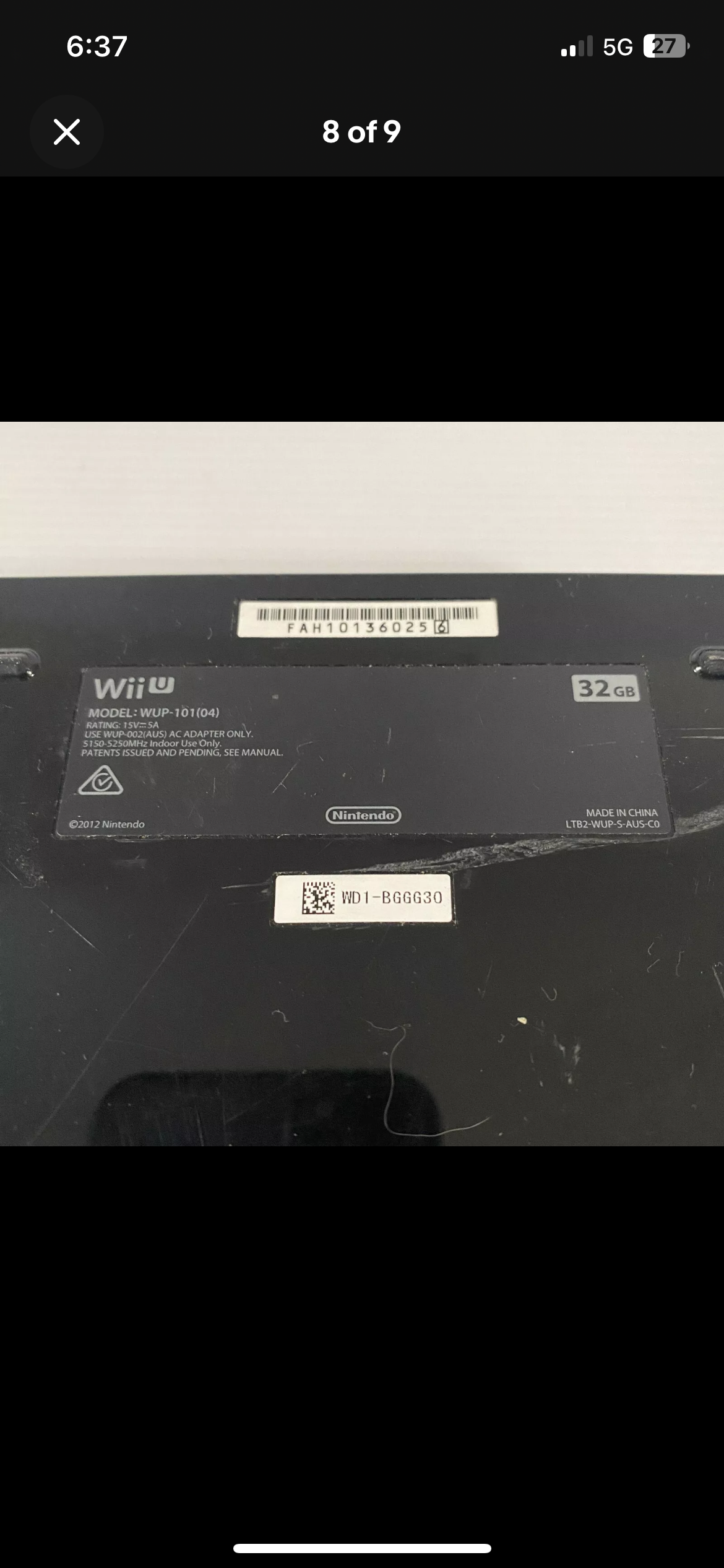

There are only 3 Regions on the Wii U: JPN, US, EU. Which one you have, you can find on the sticker on the bottom.
Hey there is actually no mention of those regions on the sticker. The Australian console has the AUS region. If I’m missing something please tell me.
Oh you are right. What title is it set to currently?
That I don’t actually know. I think It would have to be EUR as they are both pal regions?
Either way I have no video output/os crashes and I’m waiting for a pico to do some diagnostics. That was going to be my next question 😂
If the problem is no screen output, then the problem isn't the coldboot title.
I suggest looking at the troubleshooting guide in my signature
