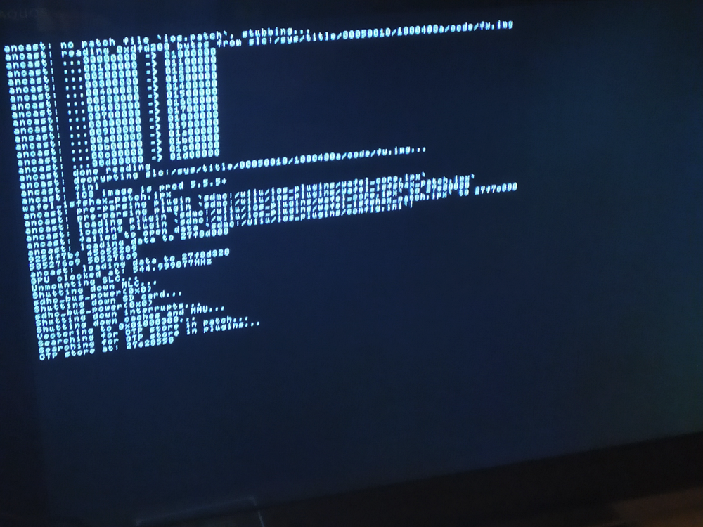

@skawo I see a lot of these messages:

04:30:09:256: FAIL: PPC Core 0 Heartbeat Failed!  Restarting...

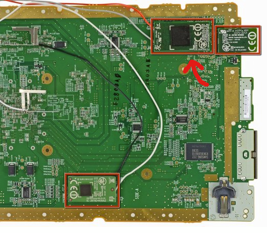

Can you try to remove the 2,4Ghz Wifi module and see if that changes anything?
Certainly
If I'm not mistaken, that's this one, right?
Would be weird if it was that, though, since I could connect to wupserver over wifi fine...

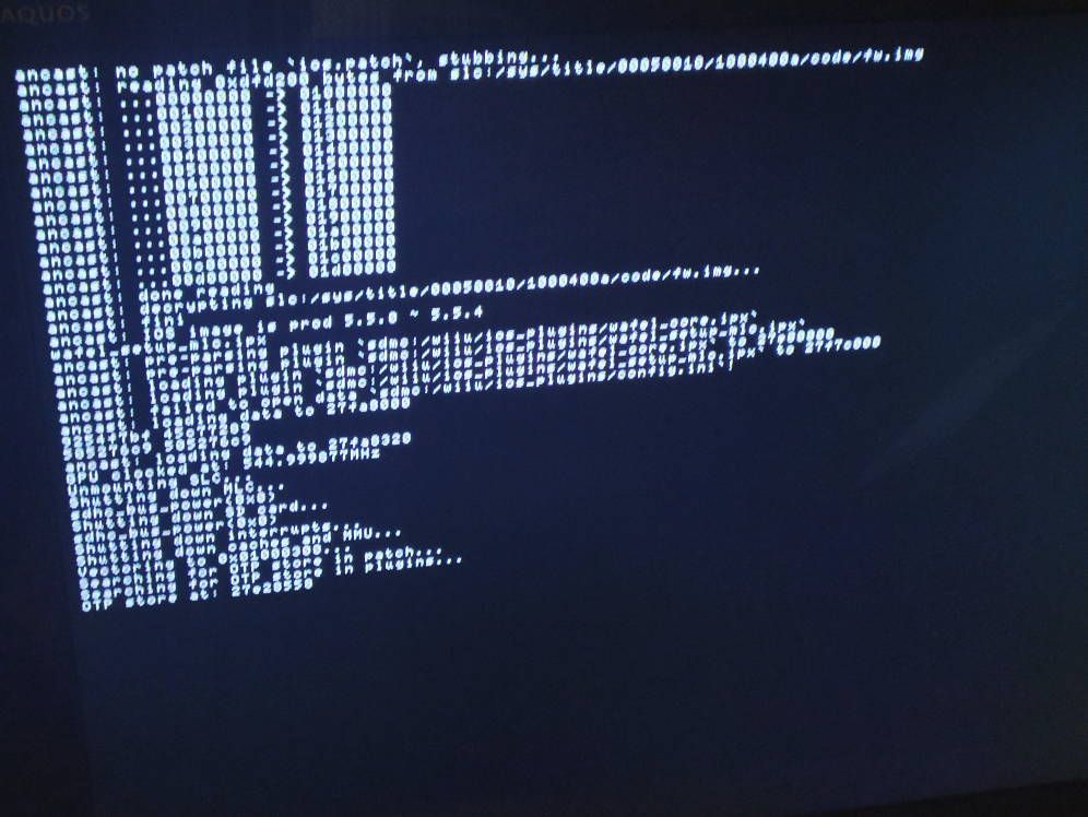

It looks exactly like the in this post here:
https://gbatemp.net/threads/udpih-usb-host-stack-exploit-recovery-menu.613369/page-30#post-10086825
Recovery menu DOES work, though, it just outputs the garbled screen.
Didn't see any solution to this being posted, hence why I re-asked.
Tried it; nothing changed.
Tried to start the WiiU without the other two modules and that did nothing, either.
Also tried to reflow the HDMI scaler chip and that did nothing as well.
