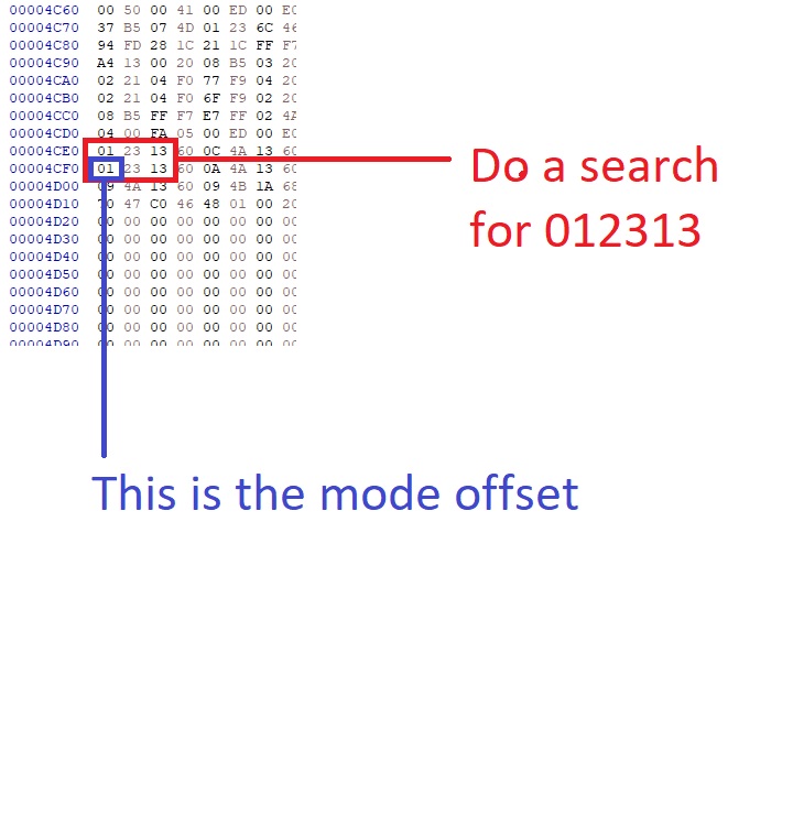

This get here today. Can someone please tell me what file to use and how to edit the offsets.
OK... I refer you to the below diagram. Use HxD to edit the UF2 file. Save, drag back to chip.
Thank you so much. Since this is an external dongle I should treat it as method 1 correct? Pin 1 is my switch I will need to connect to ground to toggle payload? Looking at the files I'm not 100% sure what uf2is considered for the external install I don't think I need swiftboot since of how it's installed but there is a rebug legacy and generic. I think I ruled out the method 3 file since it's method 1?
