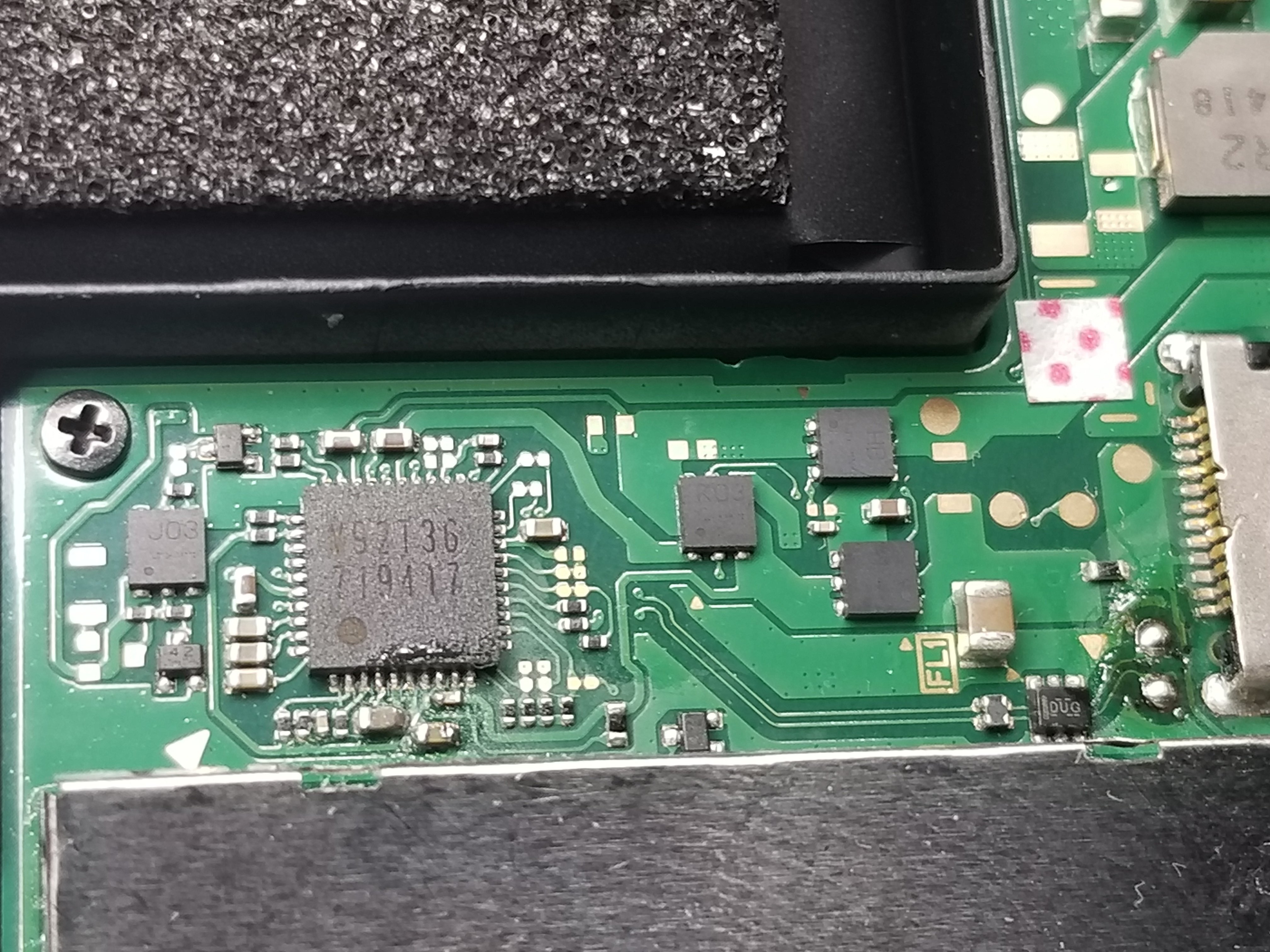

So i tried to install my trinket,
completely forgot to remove the resistor from the trinket(next to led)
could this have bricked my console? it booted ONCE with the BOOT.DAT? pic and then i powered it off, plugged in my SD and it never booted again.
I can hear a buzzing sound when i press the power button. Does not connect via PC, completely removed the trinket but same thing.
did i fry the M92T36 chip?
edit:
So after looking at a few other installs, seems its not compulsory to remove the resistor.
After thinking about it, anyone know how to diagnose the M92T36 chip? I think i may have bridged a lead when turning the switch over to power it off, or i may have even left the battery plugged in while soldering. I have a rework station, but I dont want to spend another $20 on the IC if I am just going to have to buy another switch.
edit:
clean up around the chip so no flux is left, then you'll get a better idea if anything is bridged.
another thing to try is charge up your switch just in case it's gone flat.
hold power button for 12 to 15 seconds to see if it either it fully shuts down or starts up.
not removing the led ain't the reason for issues, you don't have to remove it if you don't want to.
forget about the install until you have it powering back up.
then you can reinstall the trinket.
