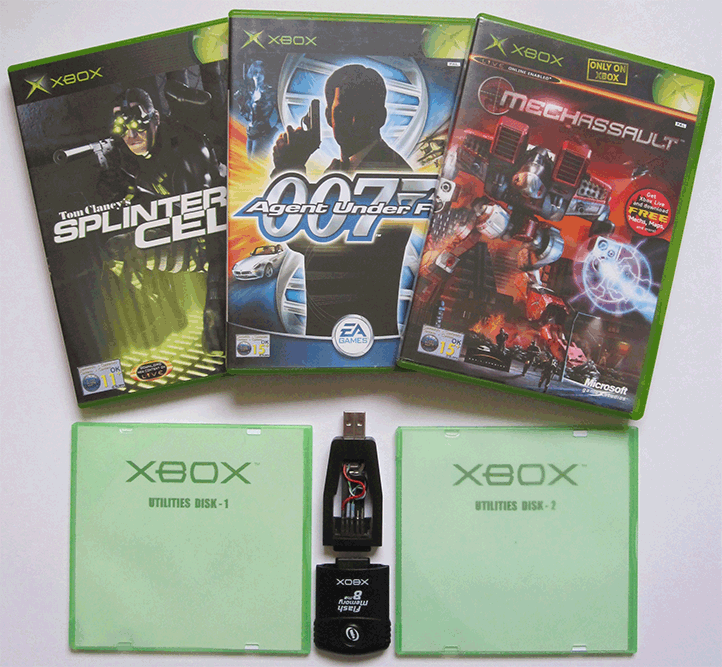

I note your comments regarding your email to the programs creator, and am not surprised by the lack of interest shown! In an endevour to help further, I did a search and came across - see the picture - This image was on one of the disks and shows what I think were the game disks that could be used to exploit the XBox, an 8MB MU, and the XB/PC interface I made, I must admit I had forgotten all about these, but looking at the date on the files it was 15 years ago ... hmmmm ... Unfortunately over Christmas we had a bereavement and I'm sure you will understand there are much more important matters to attend too, so gaming and computing are unfortunately on the 'back burner' for the moment and will be so for some time to come. As soon as I get time I will look into this, there is also a device called Action Replay, and all the software, and according to the wite-up allows the use of any XBox game save to be shared between other users on other machines - or so it says - To be honest I have just come to update the Arduino sketch to update my PS4 WEMOS and struggled to get to grips with that after 12 months ... so after 15 years there is not much chance of remembering any of that - will be in touch when I have had time to look into it all ...

I'm aware of the exploits like Hacks Under Fire, but remember, this is all happening on Xbox 360, so Action Replay is out of the question, and the other exploits may not work, either.

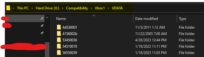

I know this is an old thread, but I did figure this out by doing something similar. I wanted to take my OG XBox saves from a 360 back to an original XBox, because I didn't like some of the oddball things the 360 was doing with emulation. I had a ton of games that had way too much progress to let go.
1. Go to the Eaton Works FatXplorer website and download the latest Beta release. Unzip the file to the directory of your choice.
2. Connect the 360 HDD to a PC with the Hard Drive Transfer Cable
3. Run FatXplorer Beta executable as an administrator and click on "Devices" in the upper left corner. This did not work for me until I ran as administrator. It seems to only give access to all the folders when you are an admin.
4. Click the Icon for your HDD.
5. A new window will open. In the "Mount Options" menu, load the device. You will then see all the drive partitions.
6. Click the "Content Partition" and then the mount button. Mine defaults to "X" for the drive letter. Just make sure it is an unused letter and you will be fine.
7. A new file view window will open up with the newly mounted partition.
8. Follow this path on the mounted partition.
9. These are your game saves. Copy them to a folder on your desktop.
