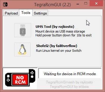

the memloader payload from https://switchtools.sshnuke.net/ allows you to access SD via USB but obviously your Switch needs to be in RCM for that to work, I use it all the time though as my SD card reader is shit and disconnects every 2 minutes
Wait a second but does memloader brick with purple screens???
Been using it here for months together with TegraRcmGUI (-> UMS Tool).
Reliable and without any transmission errors.
If anyone is getting failures with this method, check the cable or the usb where you're connecting it. I was getting RC error 13 because of the port, it was 2.0 infront and I moved to a 3.0 in the back and everything is working just great.
Maybe a little bit slow, just 4.2 mb/s max without any bottle necks, idk...
