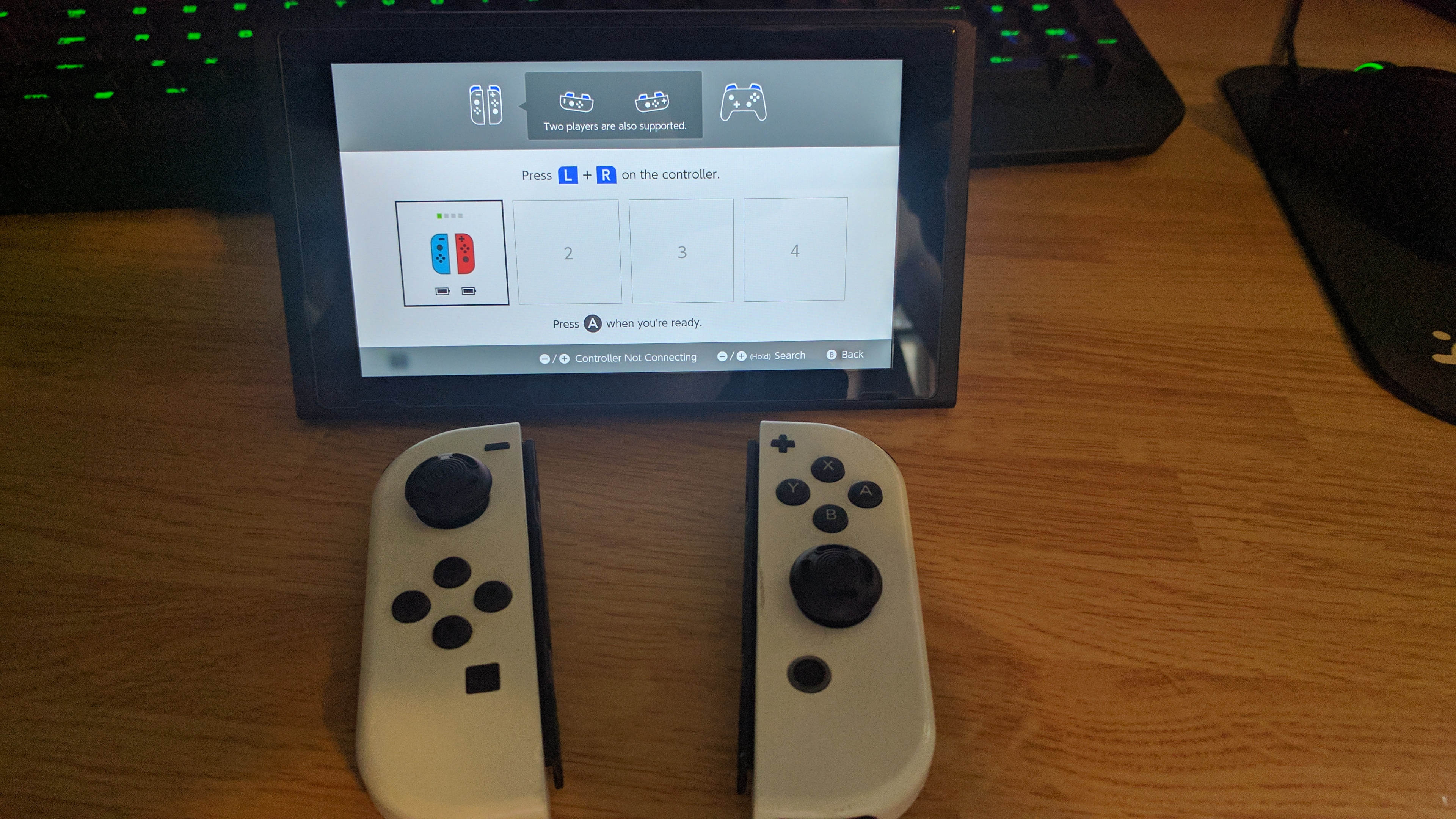

Success! Went from gray to neon. I custom painted my joycon, they were originally gray but I bought the neon shells. Waiting for those to arrive. Picture was taken before I changed button color but I don't think there would have been a difference on picture.
