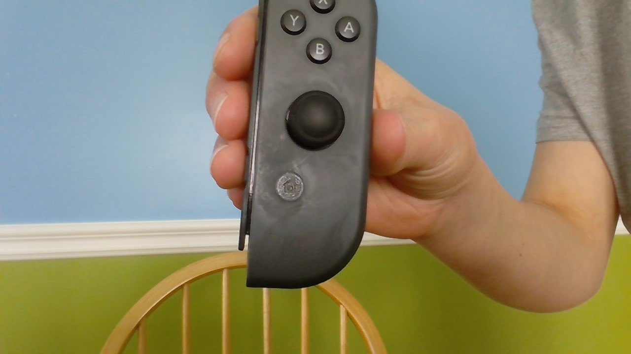

The thing on top is made of rubber (I don't know if it is good for the spray to get there):
it worked thank you but beware the plastic button are very fragile the spray was too strong and ran on the home button and it is very endomager so when you finish you must wipe very quicklybut the home button work perfectly

it worked thank you but beware the plastic button are very fragile the spray was too strong and ran on the home button and it is very endomager so when you finish you must wipe very quicklybut the home button work again perfectly View attachment 119584
Oh, so EL749 is heavy duty, eh? :/
I should have told you to also cover the home button with a tape, because it is also made out of rubber..
Reactions: TotalInsanity4
it worked thank you but beware the plastic button are very fragile the spray was too strong and ran on the home button and it is very endomager so when you finish you must wipe very quicklybut the home button work perfectly View attachment 119584
Oh... my... Were you using electronics cleaner or an chemical-based lubricant? I don't think I've ever seen electronics cleaner just disintegrate plastic like that
It was not a lubricant, it's the opposite.
But some electronic cleaner are heavy duty though and can damage rubber.
That's why I told him to cover the stick top. But I forgot about the home button. I was thinking about Left joy-con, the same that I had the same problem..
the rubber stick I had covered with saran wrap but it had passed anyway but it had no damage except to be drier and slip less for the shoot.
