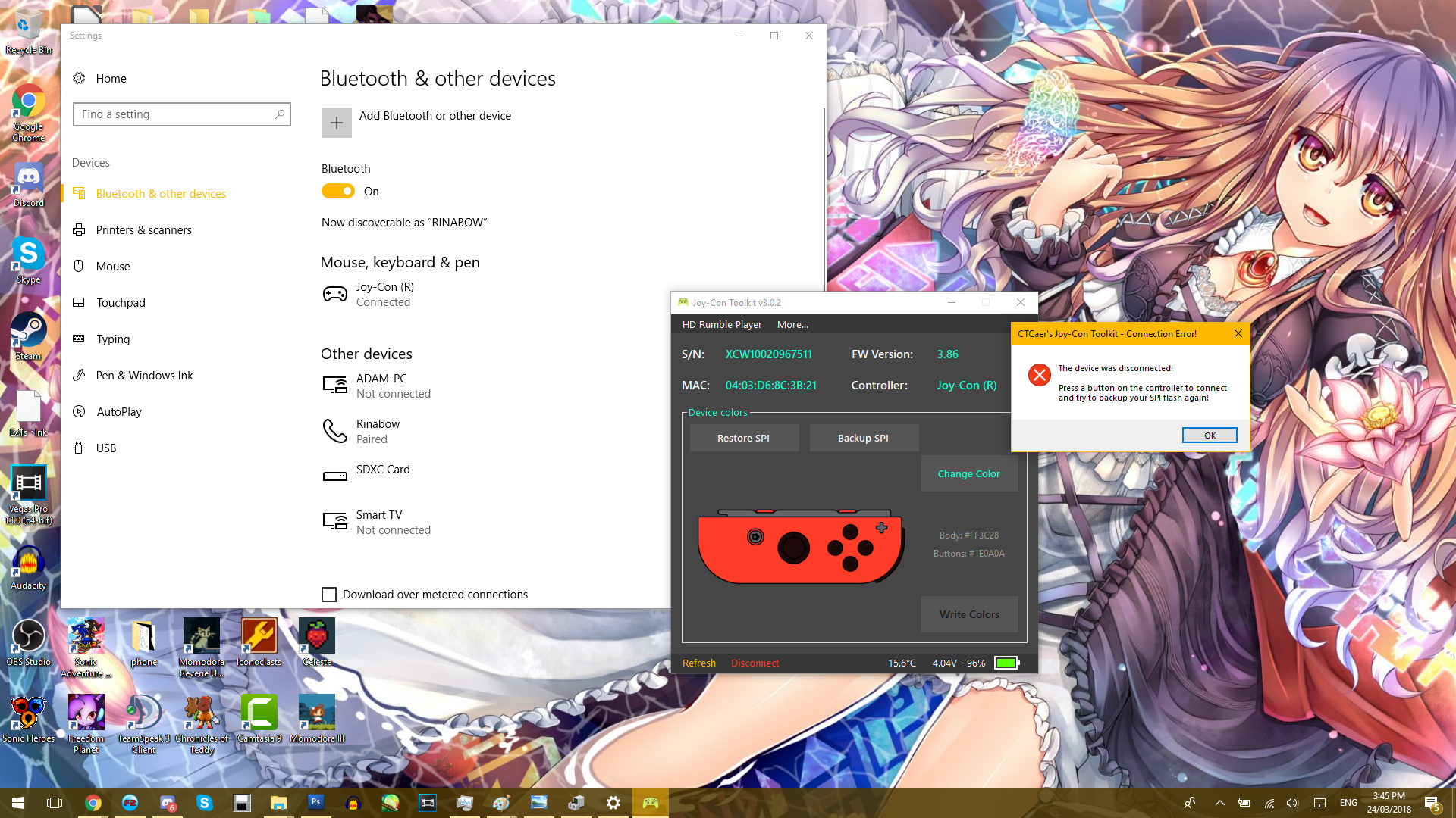

It does say paired, and I have been trying it with just the one joycon connected. I have 4 joycons; 2 left, and 2 right. The software works with both my left joycons, but the moment I try it with either of my right joycons, it will show the joycon on the screen when it opens up, but then insist that I've disconnected it whenever I try to chenge color, backup SPI, or anything similar. It's honestly quite bizarre.
Thing is, the joycon works in every other sense on my laptop. It shows up as connected, shows up under my connected controllers, and I've even been able to use it in games. For some reason though, the jctoolkit software will only work on my left joycons, and not my right ones... ¯\_(ツ)_/¯
Hmm that's strange then. I just tested connecting only the right one and it works (all functions).
You tried removing both right joycon from settings and then re-pair only one and try the toolkit?

As I said before, the joycon is definitely connected. It even shows up on screen when I open the software, and the joycon itself even vibrates when I open the program, so it's definitely not a connection issue. The home button even blinks to say that it's connected, and the green lights on the side fix to the "1" position, and continues to do so even after the software tells me that the "Device was disconnected".
Edit: Attached Screenshots
Sorry, I was just making sure that it's not a problem from windows. What functions are you trying to use? You have that problem with everything?
Maybe I messed up a handle somewhere. (I just tested 3.0.2 again though, and everything works on my side :/)

It throws up that error whenever I press basically any button. I can't change colors, backup or restore SPI, or even use the button test.
Incidentally, this is an issue I had back in version 2.0, and I came back to get the newest version just to be sure.
I really don't know how to help you, because it works for me in win10 and win7/win8.1 VMs.
Maybe try to remove the device and then remove the BT adapter (because you have a laptop, try to disable the adapter in Device manager. Not in settings). Then do a restart re-enable the bt adapter and re-pair.
Have you tried change the BT-usb to all usb ports your pc has?
I know it sounds silly,but the last time i used the program,i had several error which were solved this way (windows 7)
