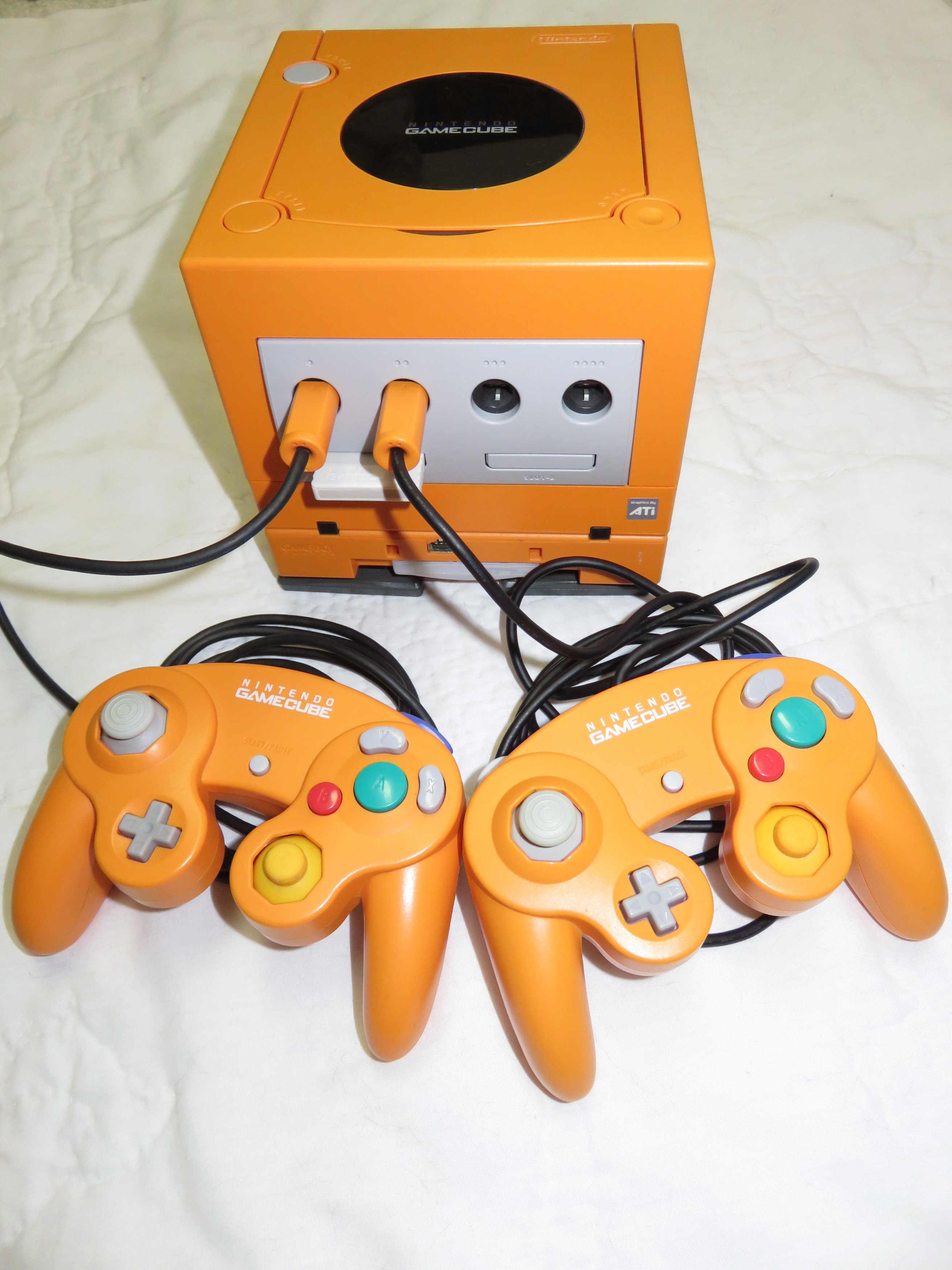

I understand the OCD issue. Here's my Cube.
Famicom controller its really nice for those games!! It must feel so spot on!
Hahah glad to know I am not alone with my ocd! Btw, really nice setup! I love that color!
