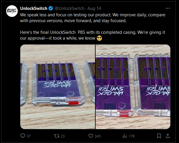

From the UnlockSwitch Telegram channel:
THE XTRACTOR !!!
Like the UnlockSwitch PBS, the Xtractor is upgradable over time using the SAME programmer. The Xtractor ’s main feature is its ability to back up your original Switch games onto your PC or Mac (Mac support is currently in development).
We've also included a microSD port directly on the Xtractor to make it easier to transfer your original games.
In summary:
The Xtractor is programmable and therefore upgradable.
You can back up your games to your computer or directly onto the integrated microSD card with a simple copy-past
The PC version will be available at launch.
Mass Production for the UnlockSwitch PBS and Xtractor will begin in early September.
