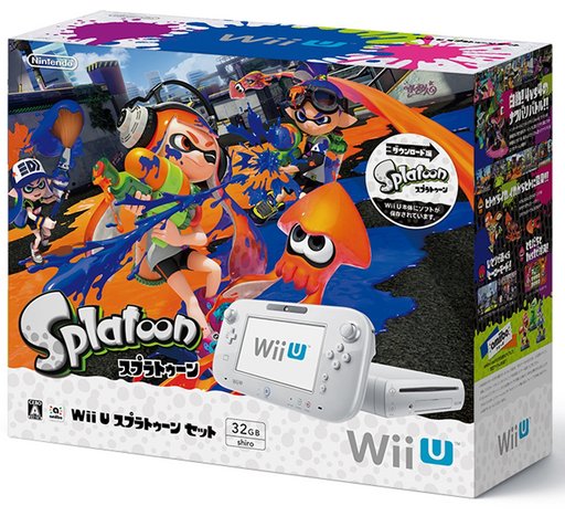

Any one know the firmware availables on japanese wii u bundles? I know the mario maker is above 5.3.2 but i found this splatoon set with the download code.
Reactions: Sharl
Whats the difference between a basic and premium set? this one is 32gb hd so i thought it was a premium but just white.
Oh! I apologize, I didn't see the 32GB on the box and didn't know Japan had white 32GB models. I assumed black was 32GB and white was 8GB everywhere. In that case, I'm really not sure. Sorry again.
Reactions: luan43
