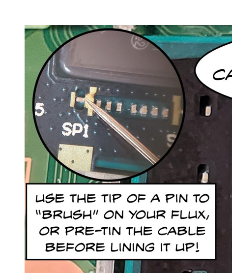

I think I'm going to follow you with this. I have no experience, but I definitely think I can learn to have the skill for this. Could you tell me what kind of flux you used for this? All the other components seem straightforward, but that's the one that's got me boggled.

Oh, thank you. Does the type of flux matter much? And will having the flux be in a syringe/pen help me much?

I used a flux pen to be precise with the application of the flux.
Yep, buying a LCD soldering iron is on my list, currently buying a possibly moddable v1 switch off ebay listed as for parts to figure out the problem and fix for 30$. If it is moddable, then great, I saved myself 40$ of buying all the stuff to install a modchip. If not, then I can try to install the modchip without worrying about screwing over my only switch. I'm still young and have good eyes, do I truly need a microscope? Would a magnifying glass work? I have a 3rd hand helper with alligator clips and a magnifying glass already for electronics, will that work?

4: Yes, flux matters. It is the same as a good quality iron and quality solder. Cheap out on one of the 3 and you could have problems.
