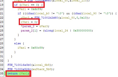

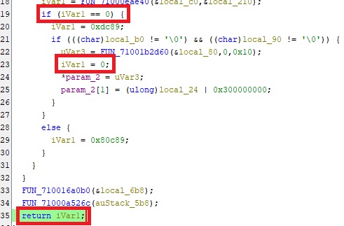

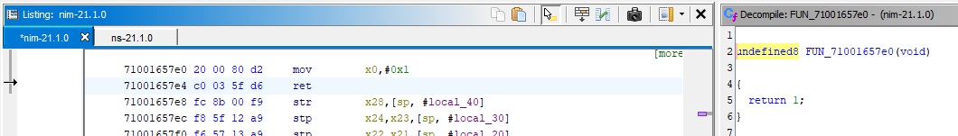

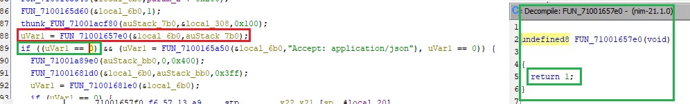

either way, the return of 0x11653c (21.1.0) in NIM is what determines if an update is being initiated.
and that gets the value determining if its updating from function if that function (the one below) returns zero, it will fetch the update.
0x166FE0 (20.5.0)
0x1657F0 (21.0.0)
0x1657E0 (21.1.0)
(RET 1 - patch applied to that offset (00 08 size)
20 00 80 d2 c0 03 5F
View attachment 544173View attachment 544175
You forgot to put D6 at the end of the RET, however I just tried the patch on 20.5.0 and it still downloads the update nca files. But thanks for looking.
Here's a patch, this one is working now: (System Update Blocking patch)
412CA954A47280118C72280EFAEAC33F490793B6.ips
50 41 54 43 48 11 B3 10 00 04 C0 03 5F D6 11 93 84 00 04 C0 03 5F D6 45 4F 46
Now we can't update, 1st address is for debug firmware updates, second address is for firmware updates.
