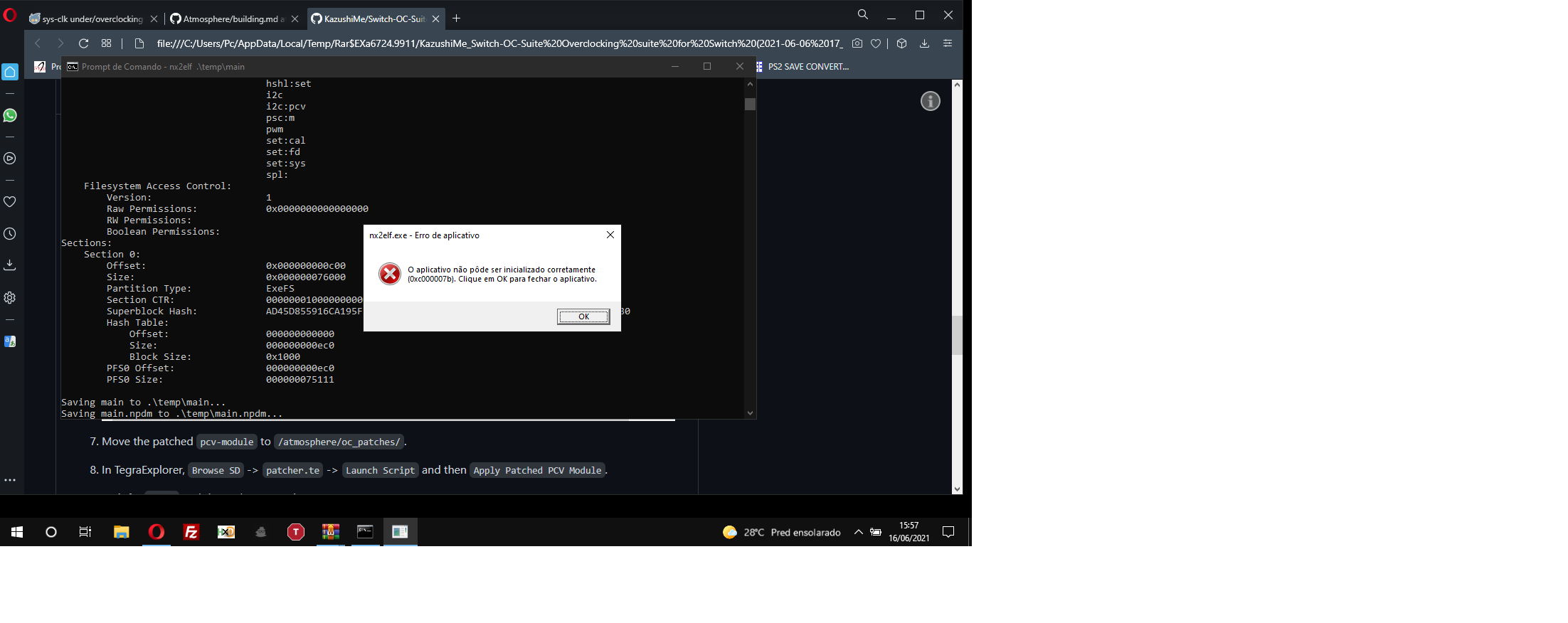

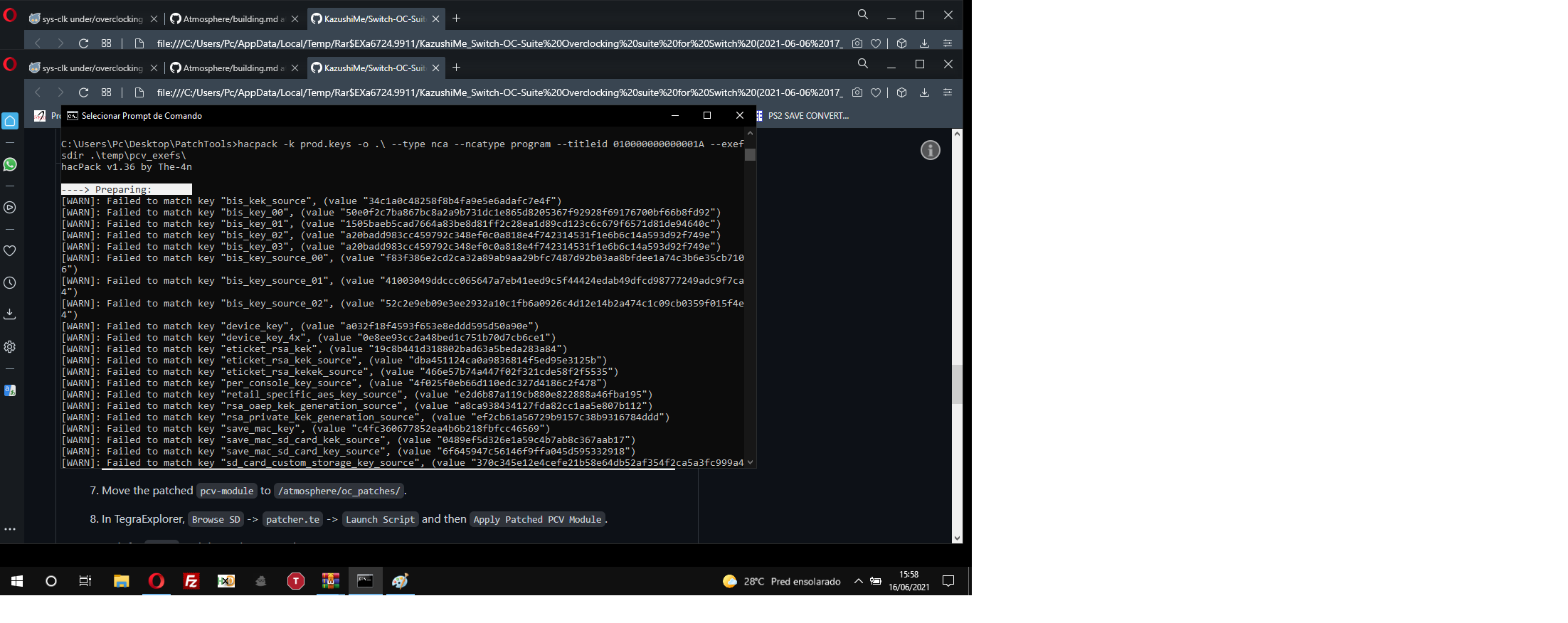

I get stuck in patch tools :(. I take the risks, I made the necessary backups.
  • PatchTools.rar
    PatchTools.rar
I really wouldn't recommend that method, it's more complicated, has a higher chance of causing problems, makes your system unbootable without sigpatches, and is harder to reverse, while providing basically no benefit.
Edit: also, that guide won't work on Erista for ram.
Edit2: ig it sorta does actually, Minerva shit is in the "details" part, but not the "installation" part for... some reason...?
