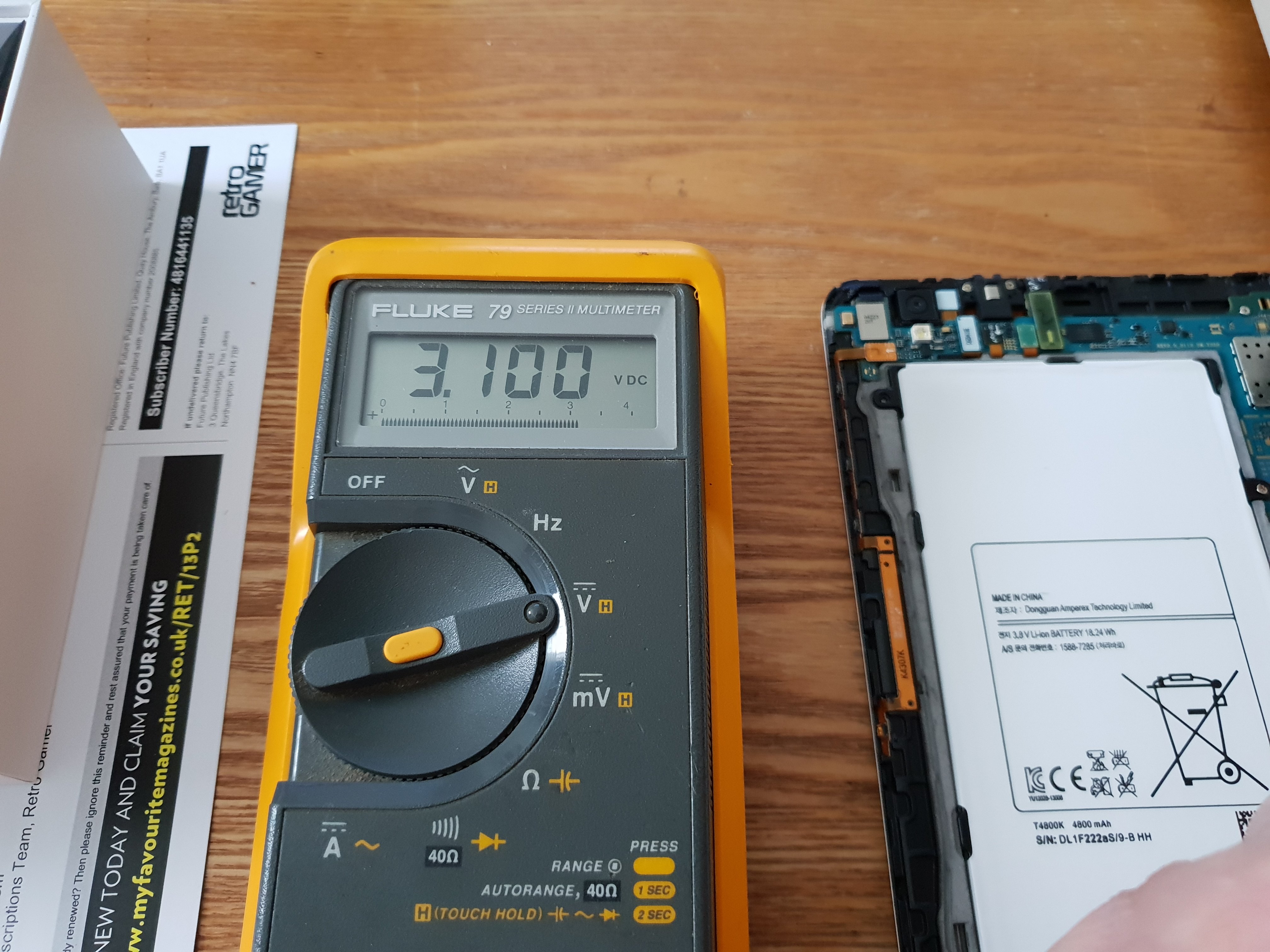

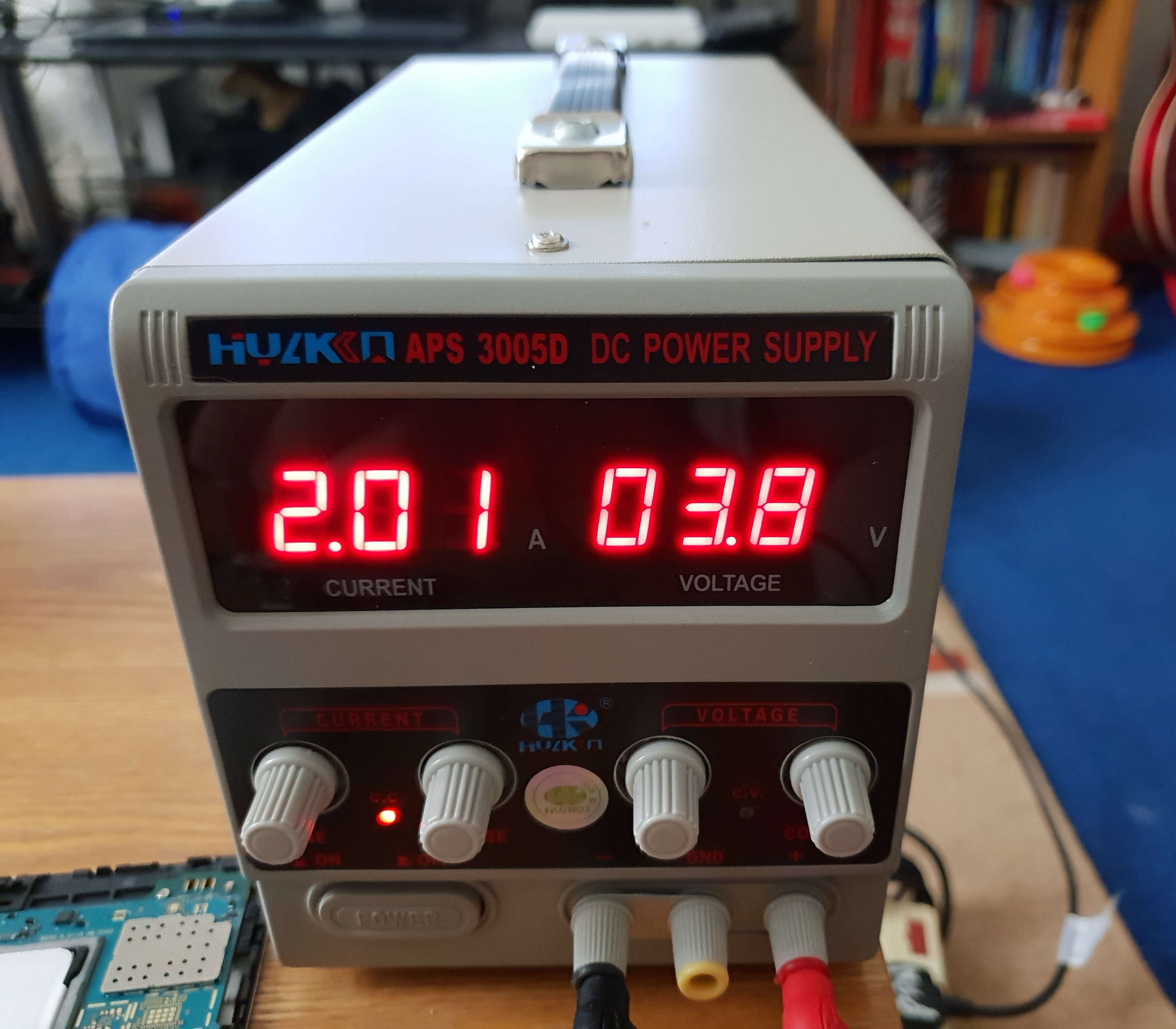

If you have a bench power supply you can usually revive the battery, it probably dropped below 3.1v meaning the charge circuit cant charge it. Boost the voltage with 5.2v @ 2amps for 5 mins then whack it on charge.
Hers an samsung battery as example, low voltage

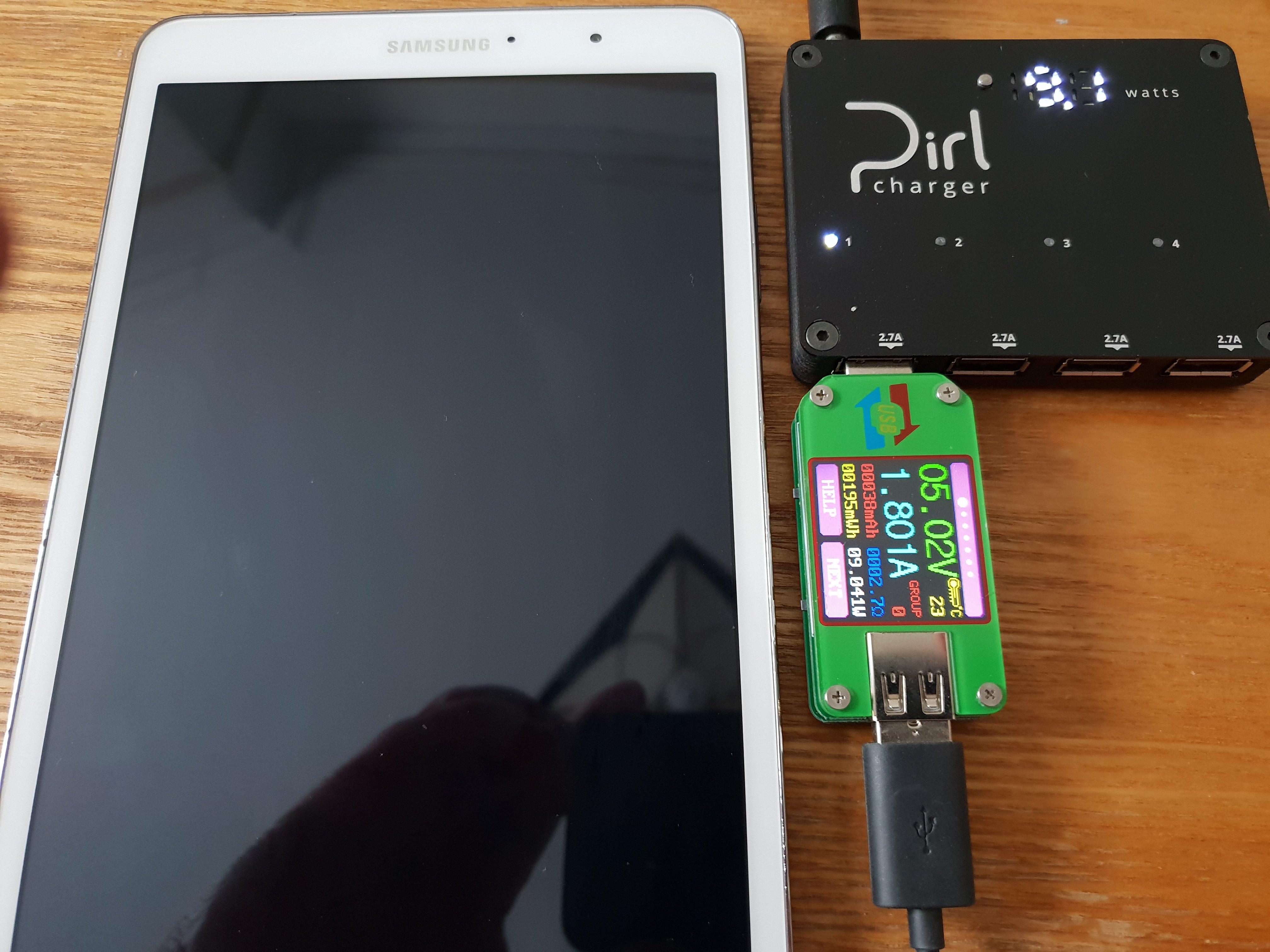

Bench psu for a couple of mins.
Now charges at 1.8amps on its own.
