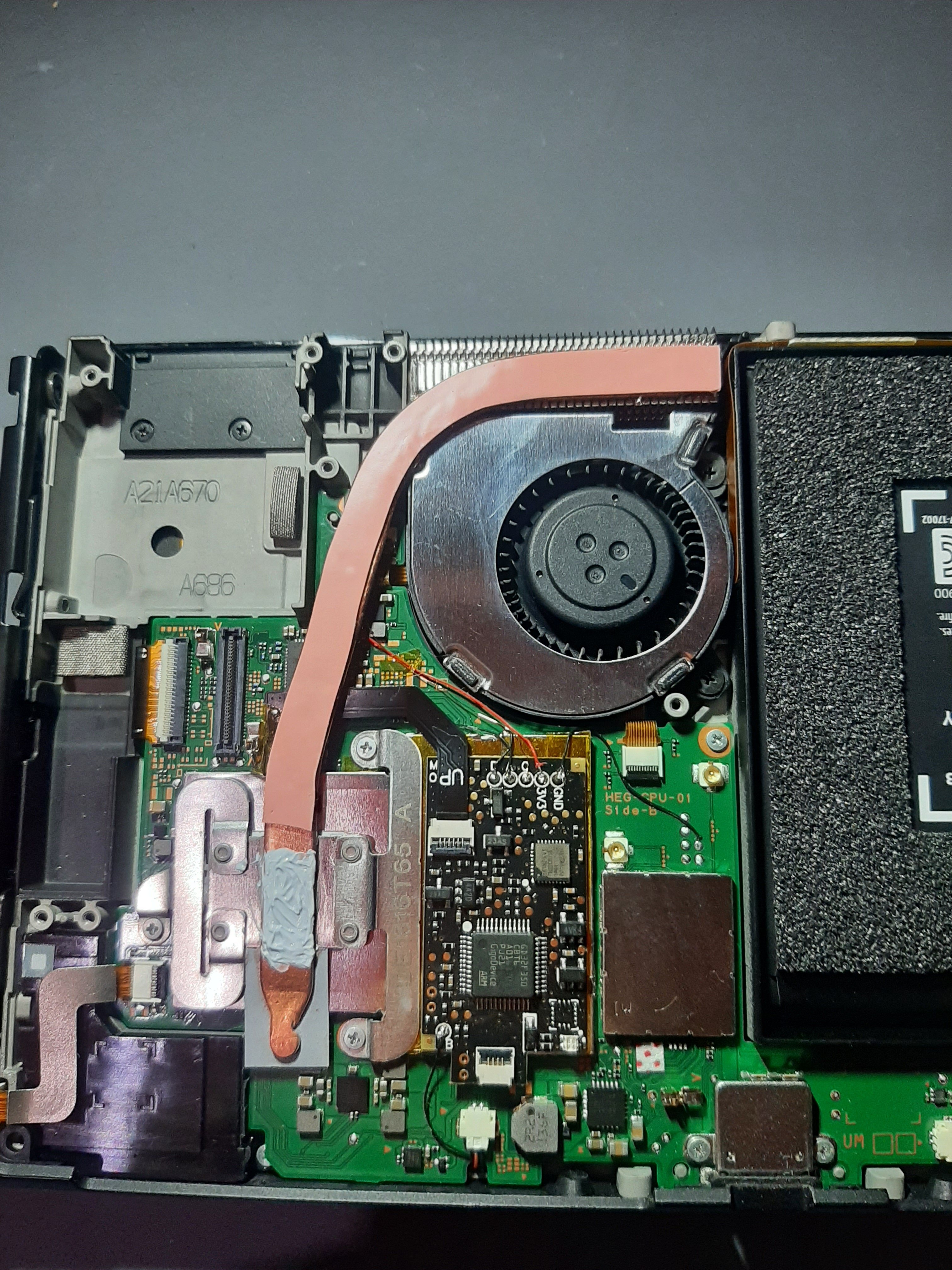

In an attempt to reduce the temperature of my V1 switch's electronic components and prolong their life I did a few thermal mods on it:
  1. Removed the factory thermal compound (almost the consistency of dried up toothpaste)
  2. Removed the metal shim between the heatpipe and CPU and the thermal compound there
  3. Applied thermal pads to ram chips so they come directly in contact with the metal shield
  4. Replaced thermal compound between heatpipe and metal shield with thermal pad.
Now my logic was that drawing heat away from the components will help cool them, but I think I did more harm than good. The back of the switch now gets much hotter than before and it idles at around 40C and in Mario 3D World it gets to 47-50C (as per status monitor reading). I'm concerned that the better thermal interface draws heat away from the path of the airflow (aka the radiator) and puts it into the shield where it is actually harder to dissipate.
I was curious if anybody else has attempted similar mod, and if so what were the results. If not, what are your regular V1 switch idle/game temps?

I basically never cared to post to this forum, but I finally made an account here just to say that this mod specifically is not ideal. Thermal pads running on top of the heat pipe to connect it to the heat shield impedes both the heat pipe and shielding’s function.
Heat pipes work by having two distinct areas where the transfer of thermal energy occurs, the hot end to evaporate the water in them and the cool end to condense it. You’re eliminating the two areas. You run the risk of potentially ruining/bursting your heat pipe if temps ever get too high and pressure builds, which isn’t as unlikely as it sounds.
Additionally, the heat shielding in this case was added to prevent extreme hotspots on the back plastic and instead spread it into more thermal mass so the temperature is lower over a larger area. It is NOT to dissipate more heat, though adding thermal mass will always do that. It is NOT a heat sink. It does help in ducting air, and it’s surface area does offer heat exchange, but that additional.
I would recommend removing the thermal pads on top of the heat pipe. Everything else is fine.
Side note: do the RAM modules get hot enough to even justify putting pads on them?
I ask because if they aren’t typically warmer than the heat shielding they’re touching, they’re only gonna end up taking on heat making that also counterintuitive. In that case, passive cooling from fan pressure would do more for the memory.
When I had to swap out a noisy fan, I had to replace Nintendo's purple paste with grizzly kryonaut. It did raise the apparent temperature on the backplate of the switch, to the point of being slightly uncomfortable, although fan speed and internal measurements were still good. My "fix" is to use hori split-pad for handheld since its large enough you won't touch the backplate while playing. The stock Nintendo experience would probably involve using something less heat-conductive like Nintendo's original paste but I would not know what product is safe to use.
That said adding pads to connect the RAM to the shield sounds like bad news, its probably heating them more than cooling them, with the RAM picking up extra heat from the CPU, especially when overclocked. I would remove them ASAP.

Removing the shim is honestly not ideal either. You need the wider contact area on the heat pipe it provides. Removing it will partially impede its heat transfer. If you do not need it removed to make room for a soldered in modchip ribbon, leave it installed. It’s a small difference, but for the future it’s best to just cleaning+repasting both sides and replacing the shield.
My quick repasting guide:
1. remove console back panel (duh :P)
2. Remove heatshield, heatsink, and SoC heat spreader(“shim”), careful not to tear any film of foam used for ducting air/pressure areas
3. Clean all surfaces with 99% isopropyl alcohol or highest available (ventilation is a MUST with 99%. Gloves highly recommended.) there are many small crevices to watch for. Get as much of the old paste off you can
4. Apply thermal paste to the SoC and replace the heatspreader. Do not press down. Let mounting pressure do the spreading. I’ve used Thermal Grizzly Kryonaut Extreme with consistently phenomenal results, though it’s a little overkill it’s what I have lying around.
5. Apply the same thermal paste to the top of the heat spreader. Replace the heat sink. Once again, let mounting pressure spread the paste.
6. Use a viscous paste on the top of the heat pipe between it and the heat shield. I recommend K5 Pro as it’s known to bridge big gaps very well. Be generous with your application. I do not recommend a thermal pad. Again, let mounting pressure do the spreading, ESPECIALLY important with viscous pastes with K5 Pro as flattening it breaks its bridge.
7. (OPTIONAL) I’ve also installed a thick aluminum back shell replacement. I’ve noticed temp improvements both indoors and outdoors with it installed. I decided to bridge the heatshield to the back plate directly over the SoC(hot end of the heat pipe only!!) and saw another notable improvement. It’s especially noticeable during the cooler months. Living near the ocean as well in NYC, it’s pretty breezy outside which actually helps passively cool the console a lot.
The trade off is that PCB temps are 1-2°C warmer when docked/OCed indoors and battery temps are 2-3°C warmer under load docked (could be just that it was charging too, not too worried about it), but everything else sees an improvement well worth the trade off. Fans are lower speed a lot of the time on both stock curves and 4IFIR’s(preferred, I fucking love 4IFIR/S7+ on my v1 Switch. Thank you Cooler3D.)

I don't think you know how copper heat pipes work. This does absolutely nothing and could actually worsen heat transfer.
My switch is still alive till now no issues even I overclock it.and not much hot like the default..but still at your own risk to do this trick
Just pointing the fact that this mod does nothing. Heat pipes are pretty insane when it comes to heat transfer because they rely on convection.
