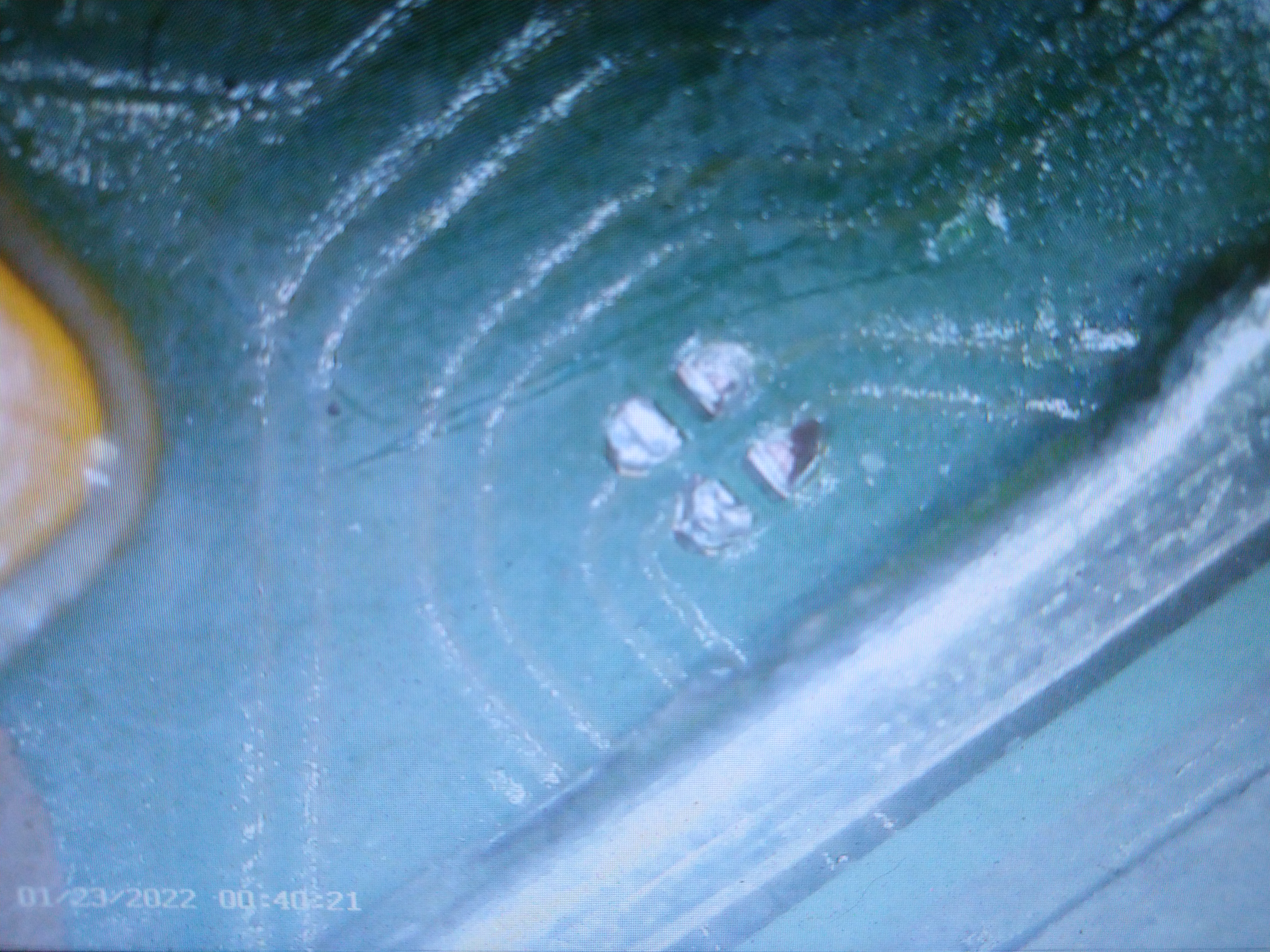

I would check this caps:
Came across your post after searching for anyone stuck at the Switch logo. Looked at the location you mentioned and saw missing caps but the solder was left there. Trying to fix a Switch that I abandoned over a year ago because I put a mod chip in it and then like 10 minutes later the thing wouldn't boot and gave an error. Thought the NAND was corrupt and kept trying to fix that, but then one day the Switch stopped charging and gave up after I replaced the M92. Came back a year later and found the new M92 was shorting one pin to ground. Put a new M92 in and now the Switch charges, but doesn't boot. Followed and NAND rebuild guide again and was stuck at the Switch Logo, where as before it was the Nintendo logo. How important were those caps? I think someone repaired this Switch before me but why would they remove the caps?
Without the both caps the SoC will not communicate with the WiFi chip and so will stuck at the Switch logo.
It is easy to kill this caps while try to remove the shield for the SoC.
I put new caps and it's still stuck at the Switch logo. It boots into Hekate just fine. Is there anyway to figure out what's wrong? I did try Level 2 restore, but I haven't tried Level 3. You think Level 3 could fix it?
show your new caps orientation after you put on
Sorry for late replay but I got a photo of the caps I put in. I tried to boot the Switch into LineageOS to see if the wifi chip was bad and it was stuck looking for bluetooth devices. I heard if the wifi chip is bad that it could prevent the Switch from booting, but removing it would let it boot. Now the touch screen doesn't work except the top right side. I removed the mod chip to see if it'll boot normal, and still stuck at Switch logo. Here's a photo of the wifi chip itself. Grey pads are a bad connection?
