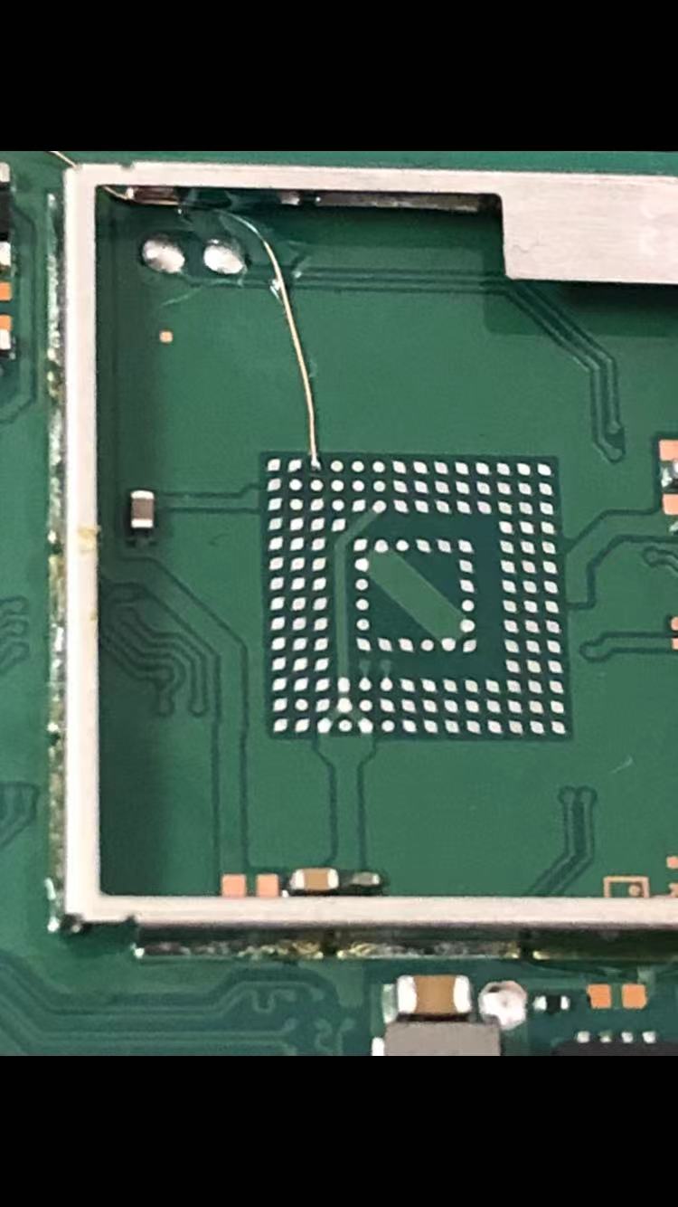

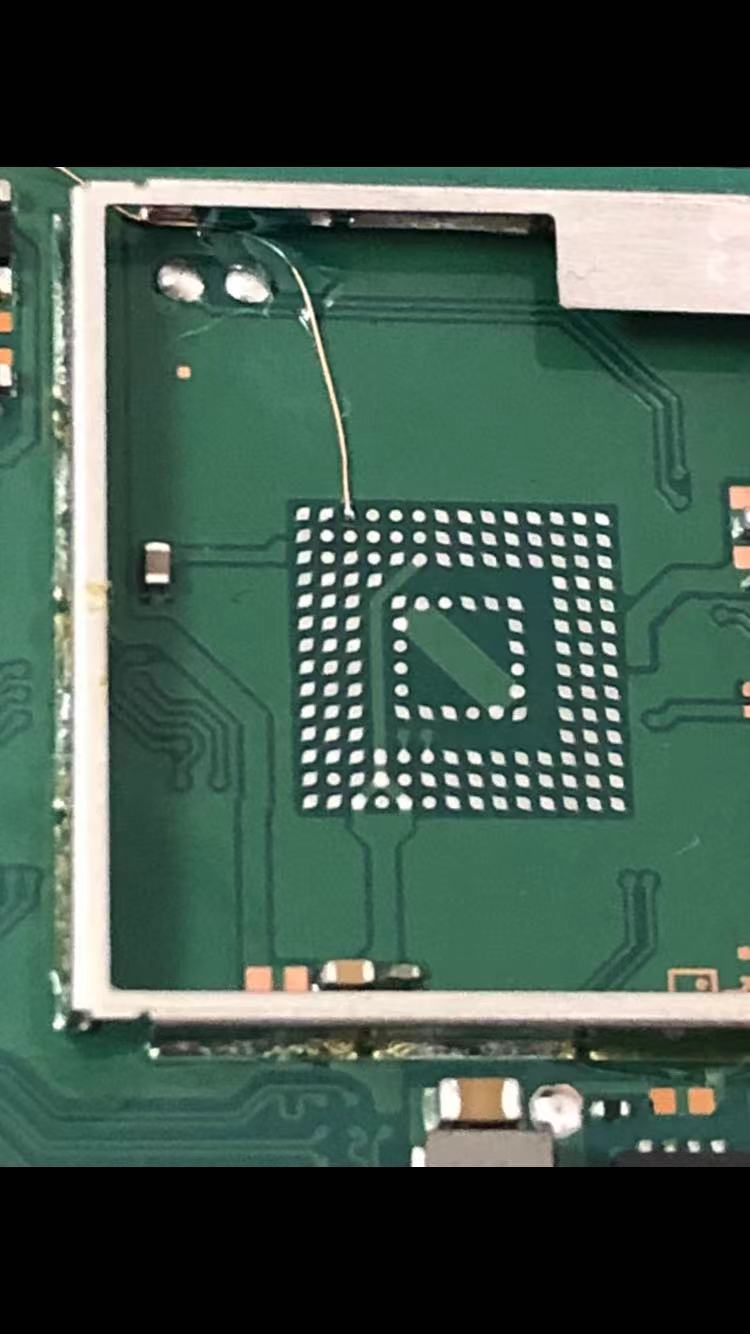

hi guys. it is my first post here. i Hope i can post there. i have a problem guys.. After modding something likes 50 V2 switch, i try to mod an oled switch with sk hynix Memory. i do all and It work like a sharm for 1 month. now sometime when i go to sleep and i shut off the console, the morning after, when i power it on, he start directly in ofw and the led show 1 long and 1 short Yellow light = dat0 missing point. it happened the last 3 days of 5. before, It glitch fast and fine everytime. for now i try to flash the 2.74 firmware and the 2.73 and i force the chip relearning but nothing seems to change. if i retry, after some reboot It start and all work fine and i can reboot many time with no error but the morning later i can get the same error. Is a firmware issue or i need to resoldering the dat0? when i solder It, i'm sure i push It good in place and i test It with a multimeter and all works fine so i dont think is a soldering problem. i not have photo here but i follow this video guide and i use the same rp2040 clone chip from AliExpress.
i Hope Someone can help. tnx in advance and sorry for my bad english

update: i got the same error and i disassemble the console, i try the c connection with a multimeter and i have no contact, so i remove the old dat0 adapter and installed a new One with 4 anchor points and now work fine so this Is a hardware problem. i test It on this month but i think is good now with 4 anchor points. tnx to all guys👍

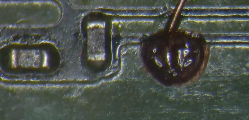

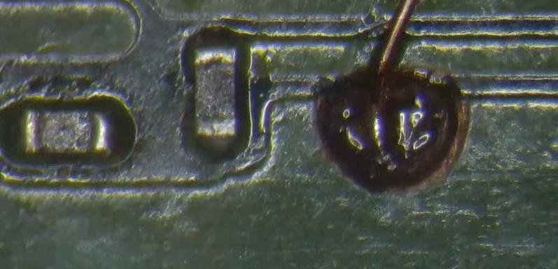

It can also have 12 anchor points, as soon as the hot and cold blows loosen the contacts you may have the problem again.
Reactions: jkyoho

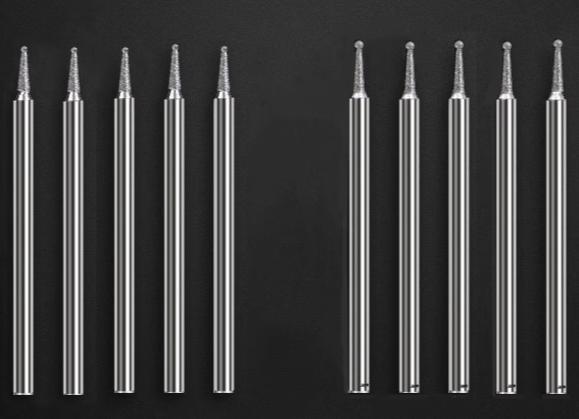

really? so kamikaze method Is the only One that It work... in that case what dremel i Need to buy for get the job done? tnx in advance
Any dremel will do, but the most important thing is a microscope and a suitable grinding head, 0.5-0.8mm is best. Remember that it is almost impossible to succeed without a microscope
