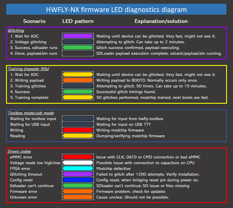

According to this it point to issue with CLK, DAT0, or CMD connection, or bad eMMC, in your case it is probably DAT0 like you mentioned.

So I thought this graph meant the red light would stay on if it was the eMMC error, but mine blinks. That's why I was confused
DAT0 apply to this, since you said it is possibly DAT0, outside of toolbox mode the only way it flash red is those specific problems.
Ah okay, so it's the colour that matters when not in USB mode nor Glitching, but not if it's blinking or not
