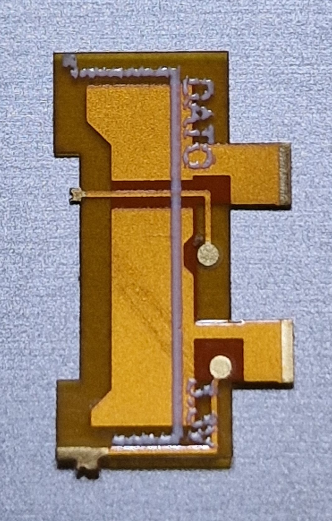

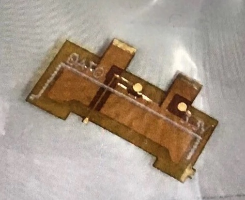

1. Well normaly you prob when you install the qsb and you prob in order to know if the qsb is installed correctly, so yeah of course you prob before soldering the wires or you can prob now but take wires out first
I never recommanded that qsb from the v4 oled because you can really damage your emmc

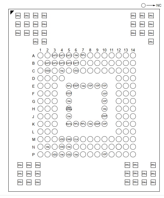

If you check the data sheet you you probably shorted dat0 & dat1, it does work for a short time but then leaving this short for few hours with switch on would for sure kill the emmc,

So first thing i would do is take out the qsb, check what happens but i think you will still have blue screen

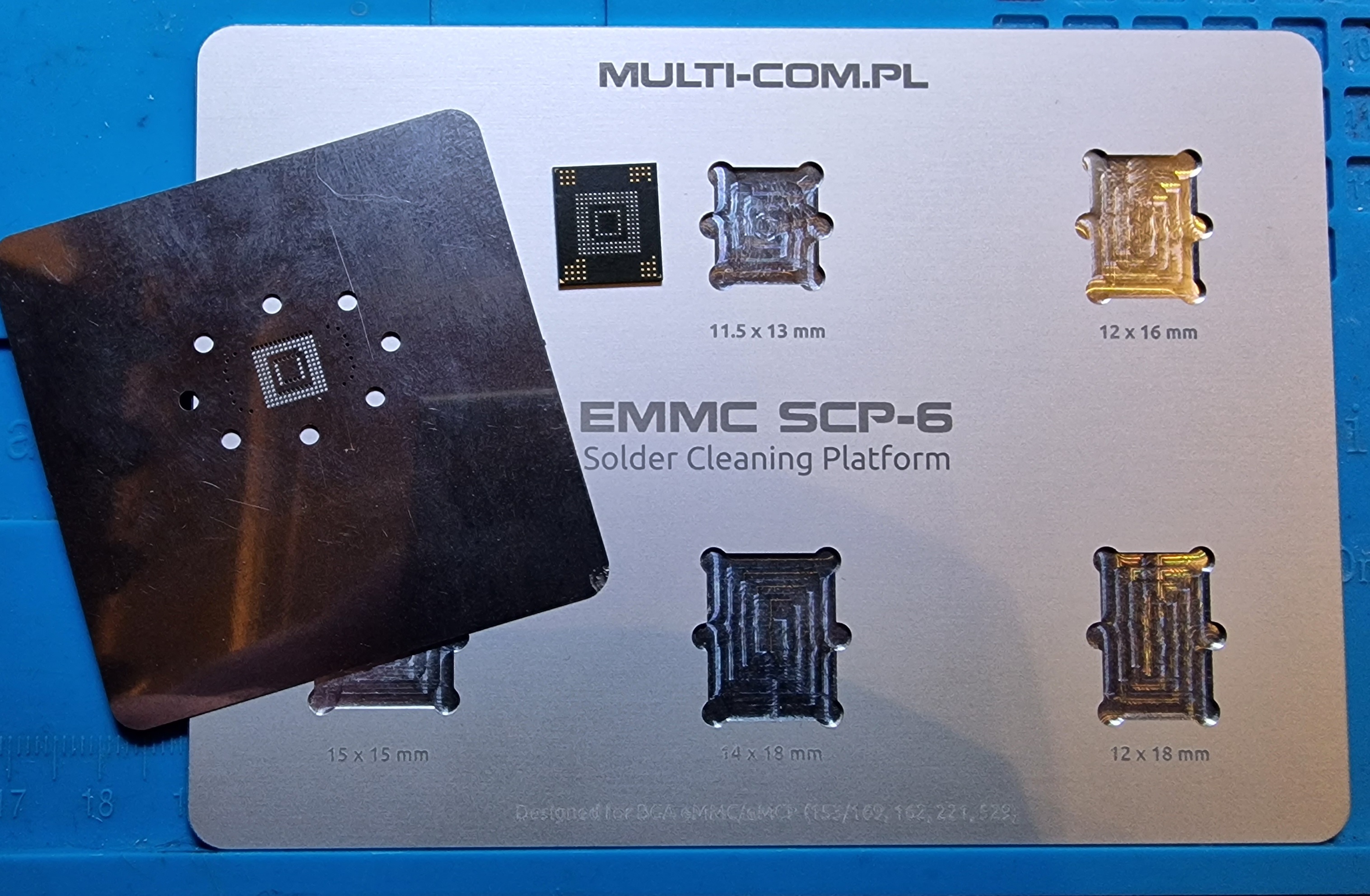

Second would be to get a EMMC and replace the old one, i HIGHLY recommande you to get this stencil and system to block your emmc else its just almost impossible to reball and you cannot reball just using solder on each connection)

Oh last thing for the QSB i recommande highly this one (not the first version with on it written ALLIGN ME!)
This one you can almost not install it wrong, since the balls from the emmc blocks it in the exact place, then you just prob and verify the diode value to GND and to 3,3v, if values are good solder ir where you cut the shield out and it wont move, don't need to glue it

2. I agree, I might have easily shorted the DAT0 and DAT1 points during QSB installation as I didn't have much experience. I only verified the diode value to GND, not 3,3v.

3. I also ordered a new QSB, very similar to one you suggested, hope it will do the trick next time:

5. In case I need to replace the eMMC chip, where can I find a replacement? I searched eBay and AliExpress for "switch emmc" but only found 32GB boards for original Switch. Also what other equipment to I need to do it? I currently only have a soldering station with a heat gun.
