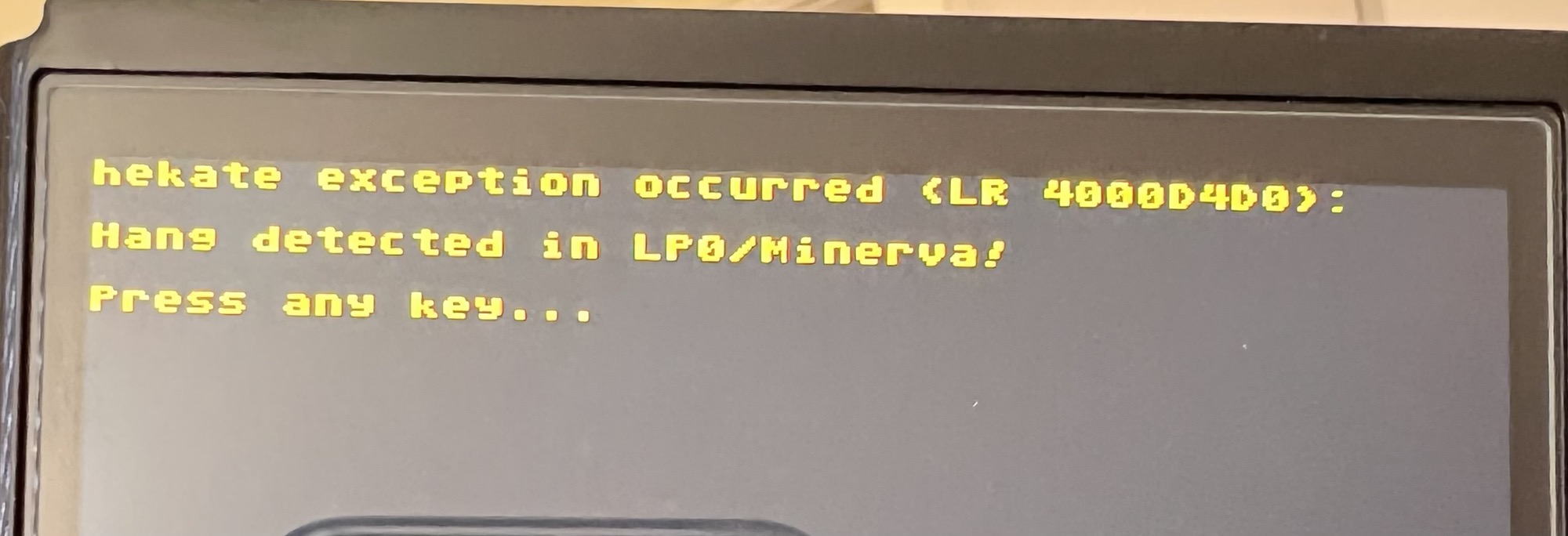

I'm having issues with my freshly modded Switch OLED.
It was working and booting fine as soon as I installed the modchip but it was late so I shut it down and put it on charger for the night. The next day I went to install a larger SD card and got an error message. I've tried the old card but that didn't help. I've tried several other known good cards with no success. I've opened an issue in the hekate github repo and got a response that it's either fake or corrupted SD card or the SD connector itself (Update: contacted CTCaer directly and we came to conclusion that the issue is with one of the RAM modules). I don't think it's either one of those since I've been using tested good cards and opened the Switch and carefully inspected the SD connector and found no issues, all the pins look fine, nothing is bent or damaged.
Since I couldn't make the modchip work I decided to disconnect it. I desoldered and isolated all the wires from the chip and tried to boot the console. Got a blue screen. Tried to boot it holding the VOL+ and VOL- buttons but still getting the blue screen.
I'm not sure if simply desoldering the wires from the chip is enough to properly unmod the Switch but I couldn't find any proper instructions online.
Is there a way to make my Switch work again?

Your problem may be no the same, if you are getting the SD Card error your Console is injected with payload, you are missing some files on your SD Card, try to download Hekate from Github and extract the files ON SD CARD ROOT then try again.
No. The problem is not the files on the flash drive. When formatting a memory card in ExtFat, I get the error "hecate exception occurred LR 4000d4d0". And with Fat32, what is in the photo above.
Everything turned out to be much easier. On examination, a broken track to RAM was revealed. After its restoration, the stock started. Campaign when the Screen broke accidentally hooked.
