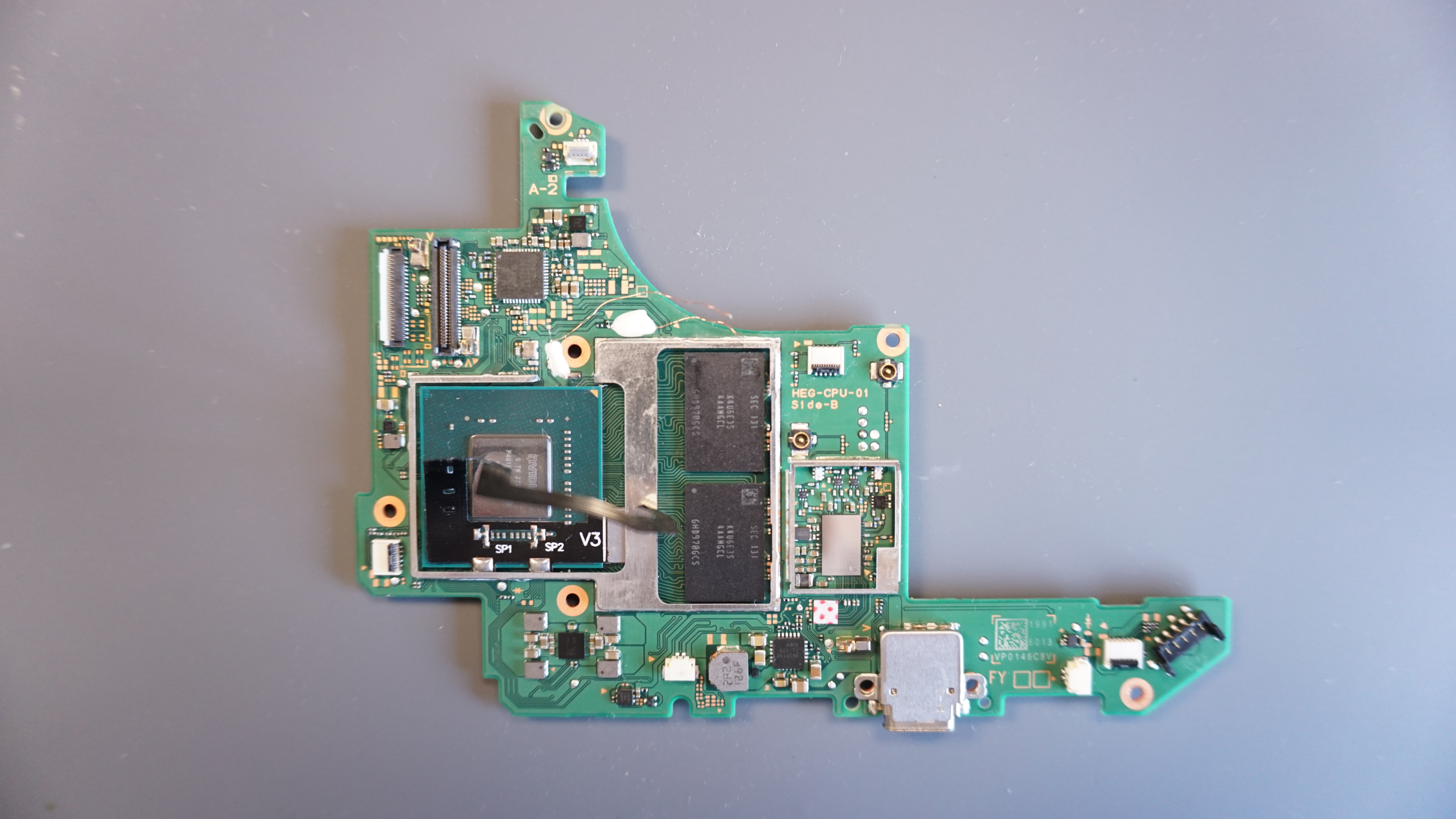

I'm having issues with my freshly modded Switch OLED.
It was working and booting fine as soon as I installed the modchip but it was late so I shut it down and put it on charger for the night. The next day I went to install a larger SD card and got an error message. I've tried the old card but that didn't help. I've tried several other known good cards with no success. I've opened an issue in the hekate github repo and got a response that it's either fake or corrupted SD card or the SD connector itself (Update: contacted CTCaer directly and we came to conclusion that the issue is with one of the RAM modules). I don't think it's either one of those since I've been using tested good cards and opened the Switch and carefully inspected the SD connector and found no issues, all the pins look fine, nothing is bent or damaged.
Since I couldn't make the modchip work I decided to disconnect it. I desoldered and isolated all the wires from the chip and tried to boot the console. Got a blue screen. Tried to boot it holding the VOL+ and VOL- buttons but still getting the blue screen.
I'm not sure if simply desoldering the wires from the chip is enough to properly unmod the Switch but I couldn't find any proper instructions online.
Is there a way to make my Switch work again?

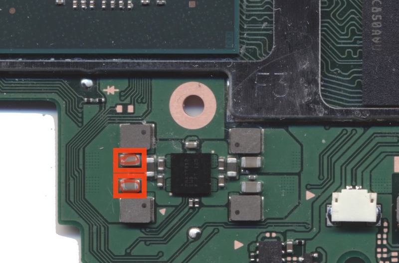

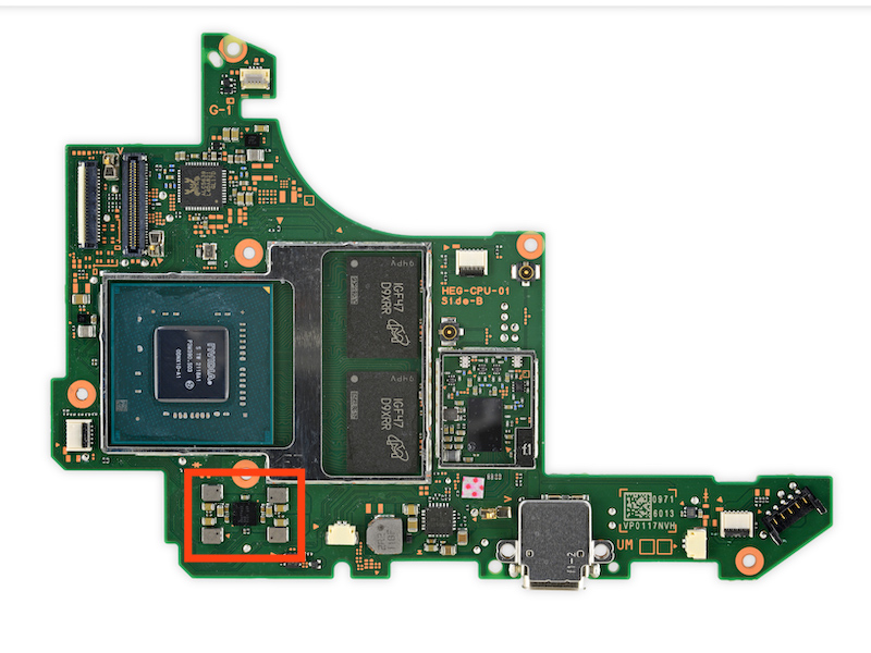

Are shorted capacitors I posted above normal or not?
I was thinking did you check the circuit and look if maybe you didn't hit a component ? Or maybe drop some soldering tin somewhere (never know just asking...)
Also i checked and those caps they seem shorted but in fact ehy have 15-18 ohms not shorted 0 ohms, so they seem shorted when you check diode with a multi-meter

Thanks for clearing things up about the caps, I didn't think to check the resistance values, only checked them in diode mode.

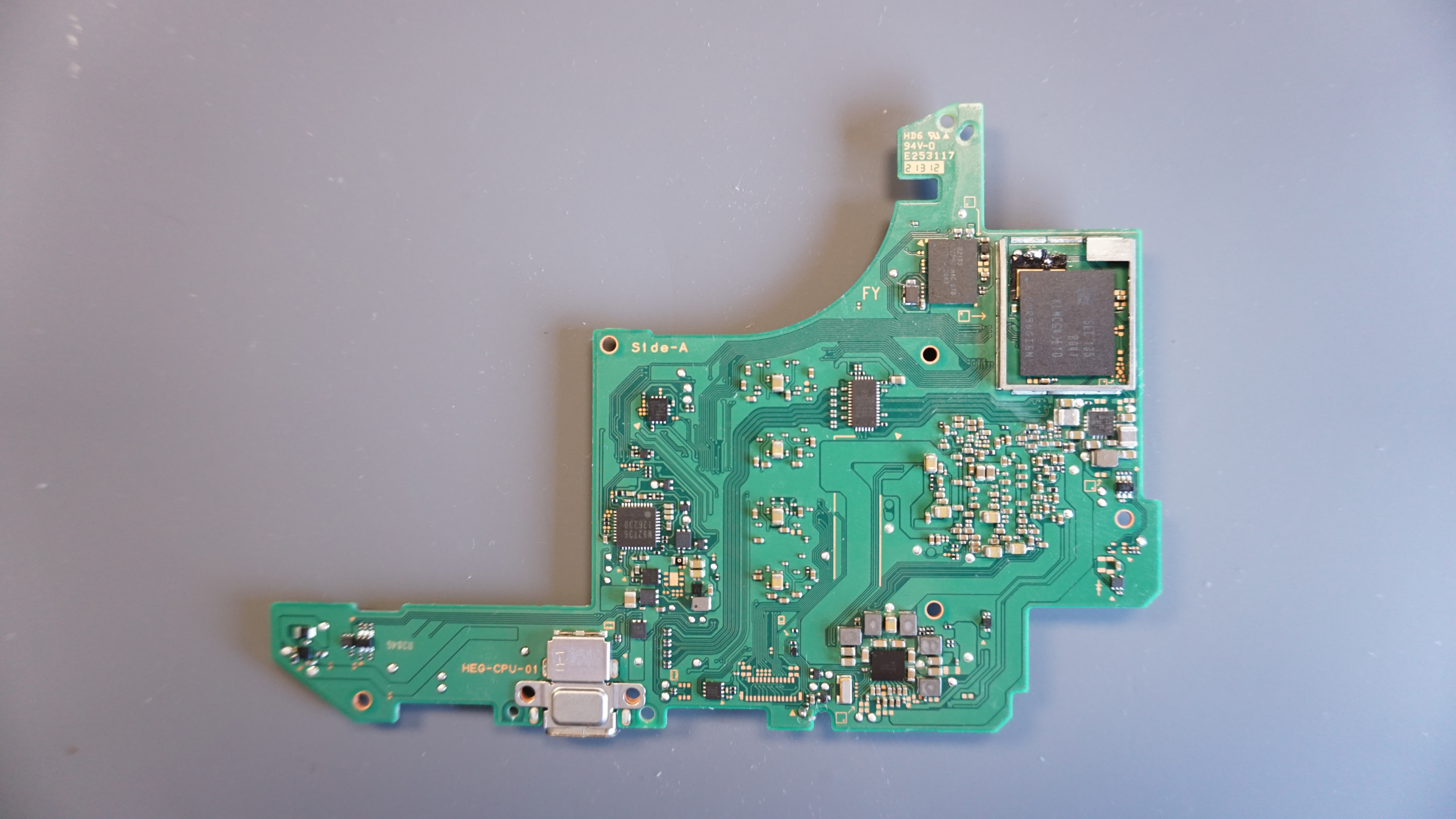

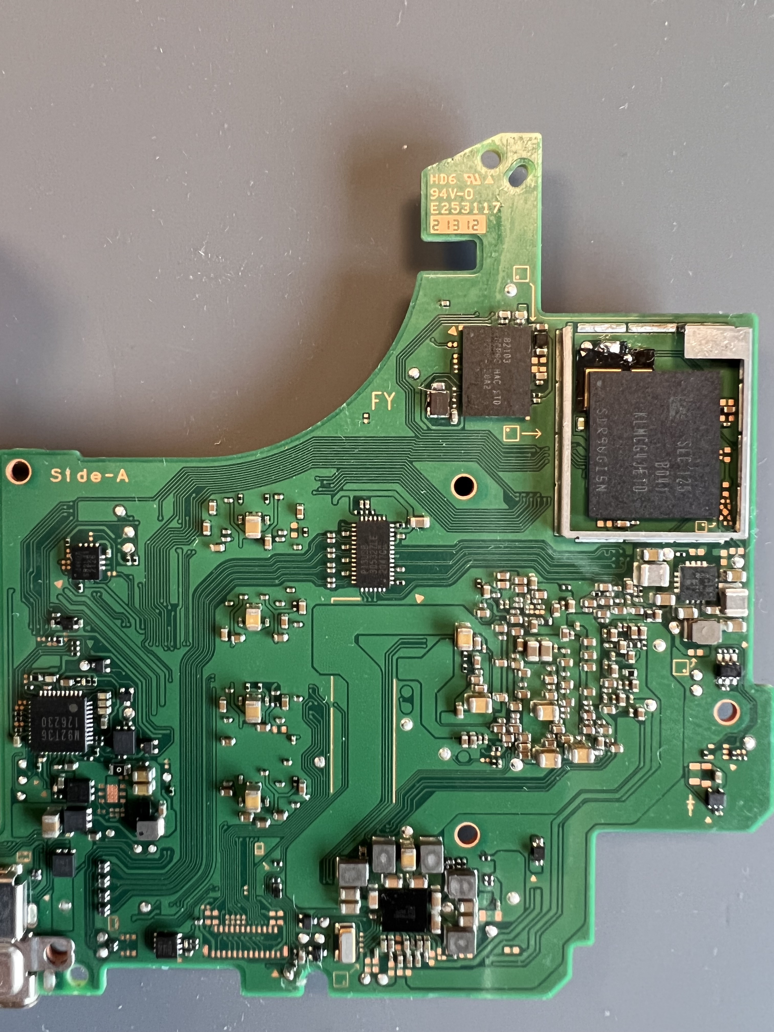

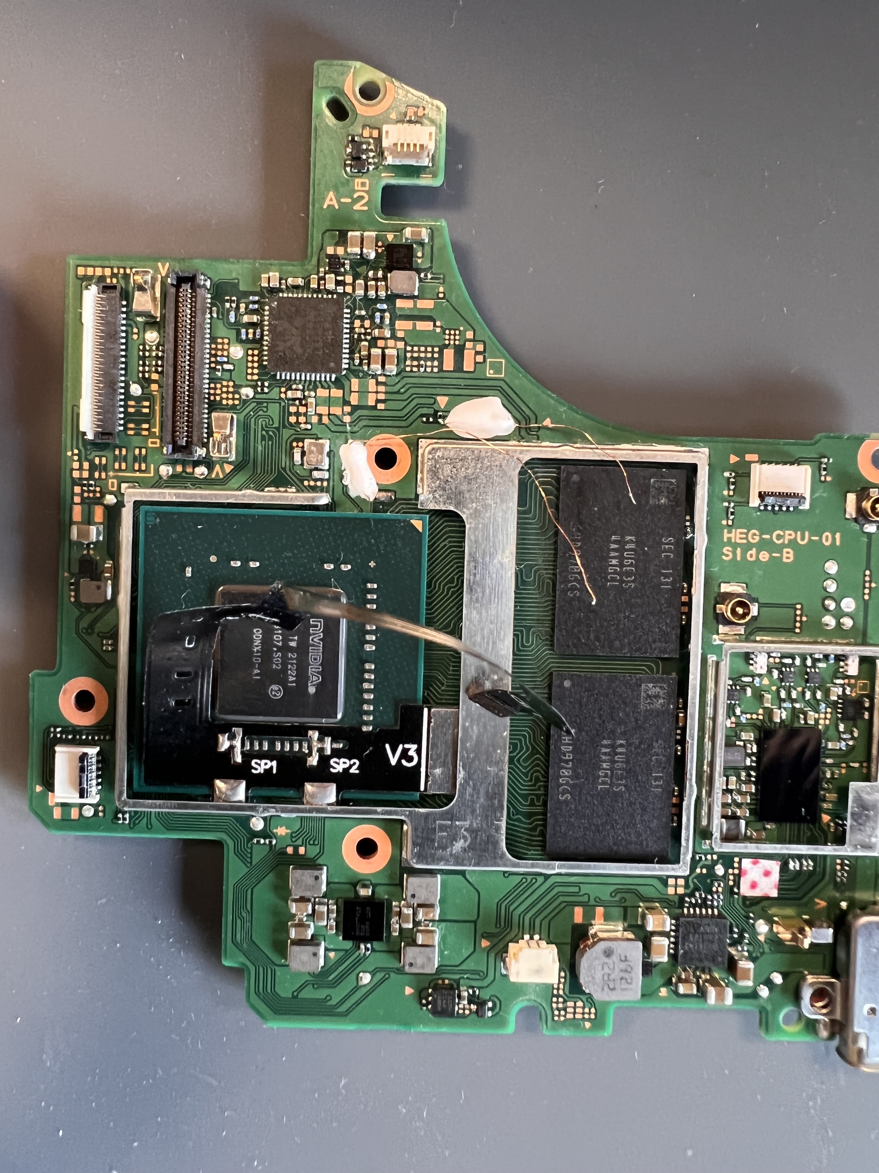

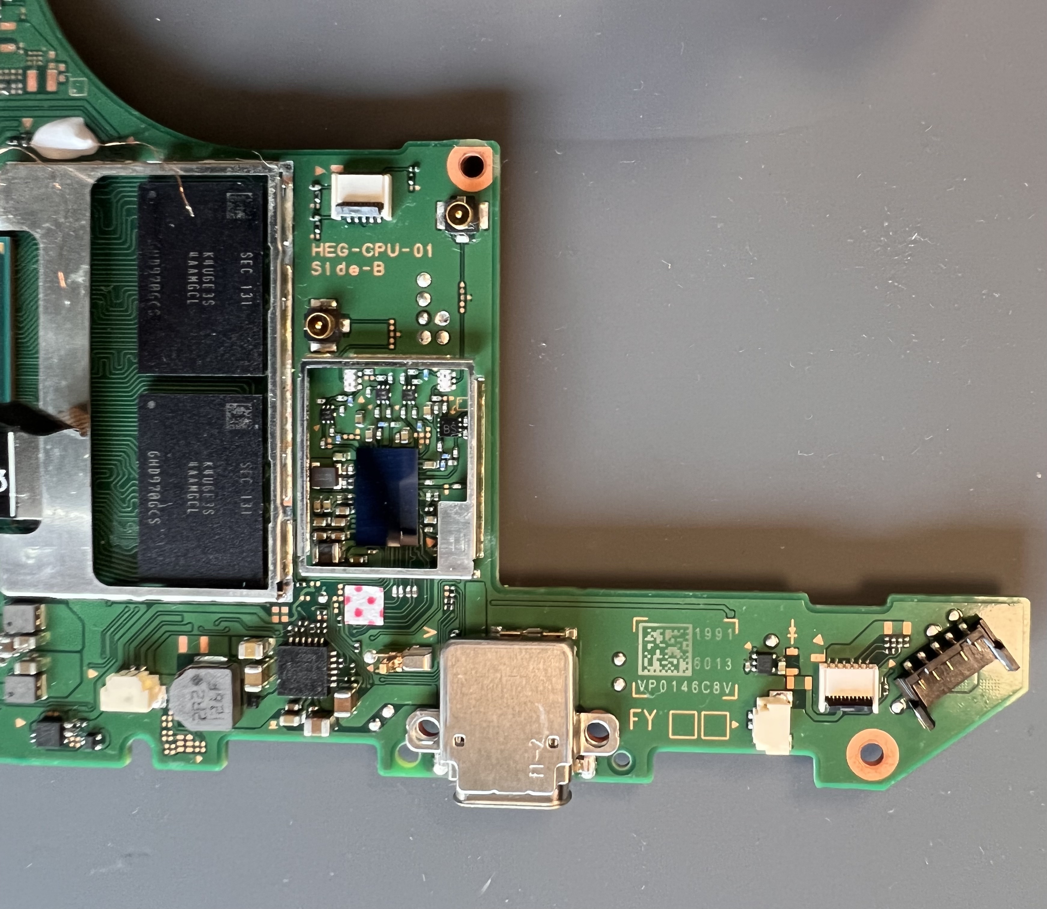

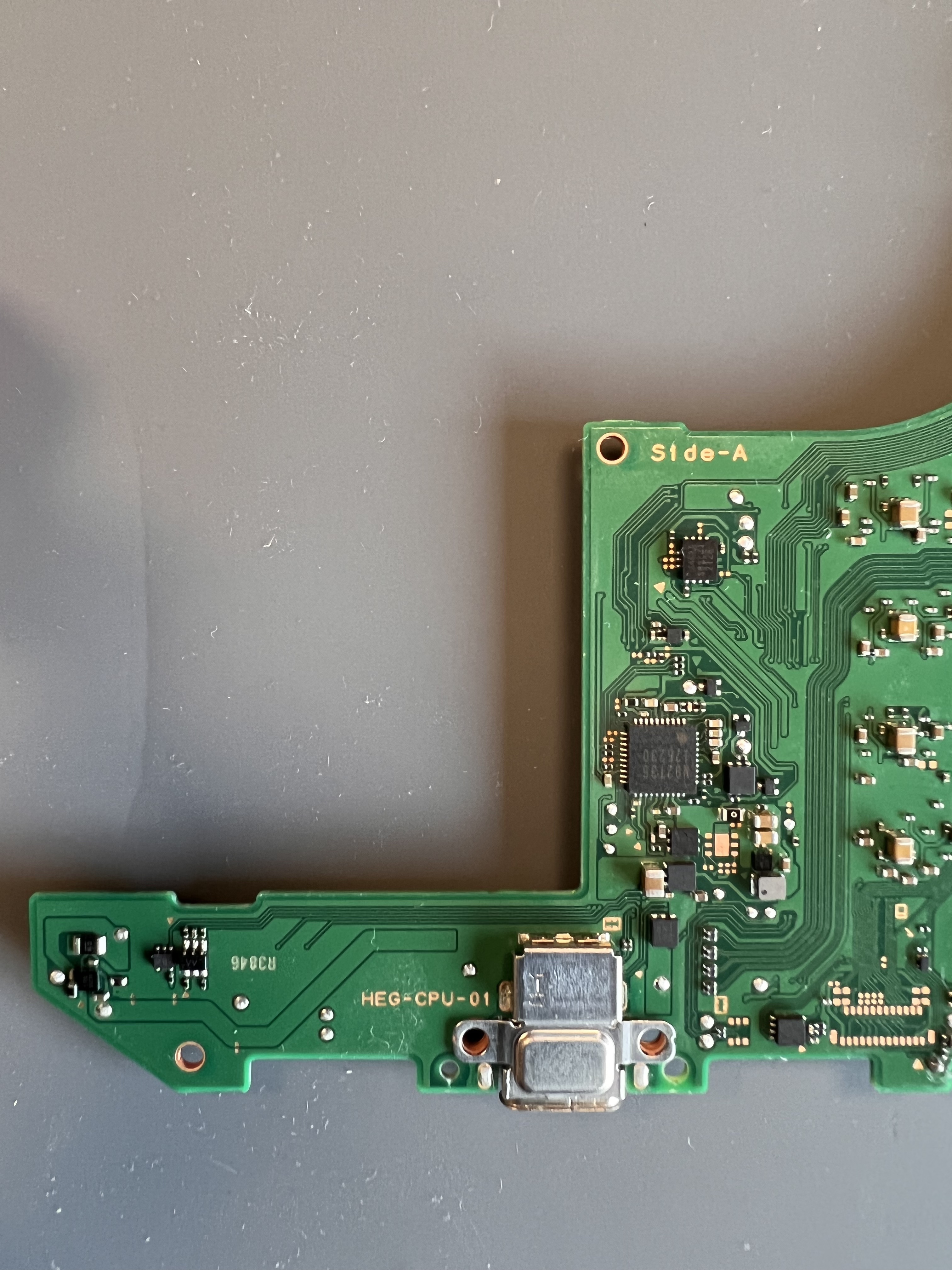

I'm attaching the photos, that's about the highest quality I can do with my equipment. Let me know if more detailed shots of some areas are needed.

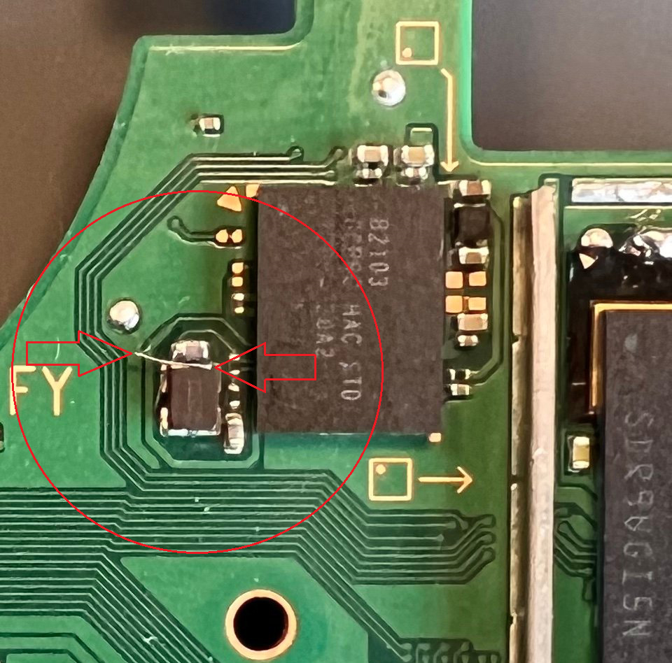

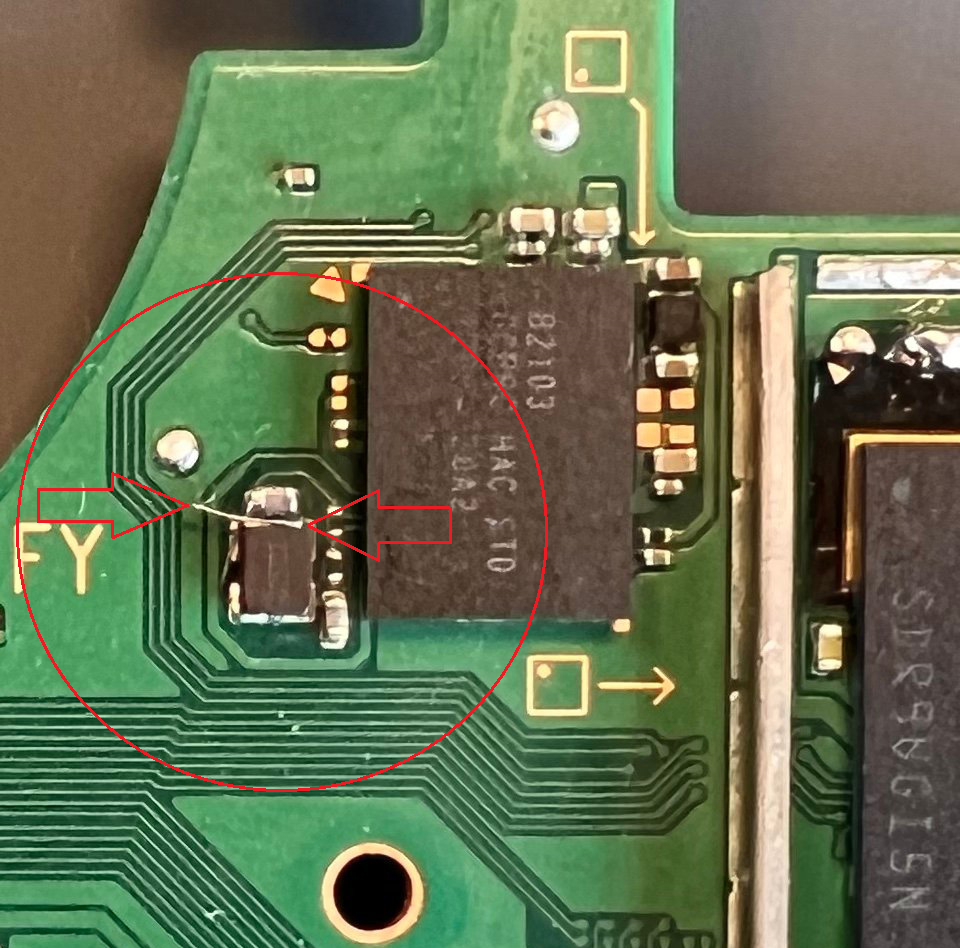

Ok, didn't see anything wrong except one thing that looks strange, i don't know if it's metal but if it is there on the oscillator then it could be your problem, but the quality of the picture doesn't let me see what this thing is...
Reactions: RubyRoid
Hey, nice catch! Unfortunately that's just a piece of junk stuck to the board from my bench while I was taking photos. I also inspected the board myself and couldn't find any other issues or shorts.
At this point I have no idea what to do next with the board. I've ordered proper flux to reflow the APU but I'm now sure that will help.

I did try to remove the DAT0 QSB already and that didn't work. This time I did it again and also removed all the wires and the ribbon cable from the APU:
That white stuff wasn't glue by the way, it is UV solder mask, and it hardens really fast.
Anyway, with all the modifications reverted I still get the blue screen on power on :(
