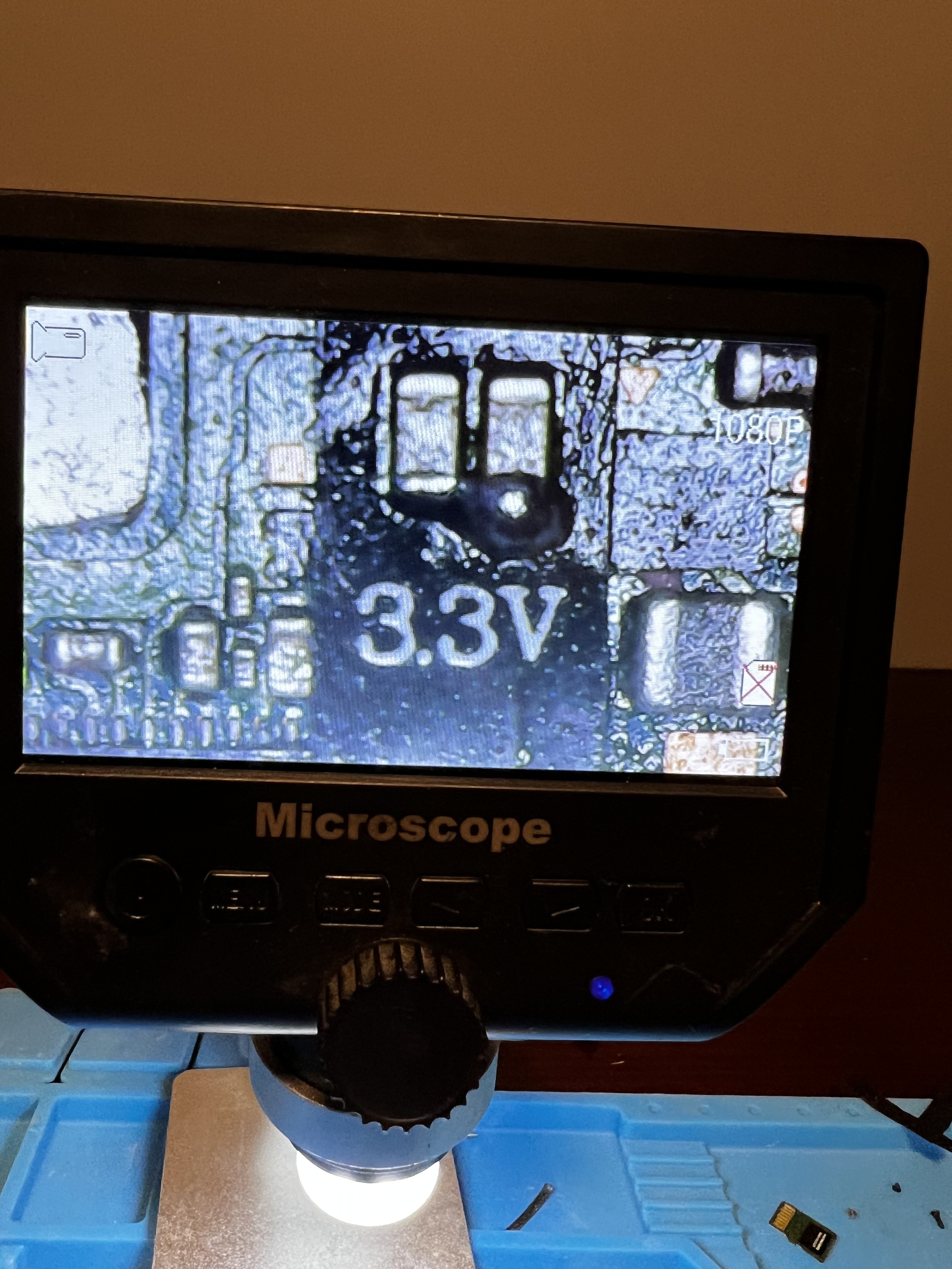

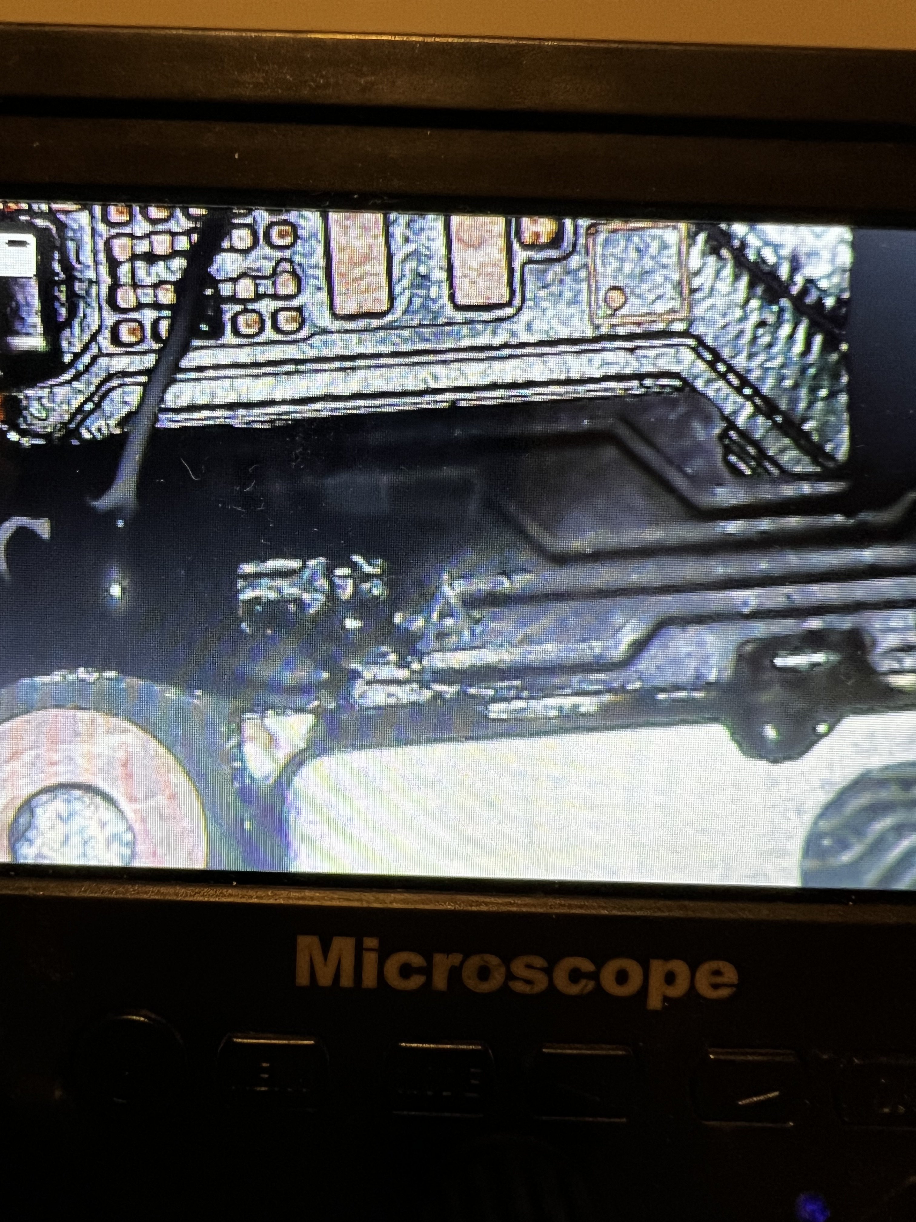

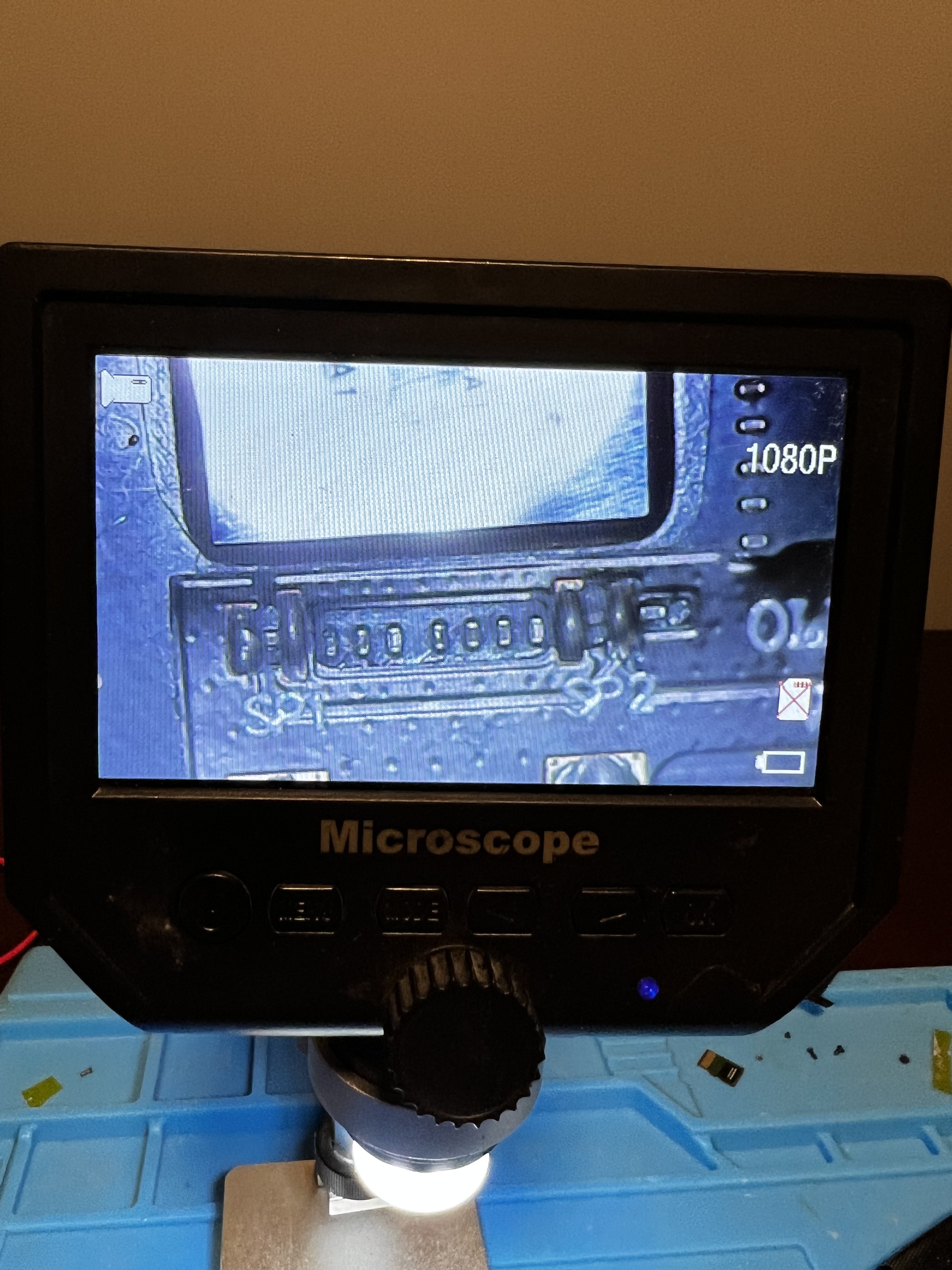

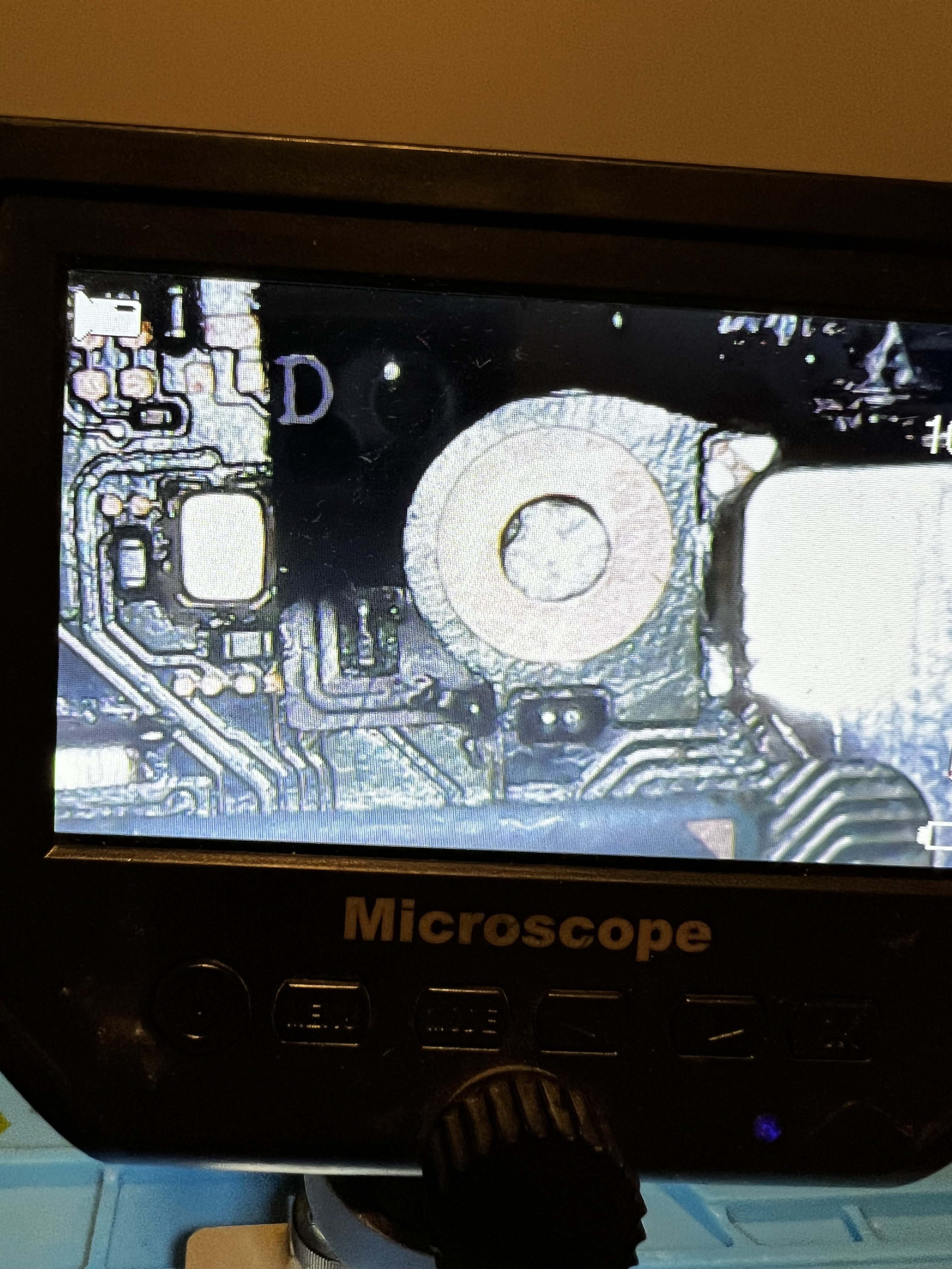

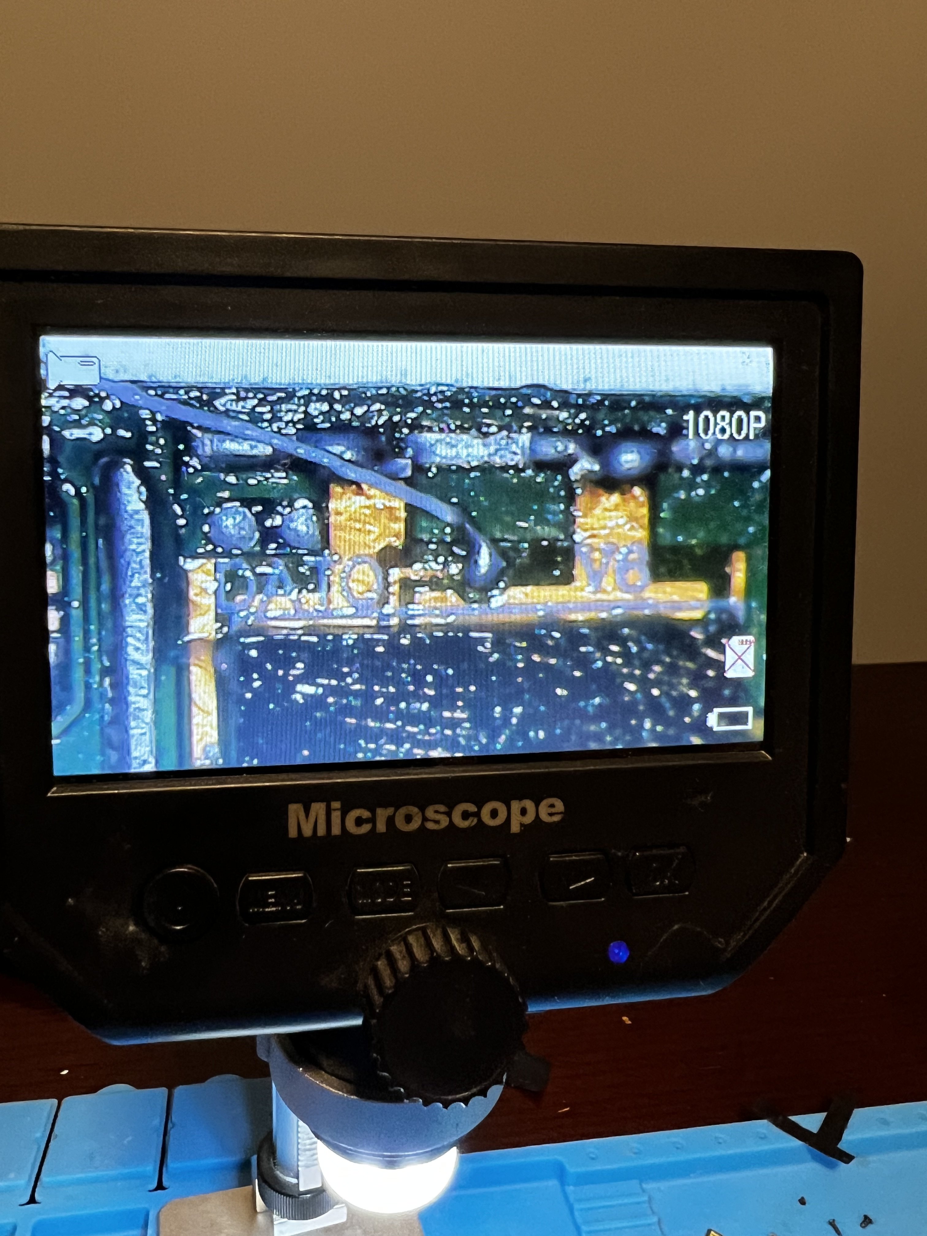

Hello guys,

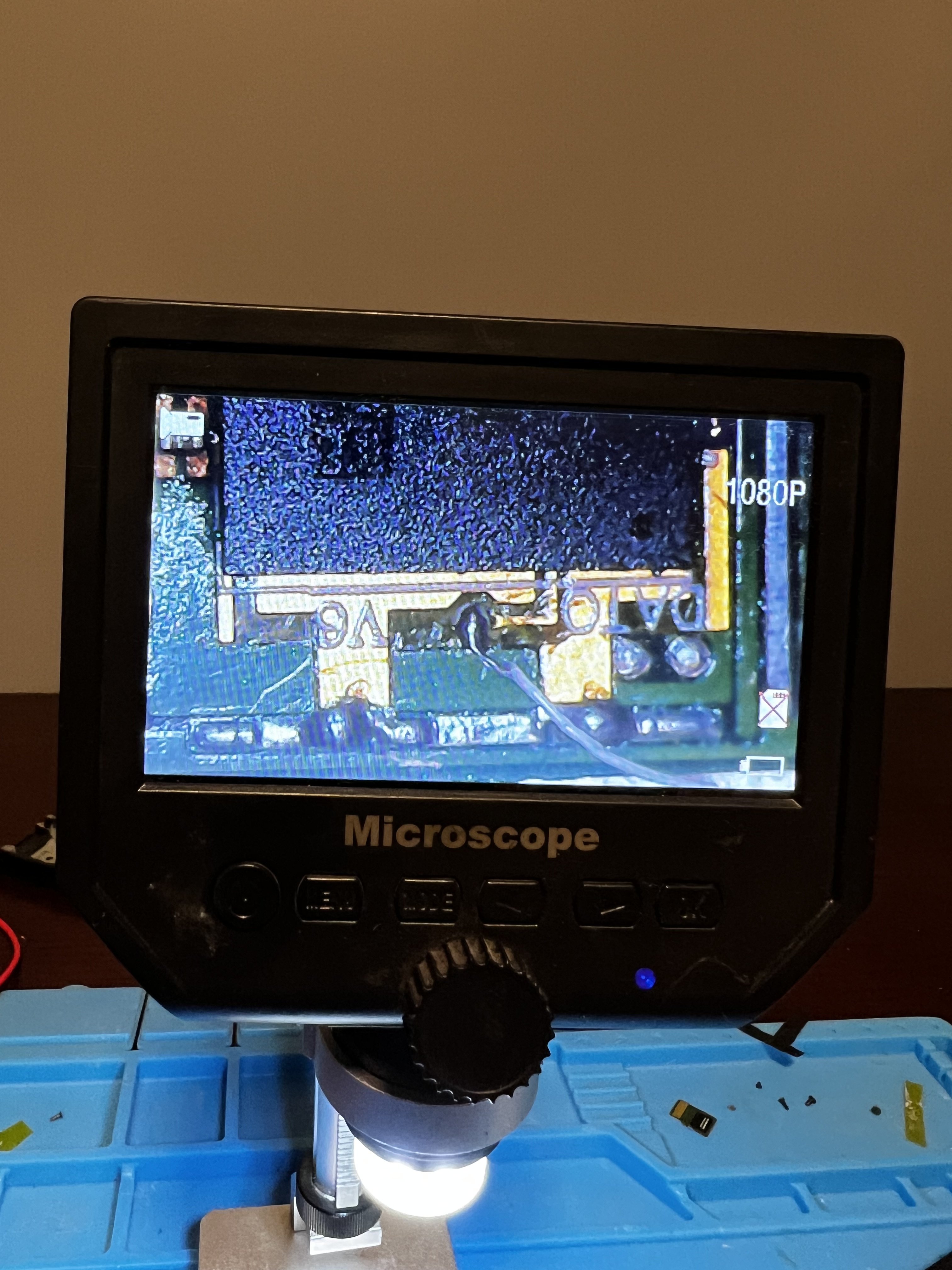

Got a quick question as i just modded my oled switch with instinct v6 black everything was fine untill the morning i found it frozen and randomly shut down, so formatted the card and tried again all went well even nand dumped fully.
A few mins later decided to restart the device and the instinct turns to white, redid the whole solderjob again and still the same issue.
Below are the readings as far as i recall.
A 0.5
B 1.5
C 0.5-0.6
D 0.5
I attached the photos as well i dont know where to look.
Appretiate an extra eye maybe im missing something that is my first instinct used to do hwfly with wires.
Update on the readings
A 0.475
B 1.5
C 0.65
D 0.65
Regarding 3.3V im not getting any readings but chip is powering on as the video i shared.
Shall i jump the wire to the chip directly

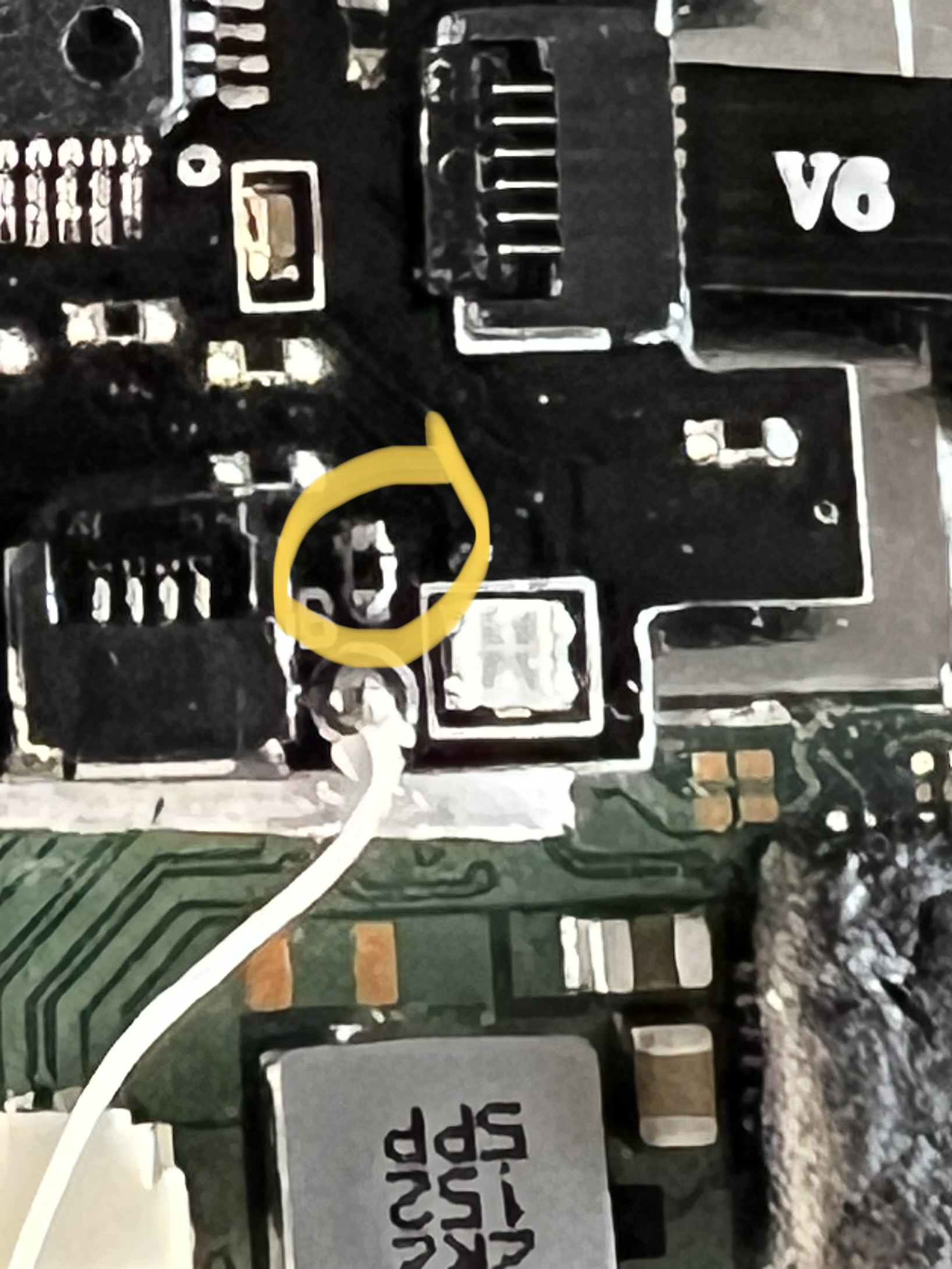

Could you elaborate what you mean there's no reading at 3.3v ? Are you getting shorted there or what?
Also your CPU caps seem displaced
Check whether your console boots OFW first then you can go from there
It is booting ofw no issues.
When i test the reading at the 3.3v cap i used to get 0.7 reading now its nothing and not shorted no.
Tested the 3.3v now im getting a reading of 0.4
Seems a bit low.

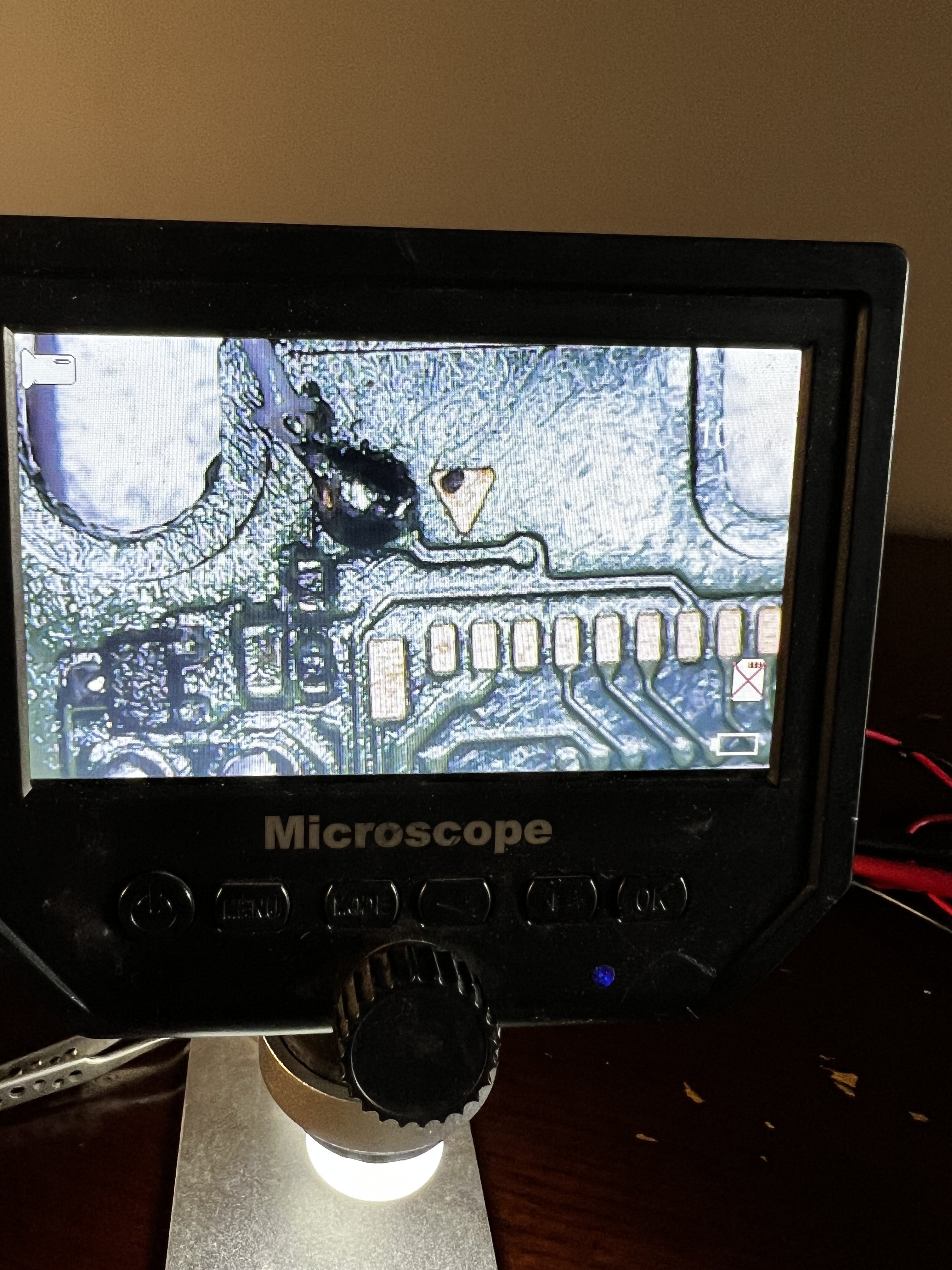

Update i am getting readings on all points except B which is weird, but im getting a 1.1 reading on the cap on the chip above B, dont know if thats relevant or not.
All your images are washed out so hard to tell what is happening.
RST can cause problems if you don't properly clean that area. The only other issue I can observe is your displaced CPU cap (too much solder but no connections)
I will revisit the sp points but i am getting a reading normally, will decrease the solder there just in case.
But rst point im not getting any reading which is werid.
I will take off the whole qsb as it might be causing the issue
