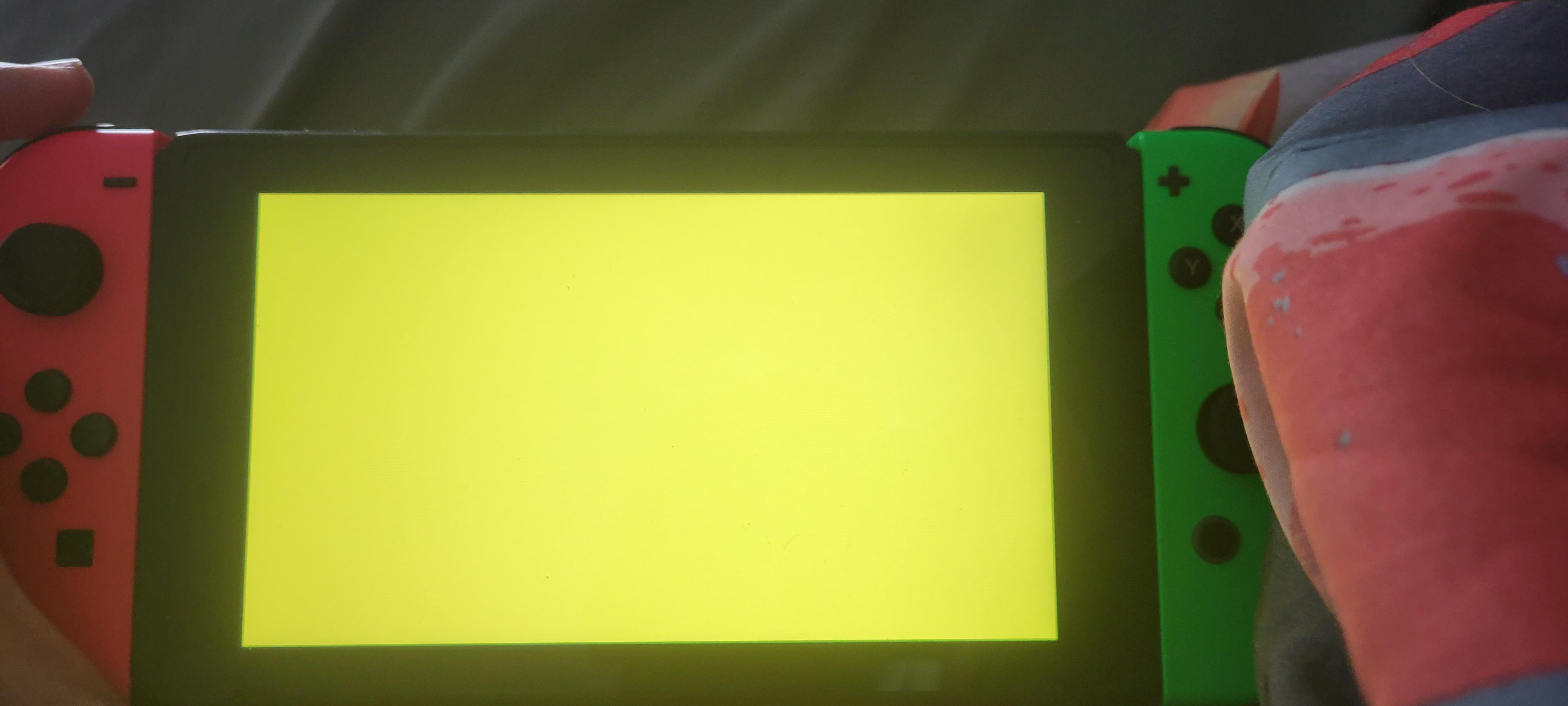

Hey,
I've tried to update my switch on cfw, starting with sysnand, but now I have a yellow screen
I'm sure I've updated atmosphere, hekate and sigpatches so I don't understand...
How to get sysnand back to normal?
Hey,
can you share the yellow screen with us please?
Reactions: Blythe93
It's just yellow I don't know why you need to see it
Reactions: Blythe93
Thanks for your help I will follow this guide.
But before...How can I get sysnand back to normal? emunand is still working tho
