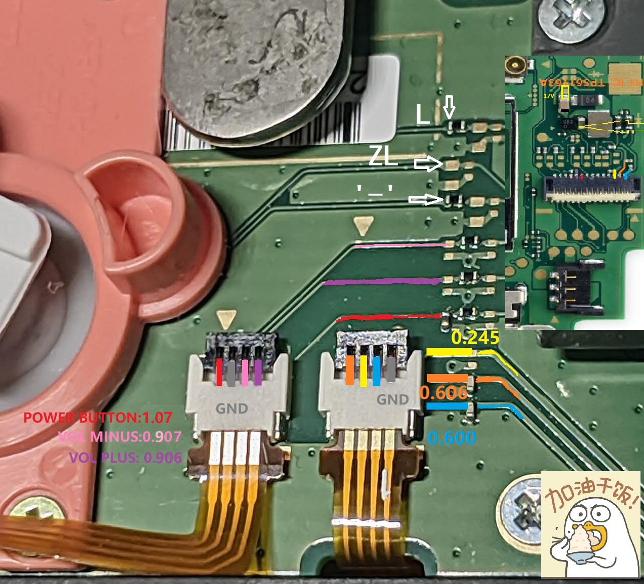

check your diode reading on the backlight cable when battery disconnected

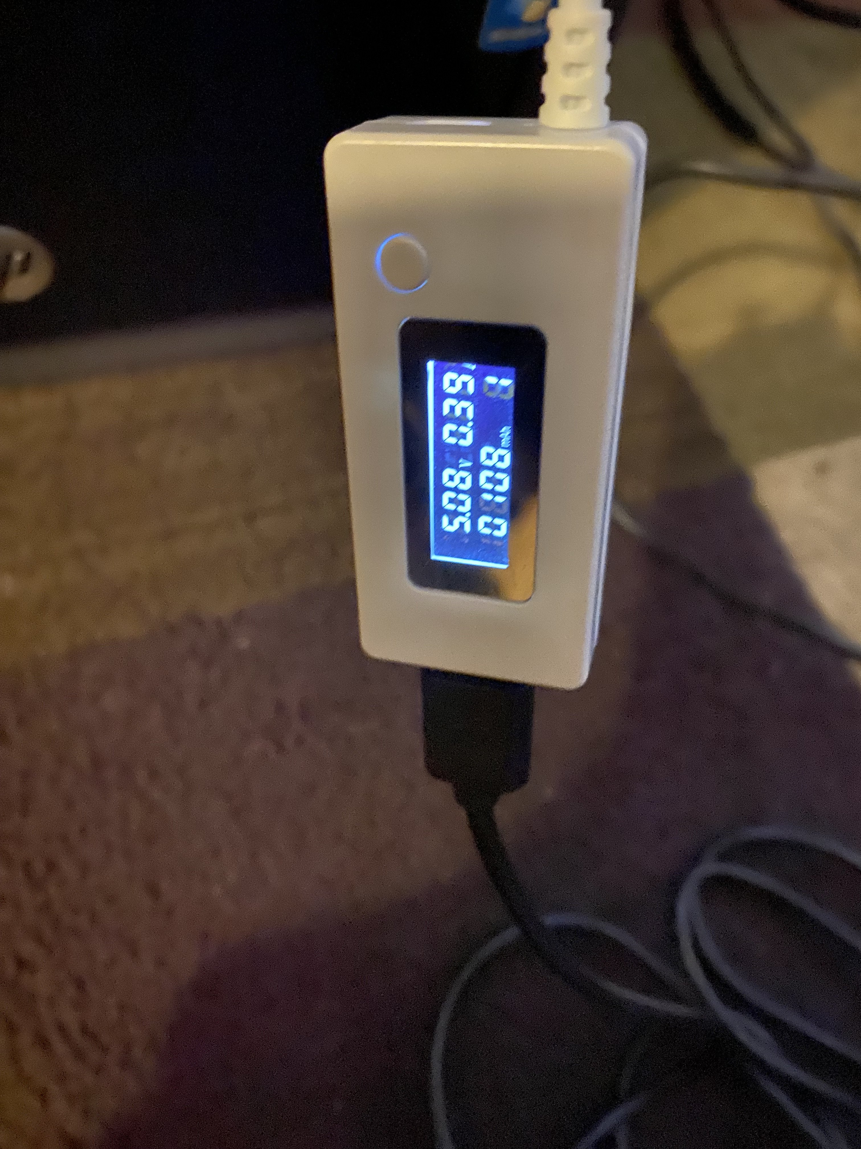

Does this mean the switch is charging I swapped out the port
