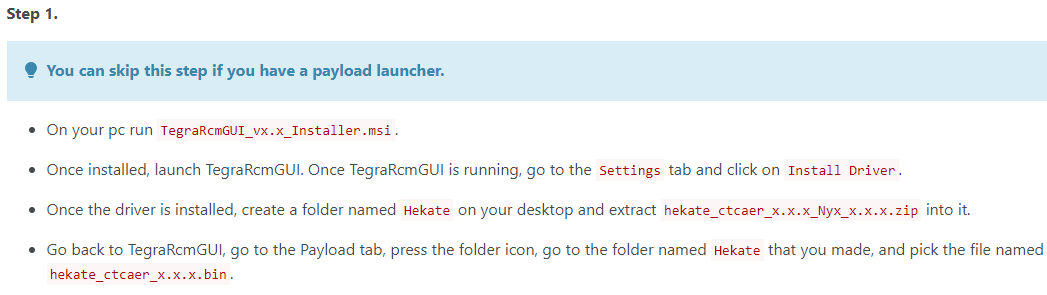

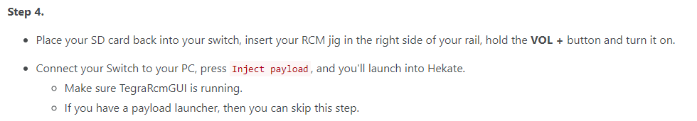

First, read this for some general knowledge https://rentry.org/SwitchPayloadLaunch and then read step 1 and 4 of this guide https://rentry.org/EristaEmuNAND to launch back to your emuNAND, mind that you probably can skip the part of step 4 where it tells you to create an emuNAND, first check if you already have one which is explained later.
Precisely, you need this (download links are at the top):
If something doesn't work, check the rest of the guide from top to bottom and follow it's instructions for setting up, before you then try it once more. If no emuNAND exists (which would be indicated by an E (E = emuNAND, S = sysNAND, nothing = stock) at the end of the update string in system settings), create one.
