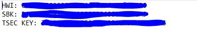

First of all i tried to get the biskey by TegraRcmGUI 2.6
and got the following archive:
here i believe it was my first mistake.

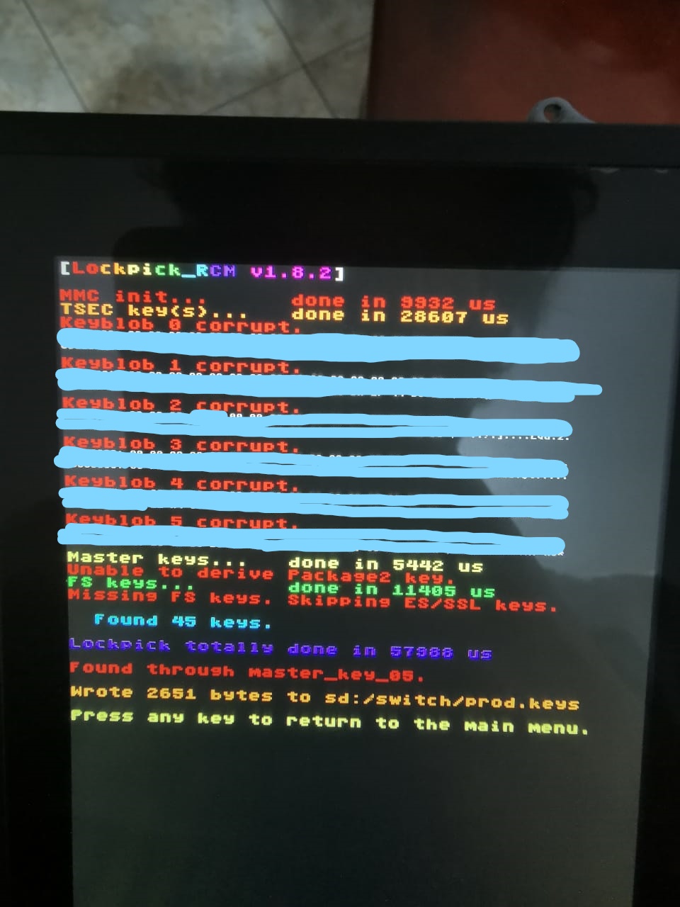

I read some posts here on the forum and tried to use Lockpic_Rcm to try to get the biskeys and I just came across more errors.

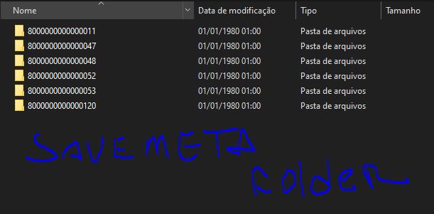

I entered the SAFE folder and as he said in the tutorial I needed to delete everything inside, there was only one file called PRF2SAFE.RCV I deleted it (I made a backup)
In the SYSTEM folder there were 3 folders and the same hidden file PRF2SAFE.rcv (he made it very clear that I needed to delete this file in the system folder)
something i realized was that in the video his SYSTEM folder had a file called "saveMeta" and in my case it didn’t exist, what did exist was a folder called Savemeta, inside the folder there were 6 more empty folders (I made a backup anyway )
I deleted the content folder as he said and copied two new folders to the SYSTEM drive "content" and "save". after these steps I went to the Users folder and replaced everything with the files he made available in the video. (I backed up everything before deleting and replacing files, I also backed up the nand before trying the whole procedure, even if I had already replaced boot 0 and 1 at the beginning of everything).

About the lockpick_rcm payload, are you injecting it from a computer ? At the first steps I thought that my keyblob were corrupt also but it was because I was running the lockpick payload using SXOS boot menu and this is causing lockpick to act strangely !
Anyway if you fail to generate your encrypted_keyblob_x, just send me a private message with a dump of your boot0 and your keys and I’ll generate that for you and put it in your boot0 dump !

when I use Linkle on prod.keys of the bricked switch it shows me only 31 lines and no encrypted_keyblob. I believe it is completely corrupted
Just run linkle with your prod.keys as shown in every howto (linkle keygen -k prod.keys) and put the outputted encrypted_keyblob_0 - 5 in your boot0.bin at offsets 0x180000 / 0x180200 / ...
That's as easy as that. If lockpick_rcm is not giving a complete enough key file, take one you'll find over the internet and add/replace your biskey in it.
