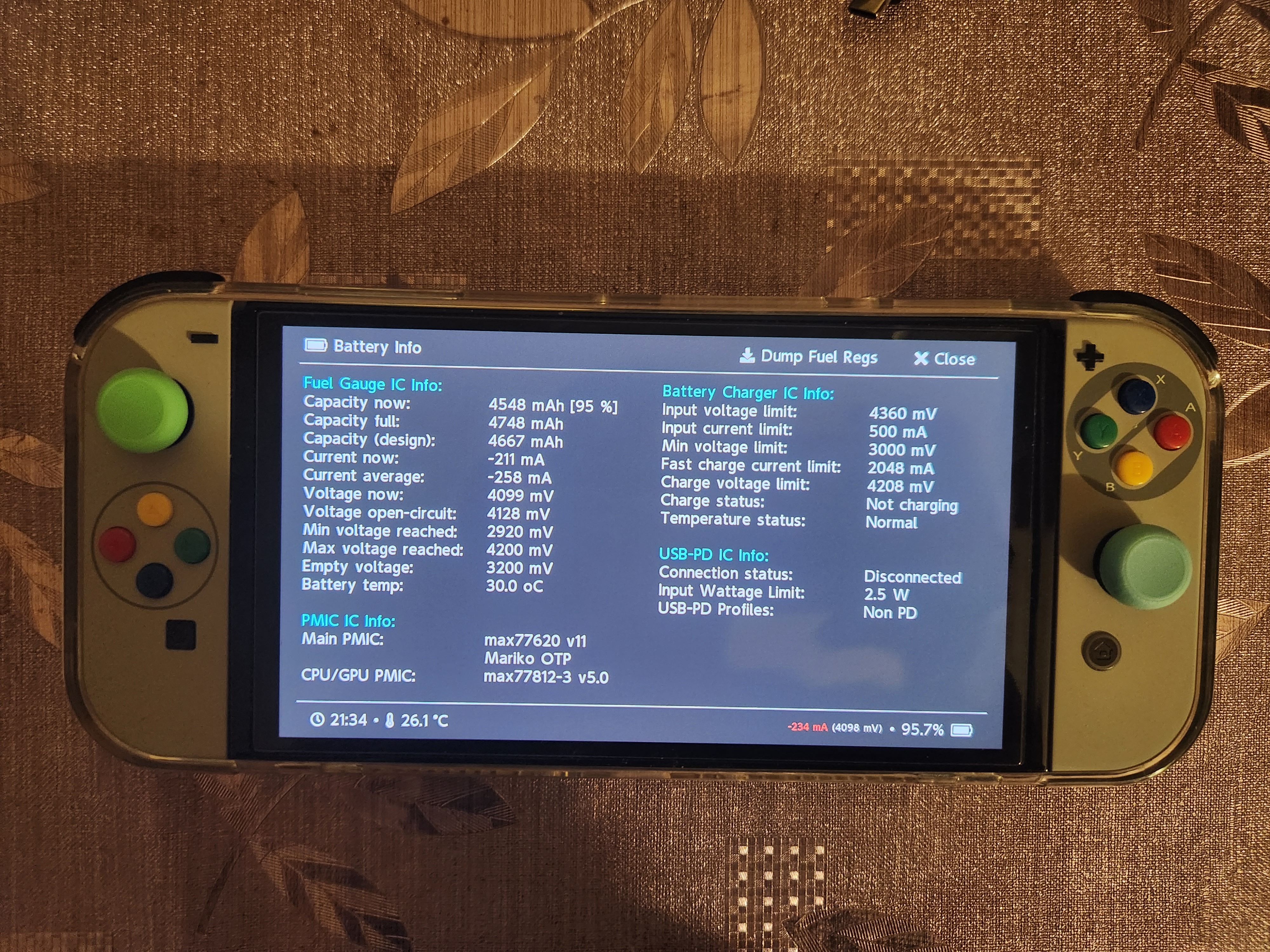

So I've been using my switch and recently this occured, it shows 94% on the home menu but hekate and status monitor insists it's on 80%. When I charge my switch it only goes up to 96% in the home menu. Is this a battery or software issue?
Seems like a software thing, I wouldn't worry much. Also, is that actually Pizza Tower on your switch or just a custom icon?
I'm thinking it's a hardware issue because I explained it to someone on the Nintendo Homebrew discord and was told it was likely hardware related. Also yeah, that is pizza tower...can't say how I got it as that would be mentioning piracy related groups however.

That and considering that Hekate can run on lower power (like, less than 1%) I feel like hekate and HOS might calculate the battery percentage slightly differently, leading to the desync. That or your battery might just be a bit old.

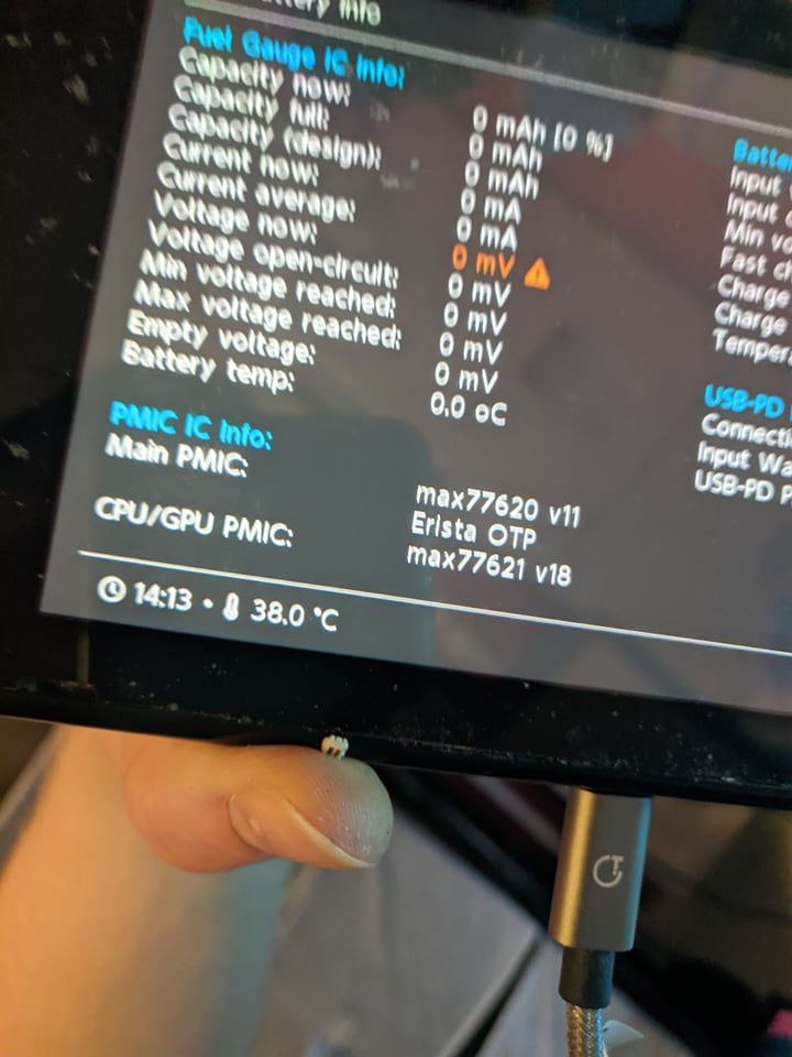

Well the fuel guage isn't working correctly you would get the case of 0 across the left side of the screen, im not 100% sure if it would affect it showing in correct battery percentage. In term of the battery health it looks normal on your.
I'm gonna try swapping a battery from my old v1 switch when my father is home on the weekend, I don't trust myself with taking apart consoles lol. Glad to see it wasn't the fuel gauge at least.
https://github.com/CTCaer/hekate/issues/341
Charge it back to 100% (4.2V), then to 0% (3.2V), then back to 100%. Check note
This will count as 2 full charge cycles and the % will probably be fixed on its own, or at least get closer to the correct one.
Try this
Try this
I tried that already lol, it doesn't charge past 96% on the home menu, thanks though!
(Anyways it's awfully late where I live, I'll update this post once I've tried swapping the battery.)
