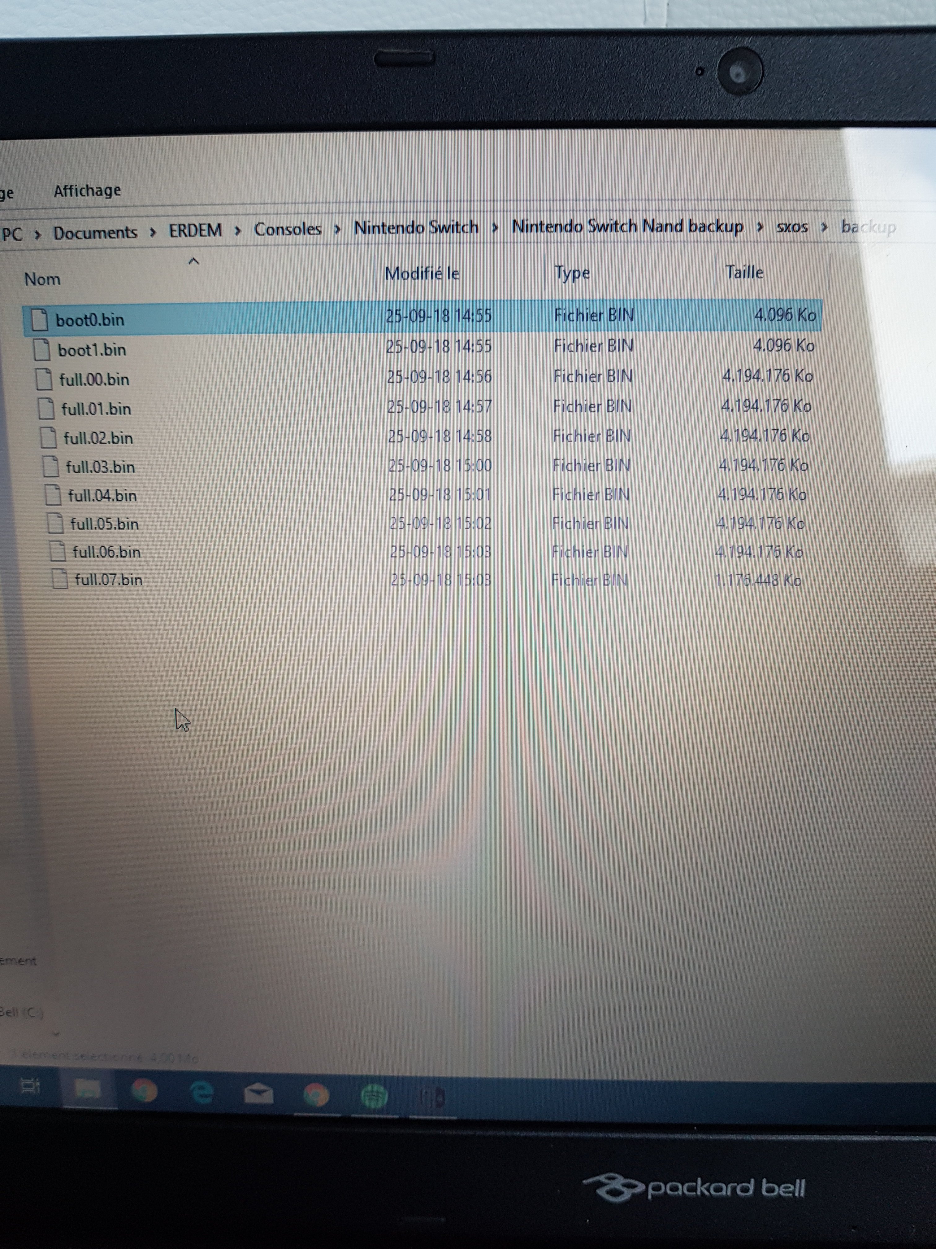

For those with backups you can still follow the method below
After seeing reports of downgrading back to 6.2 been broken after updating to switch firmware version 7.0, I can confirm these to be false. I successfully downgraded my switch with 9 burnt fuses on 7.0 to 6.2 with 9 burnt fuses
Downgrading to 6.2 is possible and not broken. Both boot0/boot1 must be the same version as nand backup
- Step 1) Place 6.2 nand + boot0/1 backup on sd card
- Step 2) Boot into RCM and launch hekate
- Step 3) Restore boot 0/1
- Step 4) Restore GPP Partitions (or rawnand, I personally used GPP Partitions)
- Step 5) Launch CFW using Hekate 4.6 or ReiNX 2.0 or sxos (haven't tested with fusee-primary)
- Step 6) ????
- Step 7) Profit
