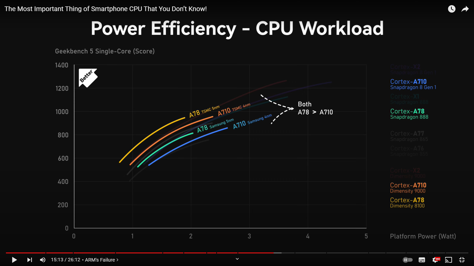

Just something to be aware of. Having a newer CPU doesn't automatically make it better. Take for the instance the Cortex A710. Newer than the A78C, and can clock much higher, but when it comes to power efficiency....... it's worse.
