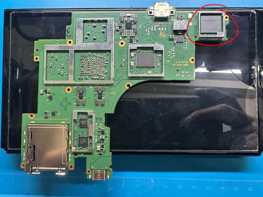

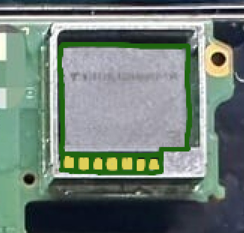

Now, starting with a similar approach as a base point for Switch 2, we know from various leaks that the Switch 2 no longer uses an eMMC - it uses UFS storage, more specifically a 256GB UFS3.1 chip from Kioxia. Model number THGJFGT1E45BAIL
While having a completely different electrical interface, this chip happens to come in the same BGA153 packaging as the eMMC from Switch 1.
We can spot the new UFS chip in the leaked pcb photos:

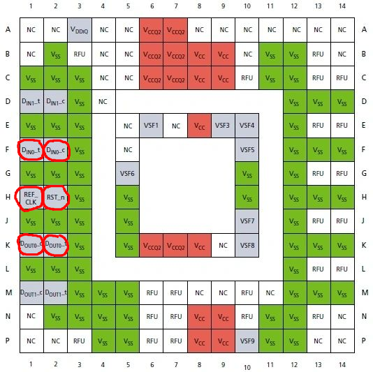

Looking at the pinout of BGA153 UFS chips, there are a few points that look like what a modchip would need to hook into:
Thoughts:
- Unlike the eMMC which uses dat0-7 for both reading and writing, UFS has separate channels for read and write, with two points for each channel. Assuming the modchip might also need to read something from the UFS, we would need to hook into Din0-t (H1), Din0-c (H2), Dout0-c (K1), Dout0-t (K2). There is also a separate "lane" to achieve higher speeds (D(in/out)1), similar to the eMMC dat1-7 points, which the modchip should not need to bother with.
- The CLK point (H1) works the same way as on the eMMC and will probably be used.
- The UFS storage is also connected to the RST line that is used to keep CPU halted on the switch 1. This line will most likely need to be severed with both sides connected to the modchip, since the modchip will need to manipulate the UFS contents while keeping the CPU halted.
Assuming Nintendo have learnt their lesson, these lines will most likely be hidden deep within the layers of the mainboard PCB without any accessible debug points. Since some of the pins the chip will need to access are not along the outer edge of the BGA153 layout, a variant of the "slide-under dat0 adapters" will not be possible either.
The best approach for interfacing will most likely be an interposer PCB, similar to the one designed for the switch 1 eMMC by @abal1000x , but with a different shape to accomodate the shape of the frame around the UFS chip, and obviously with different pins broken out. The interposer could conveniently handle the severing of RST and expose both ends of the line as points on the interposer PCB. The layout could be something like this:
