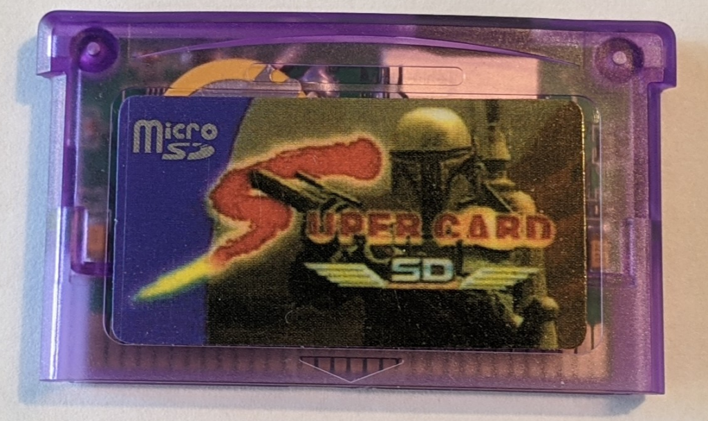

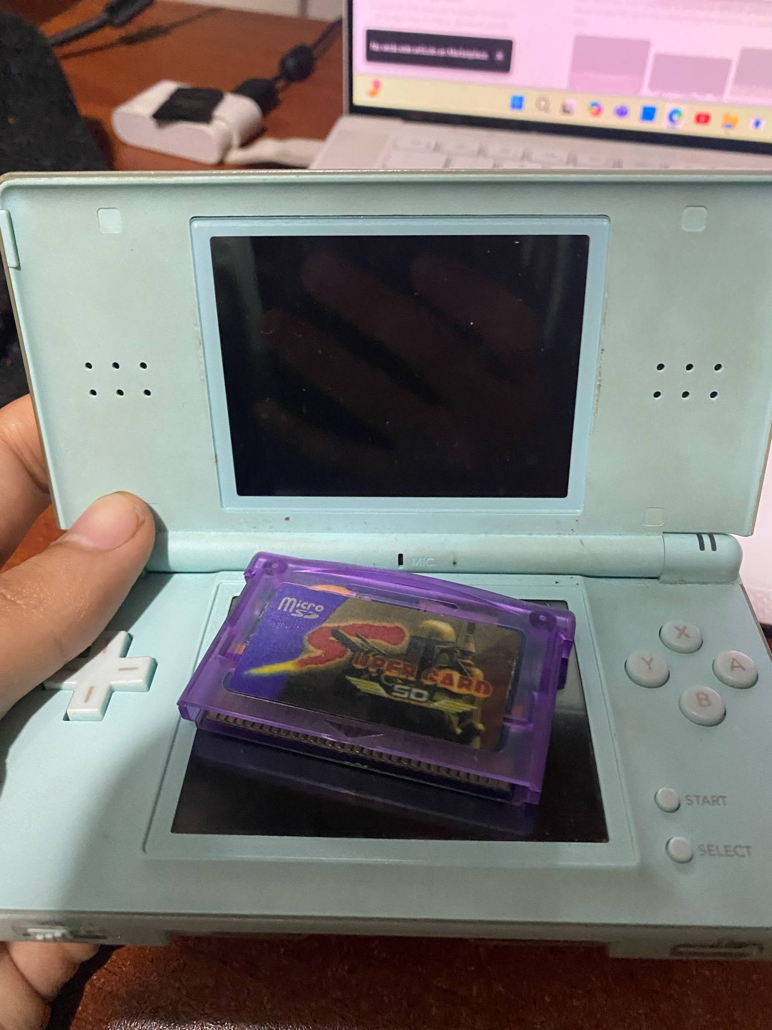

so i recently repaired my DS Lite, and someone gifted me a SuperCard for the GBA last Christmas...
But... i can´t make it work...
Once it loaded just fine Pokémon Sapphire and now... well, it kind of refuses to run anything... It Opens the Menu... loads the roms... but after it finishes loading the rom it crashes...
And its forever stuck in the White Screen until I reset
I looked for info everywhere, but none is clear on how to proceed, and the videos with attached files don´t work either
I´ve tried a lot of things... but I´m stuck with this thing for a Week, and each post I read about it
i lose a bit more hope in making it work
I've tried a lot of things... even the Custom Firmware for it (it only loaded once)
THE ONLY THING I HAVEN´T TRIED is using the R4 to mod it...
But the instructions on it are a bit unclear, so i don´t feel comfortable jumping on it without a clear view... I also saw a Reddit Post on someone using the Godmode9 in the R4 to back up the Firmware before hacking it
If anybody can give me the files they use and the programs they use... That would be amazing
Or explain how to Update the firmware or downgrade it...
Important Stuff:??...
So the Cardtridge has never been opened since it still has the Sticker in its place
When i Press the L + R Buttons, it keeps a black screen until i let them go
Does not loads patched games i tried 3 different versions of the program
same with NES
Turns on in both DS Lite and Gameboy Player
Please Help
