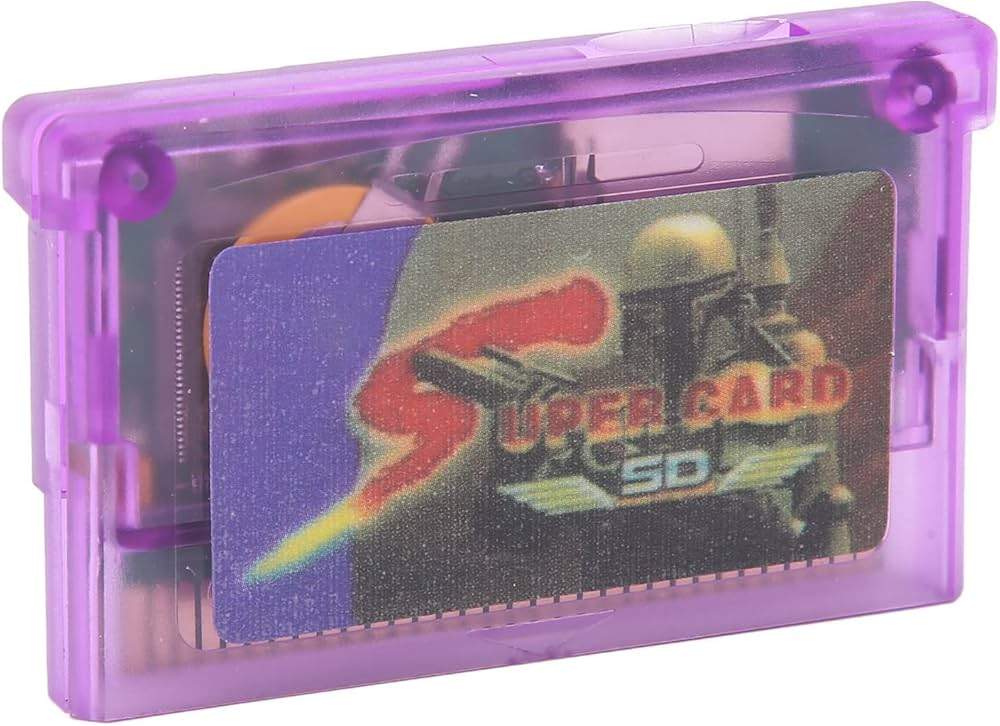

Hi everyone! I have a SUPERCARD like this one:
Pressing L+R on boot and doing the test, I get:
Test SRAM
SRAM ok!
Test sdram
sdram error:
010000020001030002040004050008
0600100700200800400900800a0100
0b02000c04000d08000e10000f2000
104000118000120000130000140000
150000160000170000180000190000
55ff80aaff8178ff829a000
Test flash
flash id ok!
flash ok!
Test SD/MMC
SD/MMC ok!
not find test file
Now SC Version: 1:85
When I try to boot any game (patched with Supercard software in order to get those 3 files for a single rom) I get blank screen after loading the rom.
I tried 3 different sd card, 1gb, 2gb and another 2gb. All of them formatted FAT16 64kb cluster
Any way to fix this?

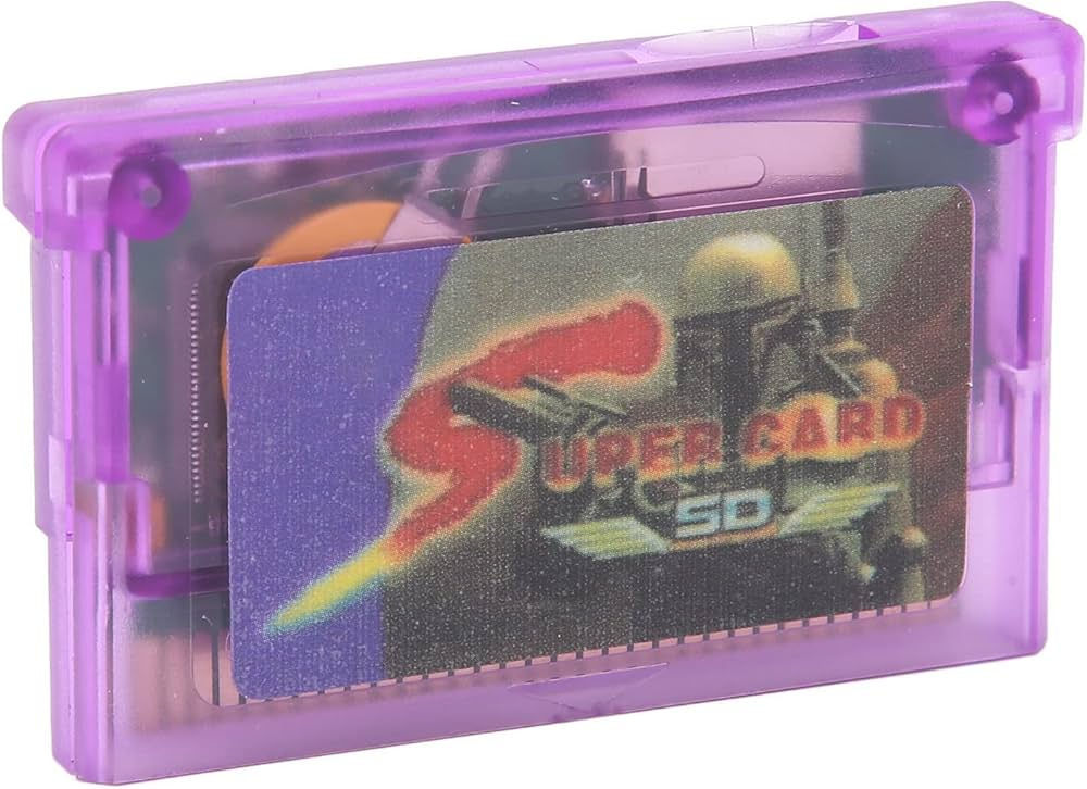

Test SRAM
SRAM ok!
Test sdram
sdram error:
Test flash
flash id ok!
flash ok!
Test SD/MMC
SD/MMC ok!
not find test file
